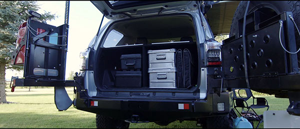

Got it. Makes sense. I've been penciling in some future plans and either the magnetic or permanent bumper mount are my options. I too am leaning towards a magnetic mount. I like the split CBI bumper they used in the Overland Central America Expedition, but I'm having a hard time justifying the weight and the expense for just a spare tire, two jerry cans, and a table. I think a rack with a rotopax mounts and a spare tire carrier would be more functional (for me). Any thoughts much appreciated. They used magnetic antennas with hand held 2 meter ham radios from High Altitude Communications. I'm not sure what CB's they used. Still in the planning stages.
