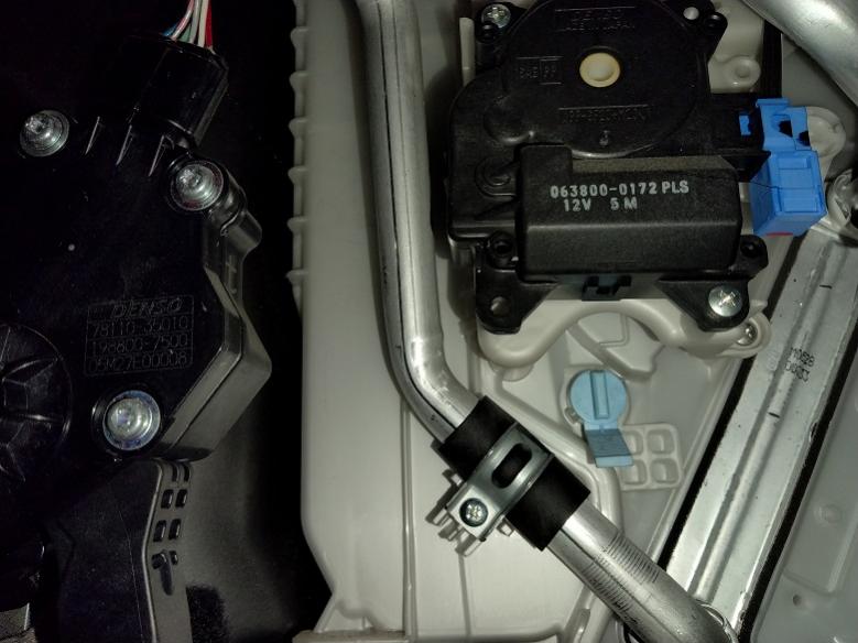

After a lot of research, I have not found any that are for a 2010 4R LTD. They stop at 2009 and then start again at 2013. When I do a search of the part #063800-0172 PLS it comes up as a corolla part?? I am trying to upload a picture of the part but I'm getting an error message (I know I'll get shredded for not having a picture :) Also, it says it may need recalibrated, but I can't find a youtube showing that process.
Here is a picture of the part

Think you want 87106-60220 if limited is dual zone
Servo Sub Assembly Damper, with dual zone ac.
It is a duel zone, but I wonder why the part number is different. I think I may take it to the dealer I go too and have them give me an estimate, that way I can get the part number from them. Also, the passenger zone is working fine, I think I only need one. Thanks for the picture, is that one you replaced on yours?
"...would be fantastic/cheaper if you could get just the D/S damper motor...!"
In case anyone is interested: Toyota makes you buy the entire servo motor assembly as a single piece for around $500. Then you have to dismantle part of the dash to install it (they wouldn't quote me a price for that :) All for a single motor on the driver's side that I can unscrew and reattach without taking anything off except the panel by the accelerator pedal. Needless to say, I'm not going that route and will look for a salvaged part to replace the one motor I need. Oh yeah, this is AFTER I had the dealership technician loom at the 4R and he said I needed to replace the entire master brake cylinder for 4k....what a shitshow.
