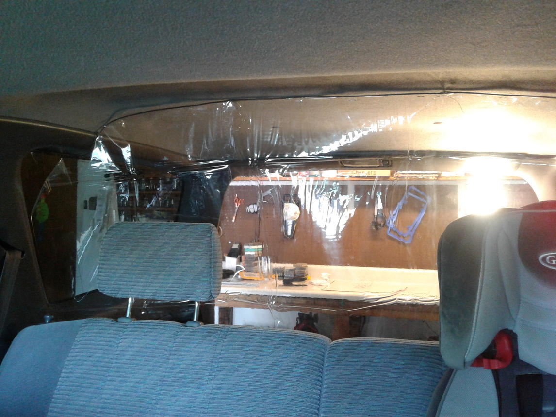

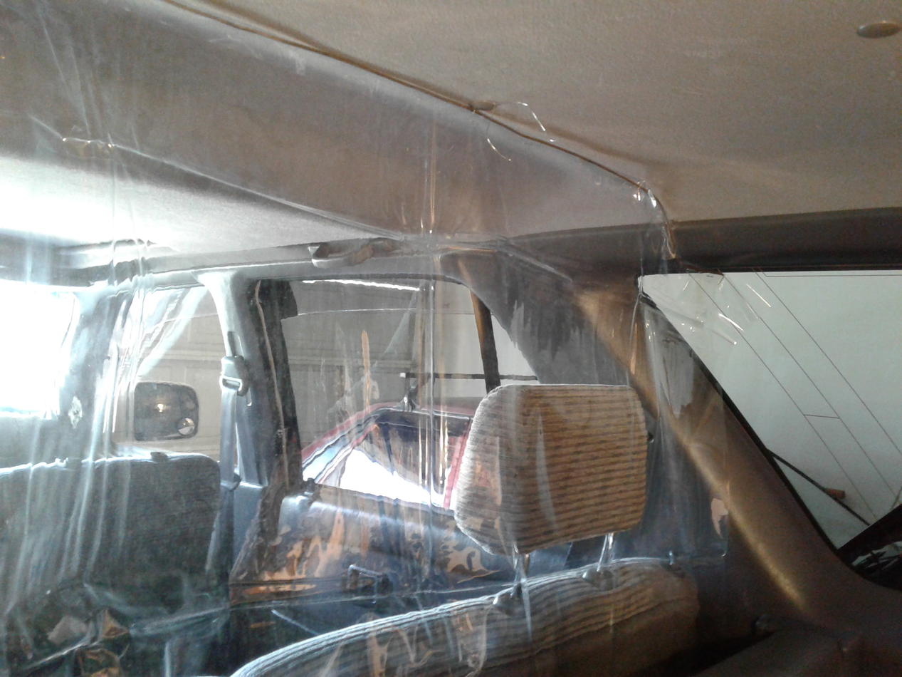

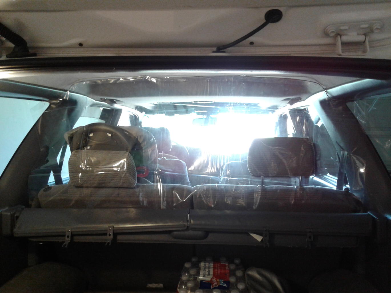

I did an improvement to cool (or heat based on the selection) the cabin area.
This is just to place a screen behind the 2nd row seats. The screen is multipurpose vinyl covering (CLEAR) from Walmart for $8. I bent the metal frame to match the contours of the roof and sides right above the rear seats.

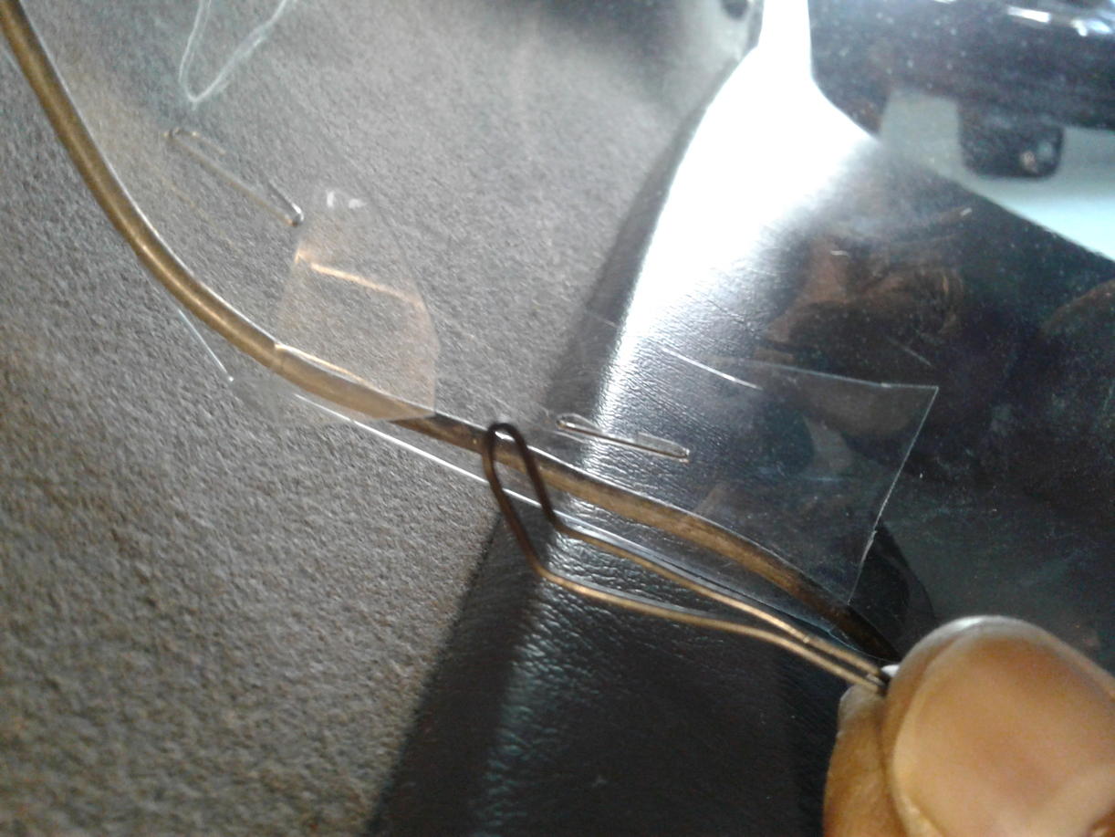

Cut the screen 24 inches tall and 54 inches wide and then placed one side around the metal frame and stapled it. Then I mounted the metal to the two tabs holding the roofliner with a narrow metal wire. Also made two special clips to keep the ends secured.
Yet to checkout the cooling but I know this should work: I see the same setup but much better made by Toyota for Hiace van.

If you like it, more power to you. But this looks... well, I do not like it.
And I don't really understand what the issue is with cooling or heating the cab of the truck.
It kind of reminds me of the people who put plastic all over their furniture. Like John's post above, I'm not too keen on this look. If your AC system is properly charged, you should have no problem cooling the entire cabin area.
