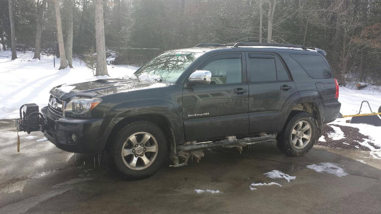

I just installed the CBI hidden front hitch. I put a winch in a cradle and just attach it when needed. I haven't done any super heavy pulls with it, but it holds up well for my needs. Sure its not as convenient as always having a winch up front at all times, but I don't use it enough to justify the cost. Plus the CBI mount was about $240 and is pretty easy to install. And its totally hidden by the license plate.

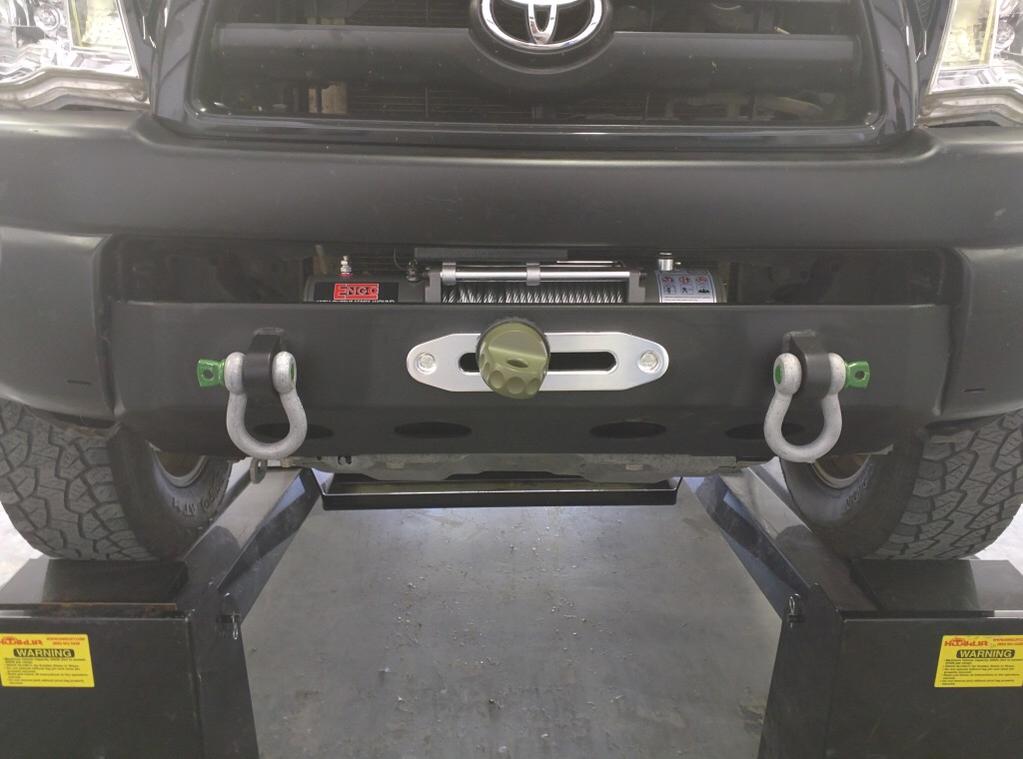

Reviving an old thread, but I saw one of these on a Taco at the auto parts store today. I thought it looked pretty clean and was wondering if there is anything like it for a 4th gen? Apparently it replaces the factor bumper that is behind the cosmetics on the front end. Would it work? Thoughts?
That's fricken sweet.
I wonder how hard it would be to convert to a 4th gen?
I'm not sure, but if the T4r bumper mounts to the frame the same way the Tacoma bumper mounts (I believe they share the same frame) I bet it could be done. I'm just not sure how much cutting would need to be done. That's, unfortunately, well above my pay grade though.
