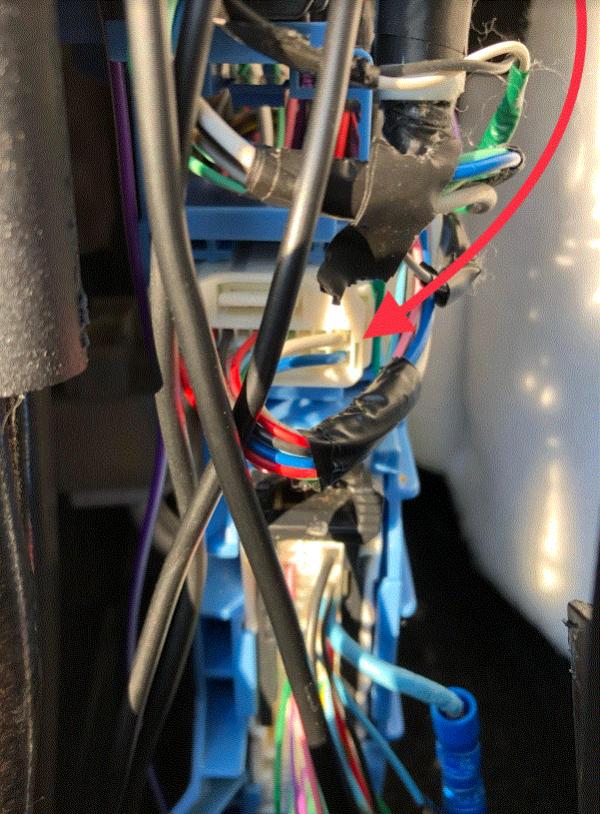

Alright gents, running into one issue with the tailgate but figured I'd turn to the genius minds of the forum... the same people who dump tens of thousands of dollars into $40k SUV's only to damage them... real geniuses here! :)
The installation instructions definitely need some sprucing up, which I plan to do once this is complete. The manufacturer is telling me to connect into the two blue and white CANbus wires. I've downloaded a wiring diagram which may only be complicating matters, but there are about 50 blue and white wires down there. This is on the drivers side lower kick panel underneath the interior fuse panel. See attached picture with the red arrow pointing to the blue and white... any clue if those are the CAN wires?
Do you have a better description on what Can wires they want?
Here are a couple options:
Divetrain canbus wires
Pin 6 at OBD2 violet
Pin 14 at OBD2 white
Can wires will always be a twisted pair.

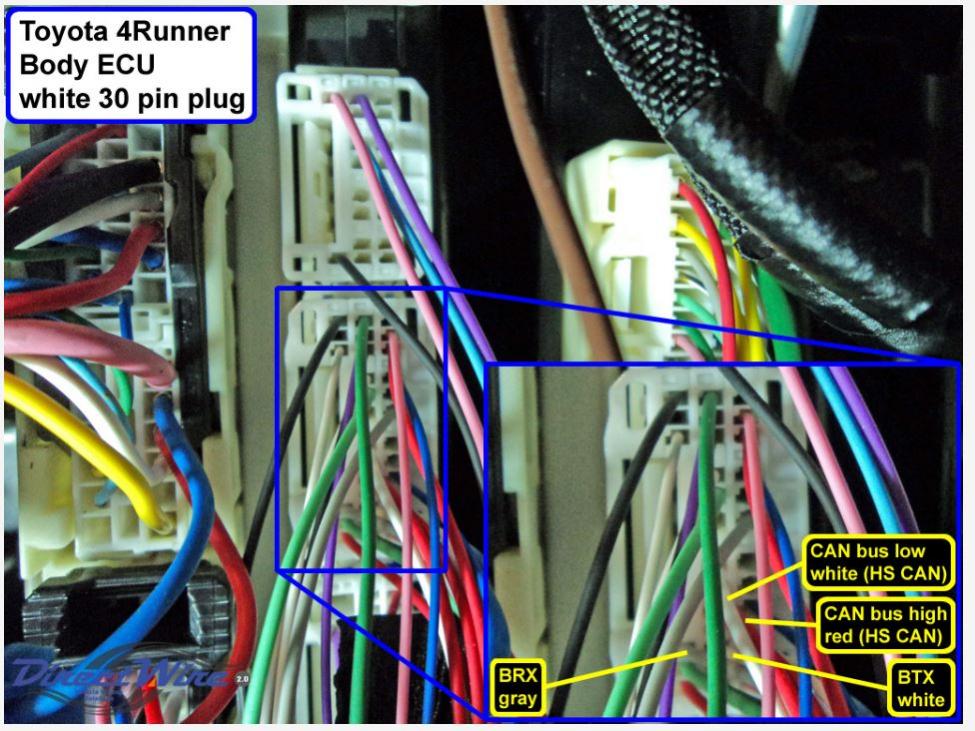

or these here:

Thanks for the quick reply. The instructions say:
Step 5. Locate original CANbus signal for remote control, you can find it inside the “A” pillar in the Left Kick Panel under the Left Driver Side dashboard. Tap our white wire to original blue, tap our yellow wire to
original white.

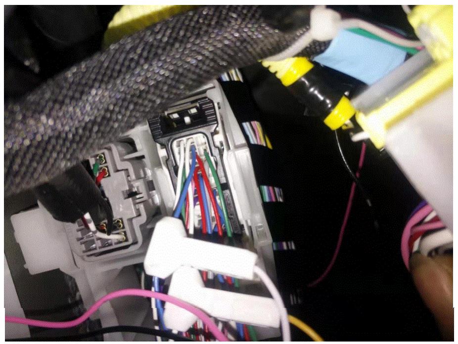

I'm not sure what they mean by "original" but I'm guessing they're trying to say "OEM". Then, this is the picture they included in the instructions which does not look like the set-up on the 4Runner.
