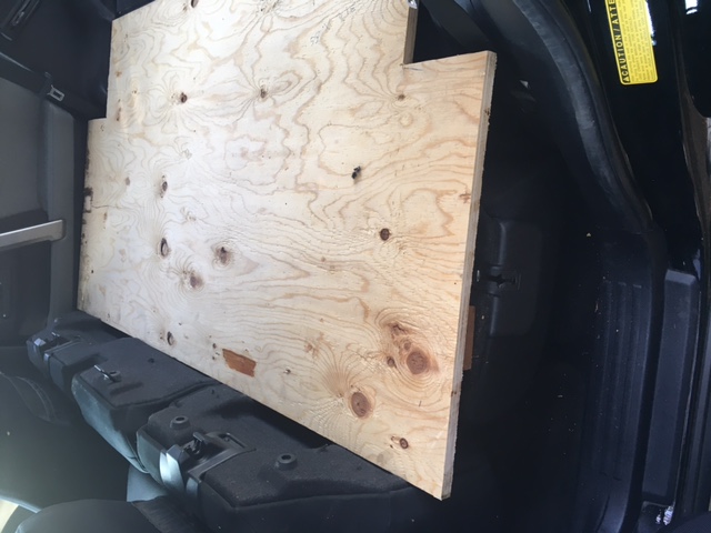

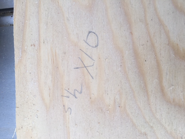

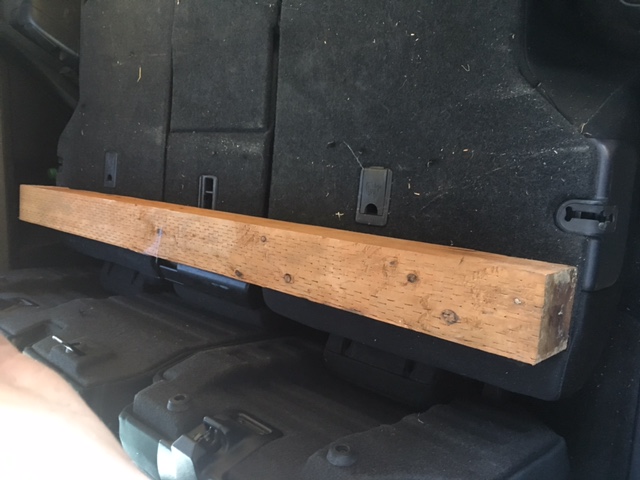

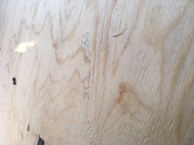

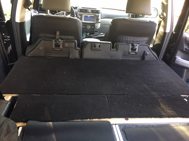

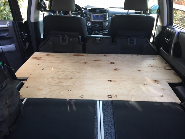

I cut the board 38” x 41.25” . I know that ArrArr cut his to 38x41, but in measuring mine it was easily 41.25” I almost cut it to 41.5” wide, but then decided to play it safe and go with only 41.25”. I used ¾” plywood, or well as close to ¾’s as I can buy these days, I believe it was actually 23/32” but the board was stamped with .6xxx thickness, so whatever, it's plenty thick enough.
Then I painted the board black…
Then installed the board, it still fits perfect, but I wasn’t happy with the look………It also sits up higher than I wanted because of the oem carpet and the foam bracing under it. For now this is as good as it gets, I just needed to do something, anything and this is where I landed. if I redo this at any point I think I will take the carpeted foam humps out so this can sit lower in the bed.
So since I didn’t like the painted look, I decided as ArrArr suggested to go with some cheap black carpet. Lowes didn’t have anything but light gray, weak charcoal or jet black, so I went with the black. I bought a 6’ x 6’ piece for $27.xx but it was easily at least 2 feet too much. I purposely bought extra since it’s been awhile since I carpeted anything. I think I could have easily spent about $9 less and just bought a 4’ x 6’ piece.
I hate corners……next time I will pay a shop to do this. But that is why I bought extra. By the time I got to the 4th corner I almost had it down pat.
Finish product installed in the bed, fits perfect. I’m glad I didn’t go with 41.5” wide cut on the board, The added width of the carpet made this just about right. Because the board sits up so high you could almost go about an inch wider and have it fill the space completely. But at the same time it’s just low enough that it would need so tapered cuts to drop in
If I had unlimited plywood and could afford several trial and error cuts, I might do it differently. This will work out fine for round one of this project.

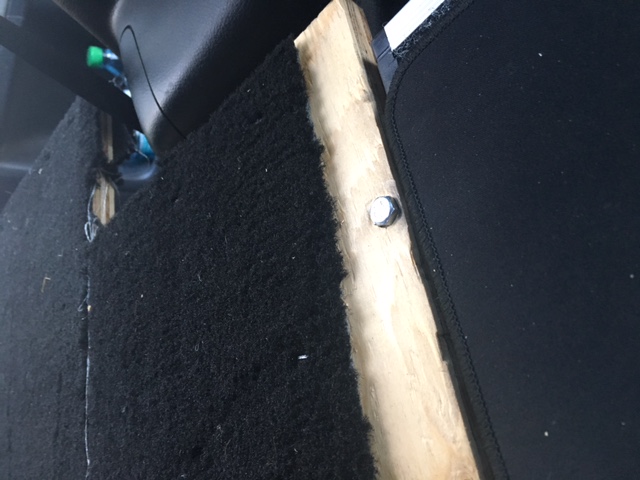

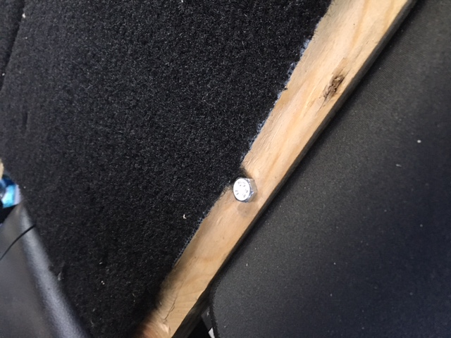

I bought some M10-1.25x100 bolts ($3.64 ea) and fix the board down by screwing down thru the factory holes that the slide out tray was attached to. I will do the same in the front with some M6 bolts, but I haven’t found any even close to long enough yet to reach down to the factory holes. Looking for M6 fine thread about 125mm long or maybe more. Lowes near me only had M6 about 20mm long. I might have to resort to Amazon to find something that will work. I will also probably install these bolts by just removing the rear seats to get in and drill the holes. Taking the whole assembly out to do this would be painful. The included ARB install/spacer kit also has some spacers that I will probably use to help keep the front leveled.
Bad picture of the M10-1.25x100 bolt and washer holding the board down. But it’s covered by the drawers, so I can’t snap a better one.
Originally I was looking for some rounded pan head style screws to fasten the board down with, but I had no luck finding them. As you can see in the next several photos the drawers completely cover up both bolts so they are hidden and it really doesn’t matter.

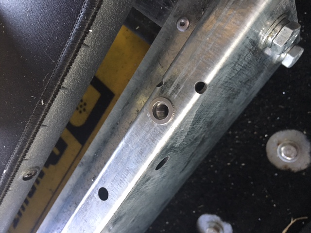

Then after following the ARB instructions for fastening the drawers together I screwed the frames down to the board.
Here’s the finished install.

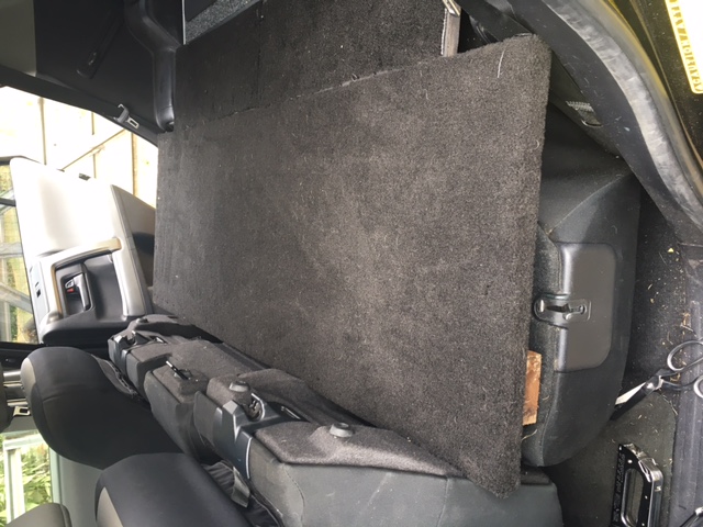

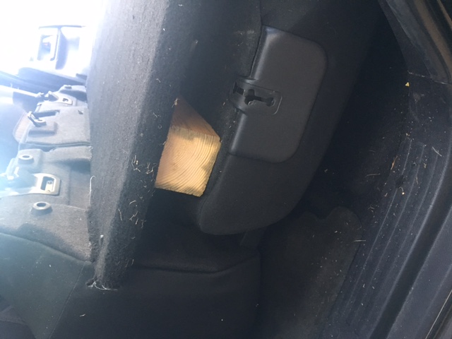

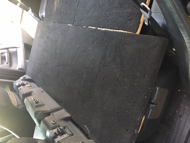

This is a couple of shots of the clearance with the rear seats folded up. Just a couple inches to spare, but it allows the rear seats to recline as normal.
Rear seat reclined all the way to the factory stops. No problem for me, but some inquiring minds might want to know this.
Here a shot of the clearance with hatch shut. Looking straight down from the open rear window. There is about 3 inches of clearance between the drawers and the hatch. Depending on where you screw down the drawer frames this can easily be adjusted forward or backward for your preference. I was getting tired and just wanted to finish this up so I just eyeballed it. I wanted the front edge of the drawer to line up with the front edge of the board/carpet. But that was just my preference. I could have run it forward about another inch before it hit the reclined rear seats.
Overall this took me about 6-7 hours, but that is mostly because I had no clue what I wanted and I had to go to Lowes to buy all the supplies once I figured out what I was going to do. If I had been prepared and didn’t stop to eat lunch I could have easily been done in half the time.

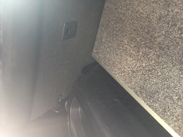

Second is shown below in the picture. It’s a small piece of plastic trim on the bottom of the drawer frame that arrived broken. It just flops around, flexing the whole time you are working with the drawers. It should have been taped down or something. I’m not really sure what its purpose is or why it’s there. I guess it’s just for looks and will eventually break off. I mounted the drawers so it hangs down in front of the board/carpet, it would just be nice if it wasn’t half broken before I got it.

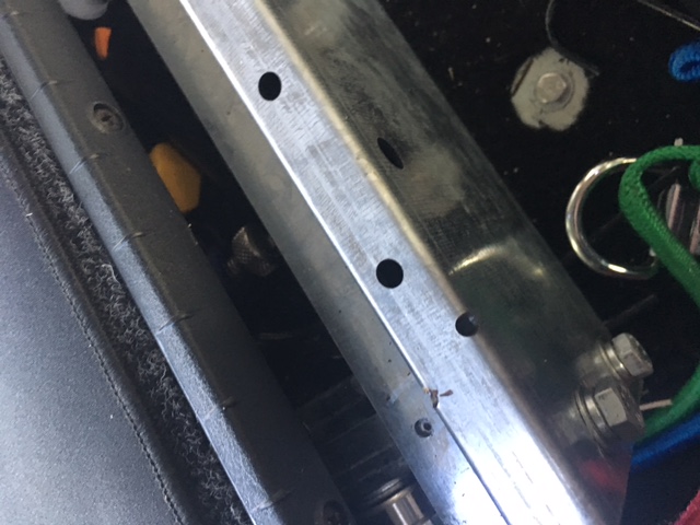

In ArrArr’s write up it appears that his drawers have these holes, but the RF945US’s don’t appear to have them. I will double check them, but if I ever take them out and off the board again, I will drill the holes myself to make disassembly and reassembly a lot easier.
That's correct. For the full-height drawers there are 2 access holes in one drawer to access the slide bolts in the other drawer and vice versa. I'm surprised yours doesn't have this, because, as you mentioned, without the access holes it would be a major PITA to access.
Ditto. The plastic trim covers 3/4 of the edge of the plywood for me, so I like it being there. I happened to read DirtRoadTrip's blog where he complained about it breaking off, so I knew to pay some attention to it. I wish it was just a simple bolt-on/click-on trim, rather than being fixed to the drawers. But, I'm glad it's there nonetheless.

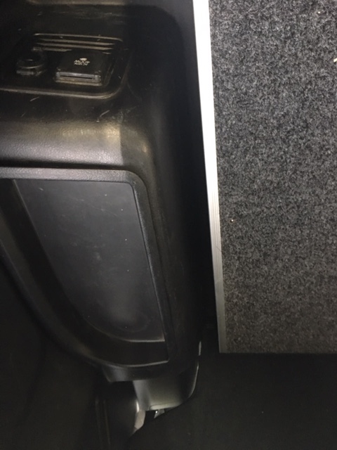

Here's a few more misc pics. I purposely mounted them as far to the left side (passenger) as possible, while still keeping them fully on the board. This left me with 2-3 inches on the right side, that I figured would be more useful than 1 inch or so on each side. I could probably gain another 1/2" on the left if I wanted to mount if partially off the board on the right side.
Hopefully the OCD won't set in and drive me nuts having it off center.:crazy:
This is what it looks like from the back fully reclined, about 1/2" clearance.

These are the bolts I ended up using to fasten the front end of the board down to the bed. M6 x 120mm Stainless Bolts
They were a bit long but still not a problem. I did end up just drilling and attaching these from the back seat area. I did not remove the rear seats, just folded them down enough to get my hands underneath and line things up. I used 3 of the round spacers from the kit under the board to help keep it level and from being pushed down. I also attached the OEM tie down D rings to the corners to give me a couple tie down points, without drilling the drawer tops. With the seats up you can't even see any of the bolts or tie downs.

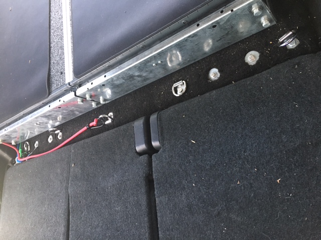

Next on my list was to improve the cargo tie down situation. Basically it sucks in the back of this rig. (until now!)

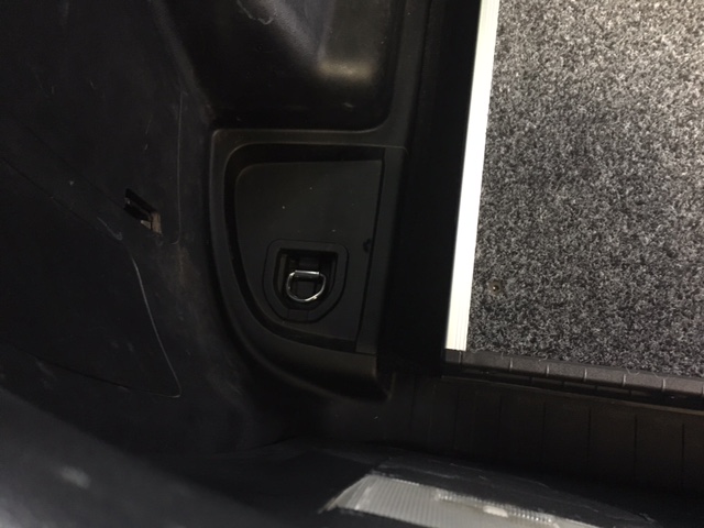

I didn't like any of the D-ring options available at Lowes so I just ordered the OEM version. These are getting mounted in 2 places.
First place is the almost useless hooks.
I took the hook off, but the footprint is so huge the new D-ring exposes a hole in the head liner, so I just ripped off the cover and mounted them both together.
I don't know about you, but these are completely useless, I've never been able to successfully tie or hook anything to them, so I decided they needed to go.
I set out to figure out how to remove them. Turns out you can just pull them straight out with almost zero effort. It was so easy I'm surprised that I hadn't pulled them loose already. Just a pair of pliers and they yanked right out.
Inside is just an M6 Phillips head screw. I wanted to use this as my mount point. It's recessed in about 3/4". It holds the trim to the inside of the body.
The OEM screw in't long enough to mount the new D-rings, so I got some about 1/2" longer. You could get longer ones if you wanted, there nothing behind there except about another inch of open space. I had these already left over from another project so I just used them.
Then I found some 5/8" diameter bushing spacers 3/"4 inch long. I wanted the bushing/spacers so that I didn't crush the plastic trim when I tightened down the new bolts and the D-ring.
I put one washer behind the D-ring and one in front and tightened them all down. Repeated the whole process on the other side of the truck and I'm good to go.
Now I've got plenty of tie down options all over the back. :zoom:

I added a couple more tie downs across the back in the gap between the drawers and the back seats. I have 5 of them across the back now, that should give me plenty of options. That's not counting the 3 on the back seats that I totally forgot about until now.
I wanted some more options on the front of the drawers, so I bought some 5/16" bolts 3/4" inch long as well as some washers and nylon lock nuts.
I Drilled some holes in the corners of the drawers and mounted the tie down using the nuts and bolts. 3/4" long bolts with a washer on each side turned out to be the perfect length for mounting. The bolts just finishes flush with the nylon lock nut on the inside of the drawers.
Now the only place that's left for tie downs is the top, but if I mount any there, I will use the screws that are holding the top to the slide. I don't really want to drill into the top. I don't see my self needing to tie anything down to the top that way, but you never know.
