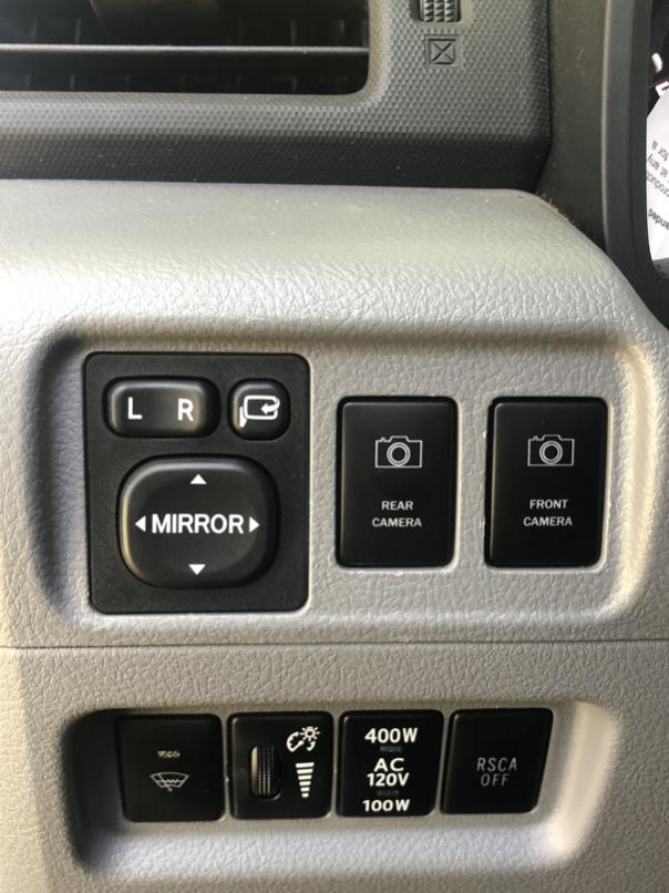

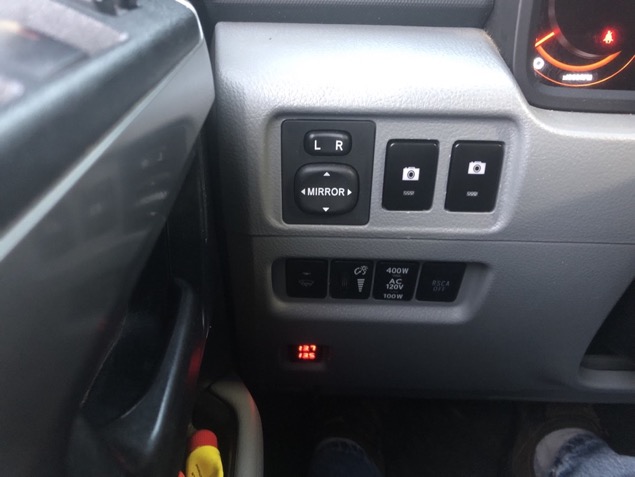

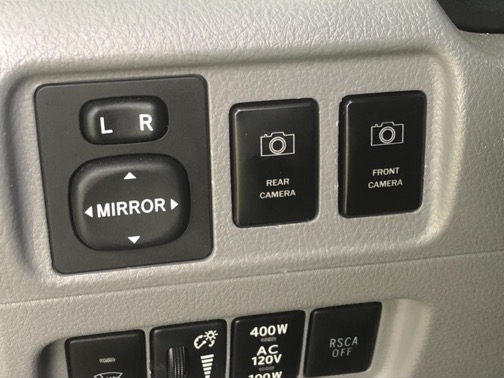

When I installed the POD system I relocated the switches for my anytime backup camera system. Works good with the cheap $10 switches from amazon, but I will probably order some custom labeled ones.
EDIT: Ha! Just noticed even though I ordered them at exactly the same time/place they don't even match! Lame
AOB switched ordered!!
EDIT 2: Look at the second pic, More appropriately labeled AOB switchs installed. Looks great now!

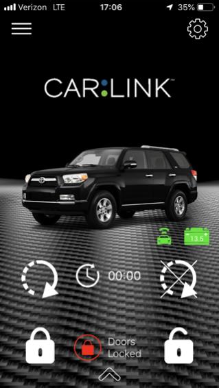

Update 7/17/19: A few notes for anyone considering this....I just installed this last week, it only took about an hour and I was dinking around with other stuff at the same time. (Moving switches) I'm loving it so far.
I went for the cell phone option. The app seems a bit clunky to me, but it has worked every time. (kind of, keep reading) It will tell you if the doors are locked or unlocked and give you a read out on the battery voltage as well. You can set a pin on the app so no one can mess with the car if you leave your phone someplace. The app could use a few other small improvements, like letting you upload a pic of your own car instead of having to choose something close. (No '11 TE option, at least they got the headlights right, I'm stuck with SR5 or Limited pic :barf:)
It would also be nice if you could adjust the pre-run time from the app, but that currently requires you to send the module back to Accessorides.
My last peeve about the app is the start and shutoff buttons don't say start or shut off. They just have some circular icon arrows that have never been associated with start or stop. It wouldn't kill them to even add the text below them and I could get over it. The lock/unlocked symbols and text are as you would expect...why not the start stop?
The app also hints that you can add 4 switched accessories...like lights etc. However, there is nothing on the Accessorides website for this. Imagine forgetting where you parked and being able to turn on the LED light bar remotely.....can you say airport parking lot after a two week trip? or even a nice security feature for people that have to park in sketchy areas.
One small thing I noticed was when I parked in a home garage for 2 days the cell service was pretty limited if it reads at all. It's 4G service supposedly, however the area I was in didn't have the greatest coverage to begin with. So it could have just been a combination of the house I was at and the area. I was close enough to my T4R that the OEM fob worked fine so in that instance I did't really need the app.

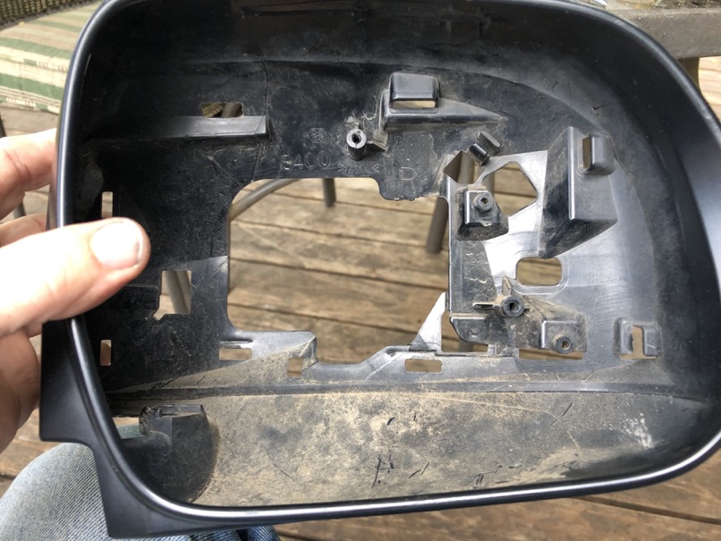

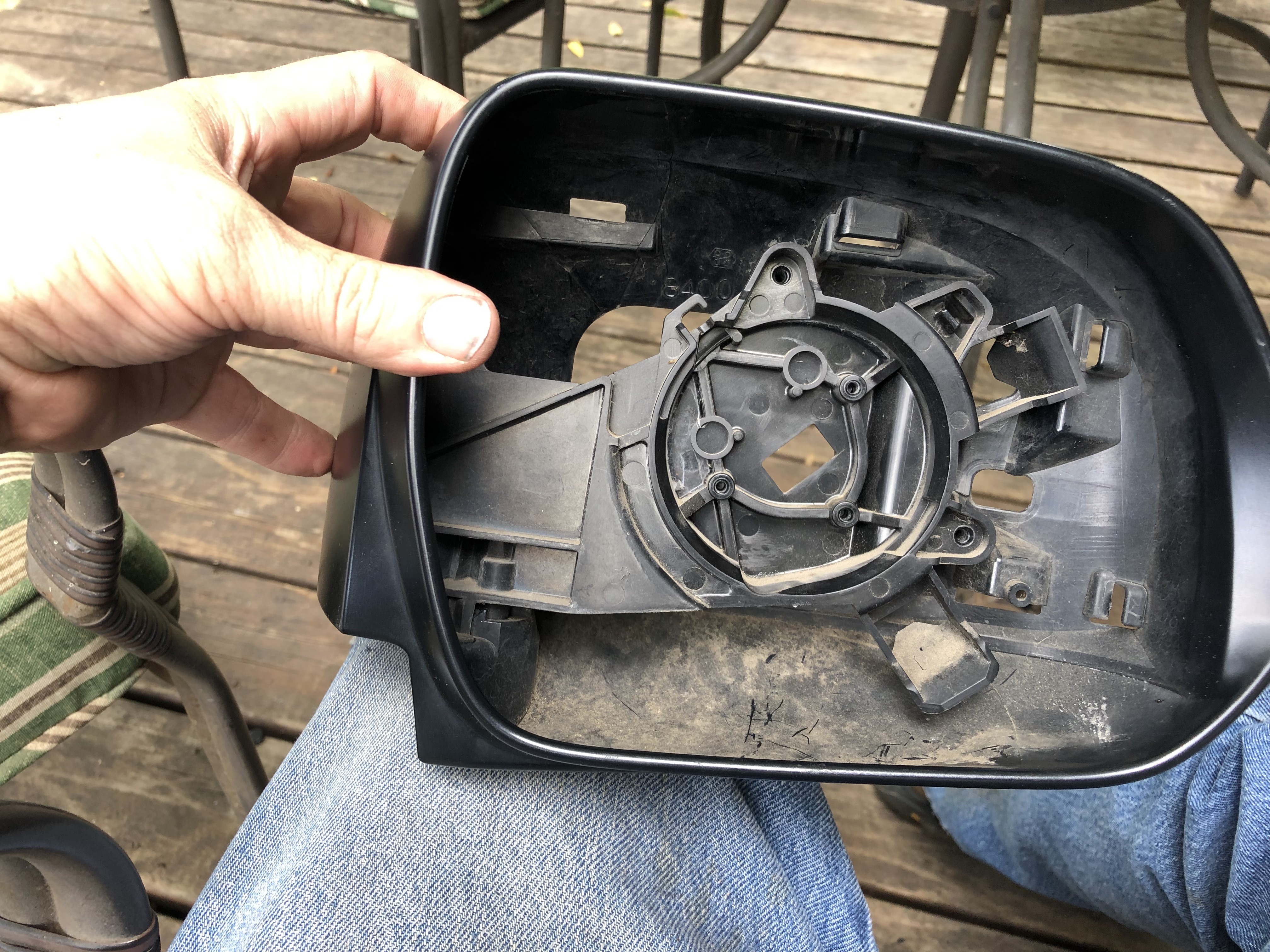

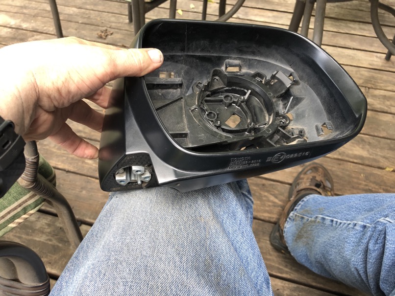

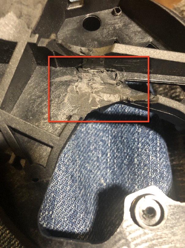

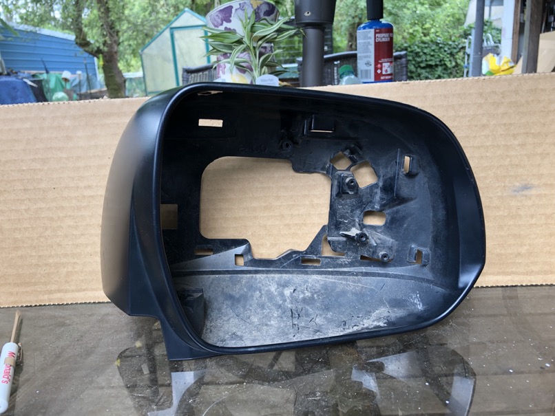

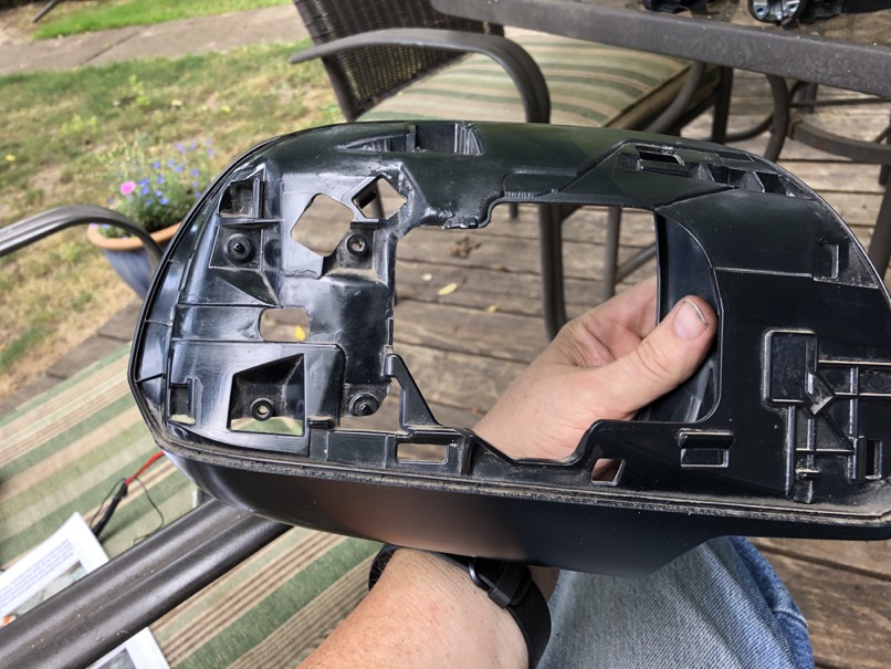

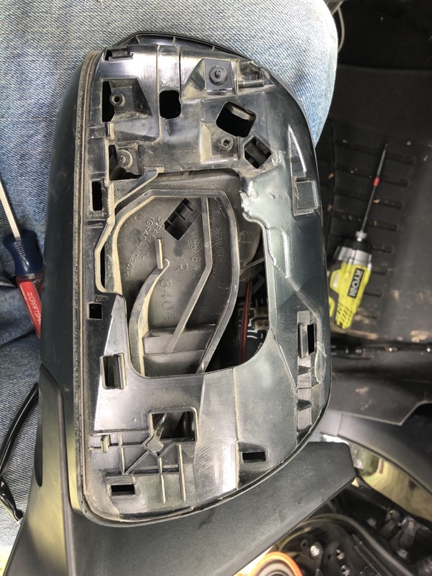

Here's some pics of my 2011 mirrors as I took them apart. Notice how "square" the outer frame is, and the shape the mirror glass has to be to fit the square area

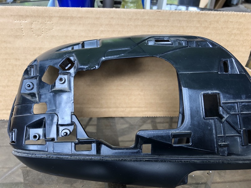

Here is a pic of the 2014+ mirror shape from the back side. It tapers down the farther you get from the window.

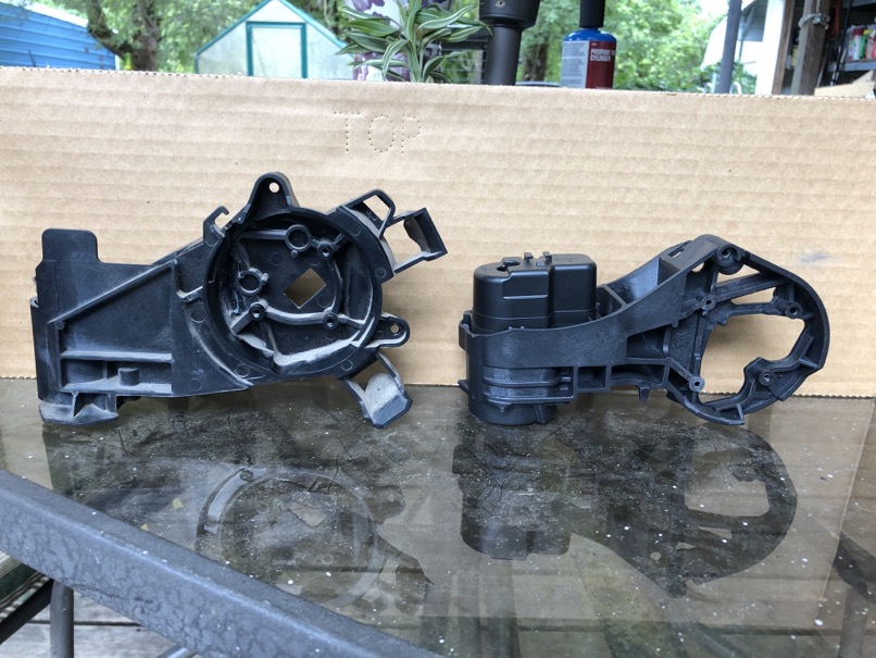

This becomes important as you see the shot of the 2011 connection plate vs the replacement connection plate in the kit.

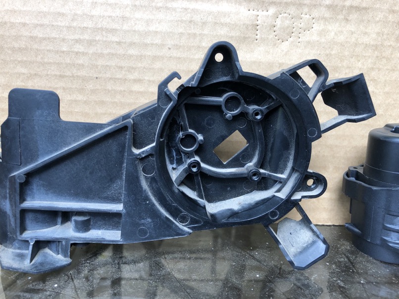

First the 2011 Connection Plate
Now the Connection Plate in the kit w/ the motor installed
Now the 2 side by side
The 2011 version sort of curves up to get the squarish mirror glass centered, while the 2014+ sort of curves DOWN to center the mirror glass in the tapered housing.
NOT GOOD. The geometry of the 11 vs 14+ mirrors is way different.
I started with trying to mod my original 2011 mirrors, that was a definite fail/no-go. The kit from KTJO4x4 isn't even close to a match for the 2010-2013 mirrors style.

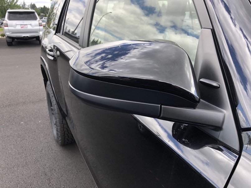

Then I noticed in Antman's thread all the pictures he posted of the original modded mirrors. Antman owned a 2011 T4R, but the mirrors in the pics are not 2011 mirrors.
If you look close you'll notice they are the 2014+ style mirrors with the taper. Not only did he add teh folding mod, he upgraded to the new style all at the same time without really mentioning it.
Once I realized that, it was easy.

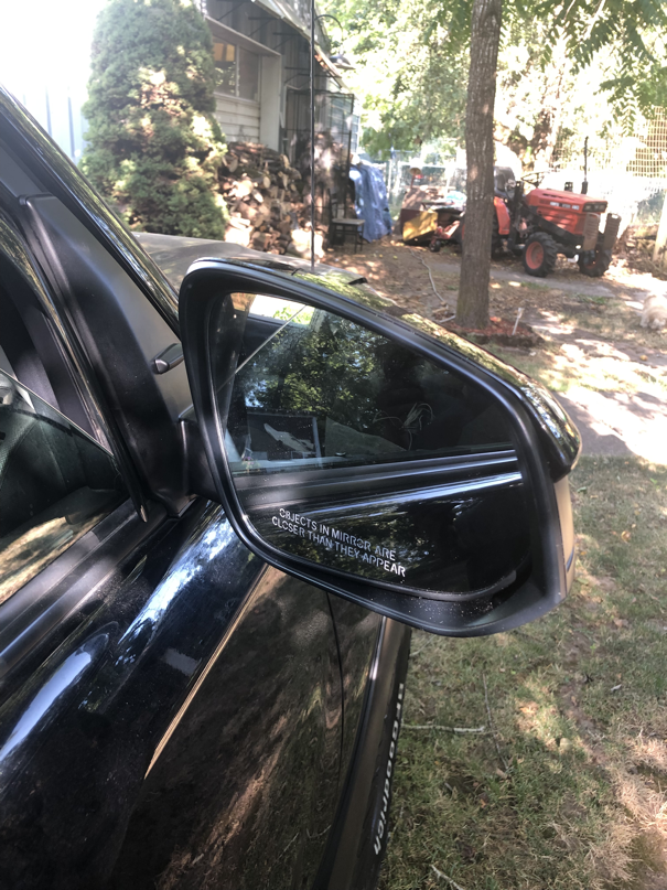

Then I installed KTJO4x4's folding mirrors kit in the new mirrors and swapped them for my 2011 style. (more on this in the next part)
The 2019 style mount perfectly (the door trim is identical) and now I have the "new look" tapered mirrors.
Buying new mirrors wasn't something I was crazy about, but I figured if I wanted the folding style, I needed to upgrade. I didn't even bother to look at wrecking yards or other online used parts places, I was just impatient after waiting over a month+ to get this done. Once I had all the parts it took less than a day to install and swap everything out.
If you already have 2014+ style mirrors all you need is the kit from KTJO4x4 and you're good to go.

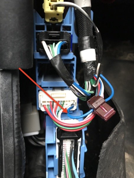

Fixed!:Note: Currently the fold on lock and unfold on unlock feature DOES NOT WORK (yes, it's wired as instructed)
I'm trying to figure out why, but I may scrap this "feature" by just disconnecting the 2 wires to that module that supposedly controls this.
Edit: 8/10/19 - We think this maybe a bad control module. We are in the process of swapping it for a new one. Stay tuned.
Edit #2: 8/14/19 - This is now fixed! I don't believe it was a bad module. Replacing the module didn't solve the issue.
My OCD and retracing the steps to wiring the mirrors solved the issue (I had the motor wires flipped)

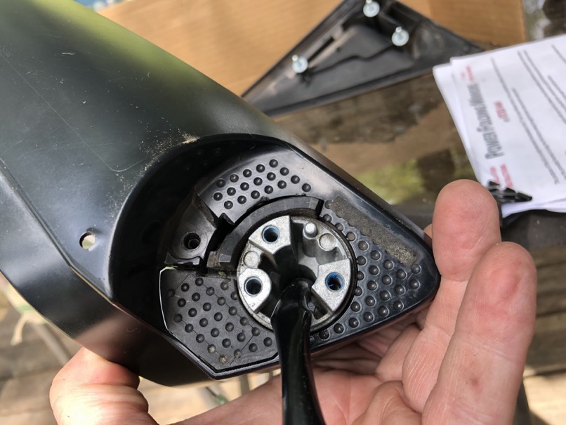

The instructions for disassembling, then modifying the mirrors and connection plates are pretty good, but just didn't quite show the full detail steps needed.
IF you're doing this mod, make sure you look at everything posted in this thread and the other threads I've listed.
Then make your own best choices on what to do. I pretty much made it up as I went along using the instructions as a vague guide.
I referred to the pictures in all the threads I listed earlier especially the one showing the "new connection plate mount point" by shaving the new spot to drill a hole and attach the motor.

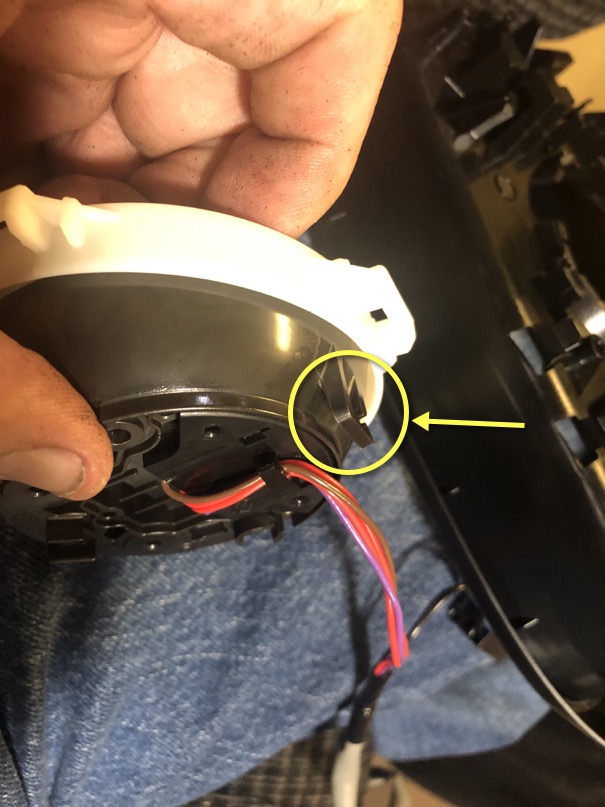

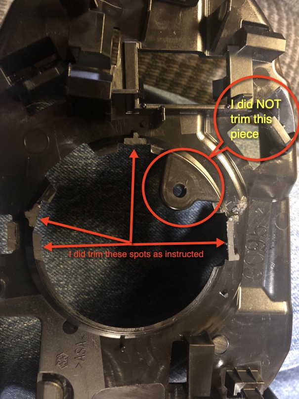

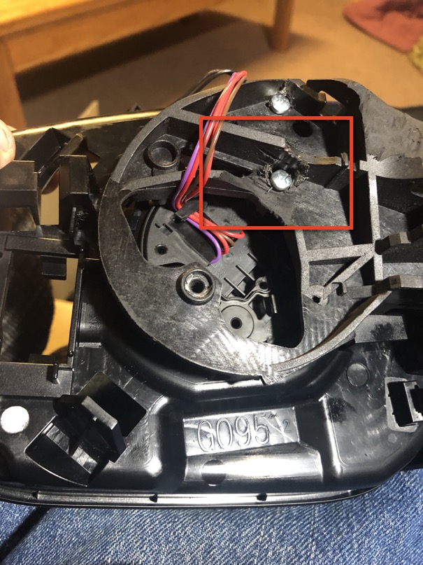

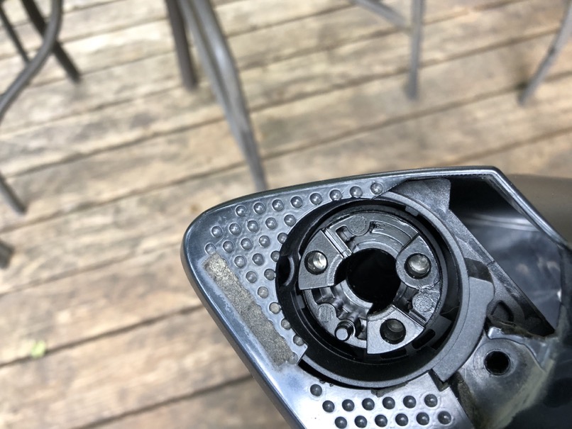

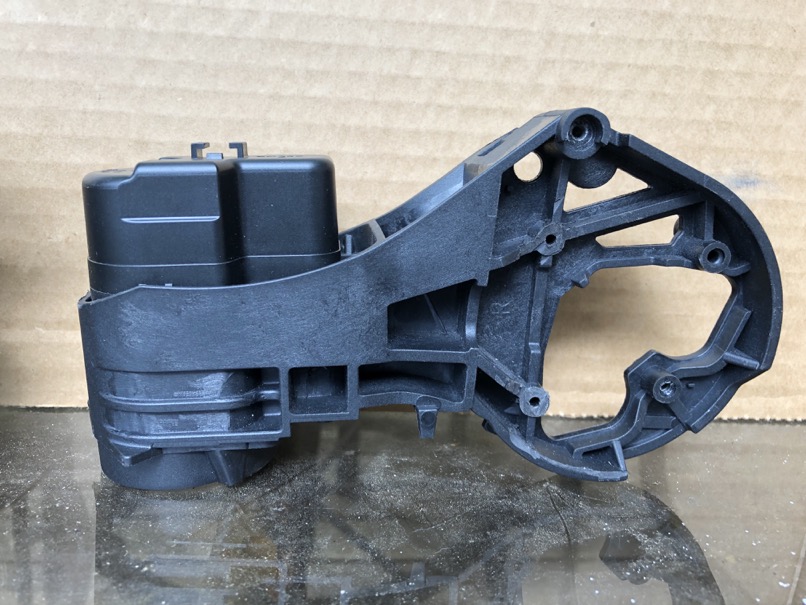

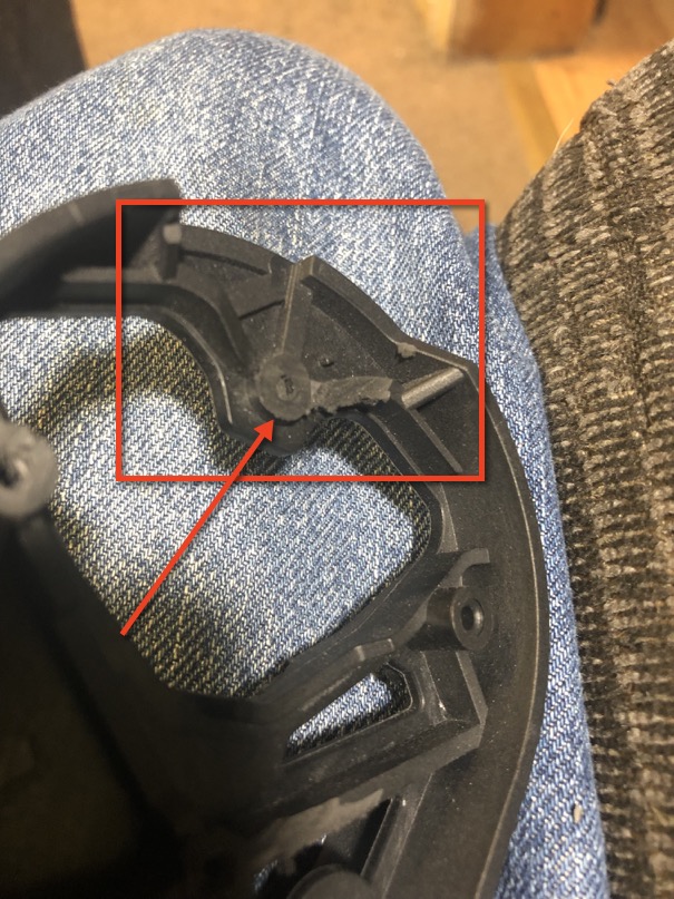

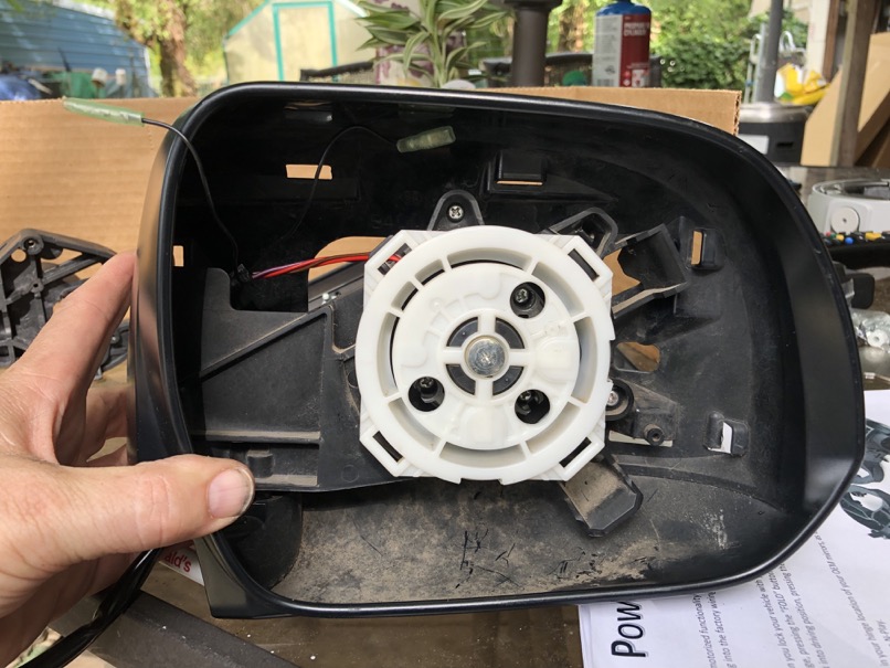

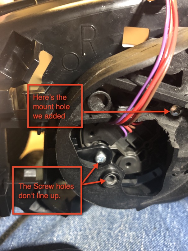

I was less destructive to the OEM mirrors than the instructions showed. I left the one hole for mounting the oem mirror motor.
On the oem mirror motor I also left the little hook for the wires. But I do not actually use it for the wires. There is just no reason to cut it off.
Leaving those 2 things helps orient the parts in the original position.

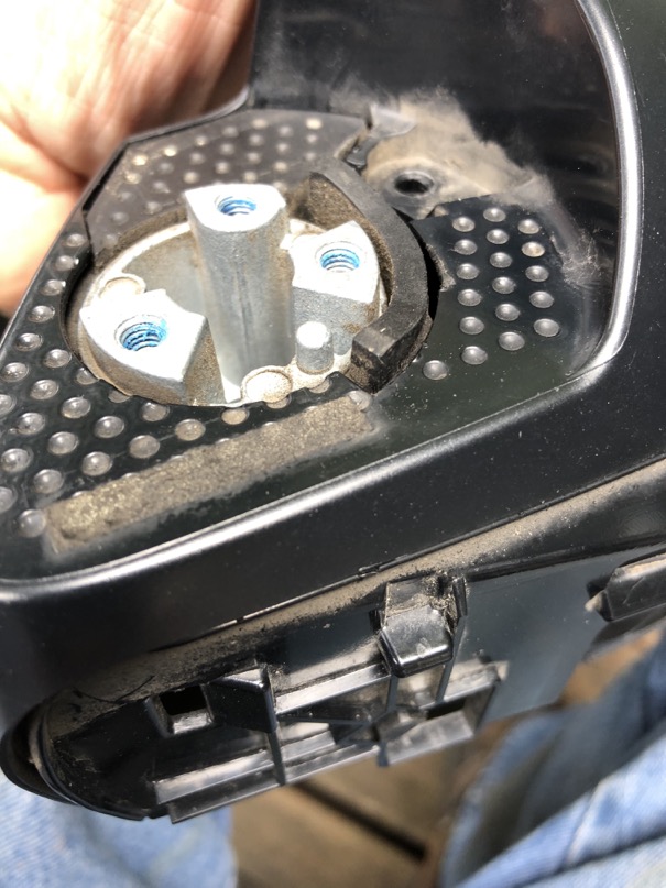

I also did not shave the 3 nubs off the back of the mirror glass because with everything in the exact original place there was no need to.
I was also less destructive to the new motorized connection plates by not cutting out the section mentioned for the turn signals (I don't have them in my mirrors.)
I did have to shave off a few nubs on the connection plates to get a better fit.

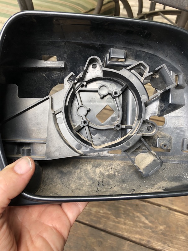

Leaving the original actuator motor tab and drilling the one extra mount point allowed me to use 2 of the original 3 actuator motor mount screws and keep the motor in the exact original location.
No chance of it being off center or out of wack now.
If I had followed the included instructions, it seems like I was only using 1 mount point and it was going to be off center so I did what I felt best for my mirrors, my mod.

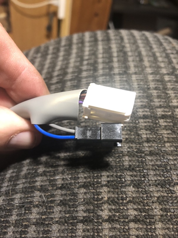

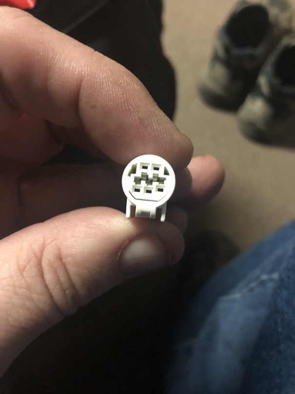

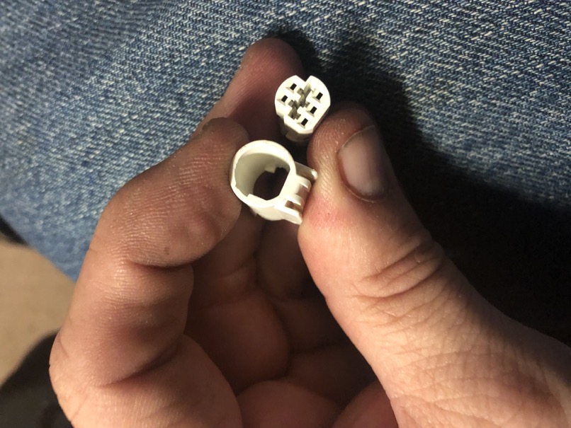

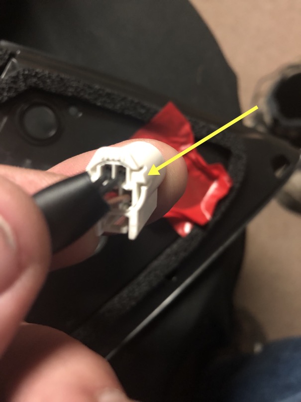

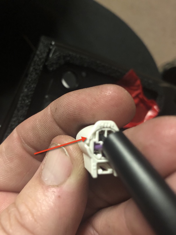

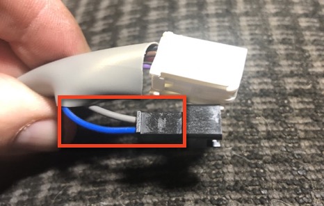

I also took a few pics of my electrical connector since it's different than the ones in the instructions.
It has a couple of little tabs that you have to release to slide it apart so you can thread it through the various holes in the mirror, etc.
Here's the added wires to control the folding motors

Power-Folding Mirror Install - Misc Pics
Here's a few after install pics. Color match is just fine.

The instructions for disassembling, then modifying the mirrors and connection plates are pretty good, but just didn't quite show the full steps needed.

I tried to follow the pictures the best I could. This part was a little hard to see in the instructions. Are these the blue & gray wires you are referring to?
These are attached directly to the motor. I had to snap these into that little black connector after I threaded them through with the OEM wires.
I will swap them when I get a chance.
Yes. Those are them :) I made it so that the colored wires go together: Blue matches up with Red/Green and then Grey matches up with Black. If that doesn’t work for you please let me know.
Neal, how did you connect the white wire to the blue (locking) in step 8? Did you just cut the blue a couple of inches back from the connector and splice all three wires together?
I attached a pic, but this is not my permanent plan. This was only for initial testing. It works great, but not always the best tap.
So this feature of fold/unfold on lock/unlock does work for me. But it's not the taps fault. I have a good connection and can trace 12v all the way to the module. It just doesn't work for some reason (still working on it)
If I can get the feature work, I will carefully strip back the blue wire insulation and solder the white wire directly to it for a permanent tap.
If I can't get the feature to work, I will just pull it off all together and put some blue tape back over the spot the insulation was cut.
The plug and play adapter would have been the best choice, but it was not available for us. :Cry:
