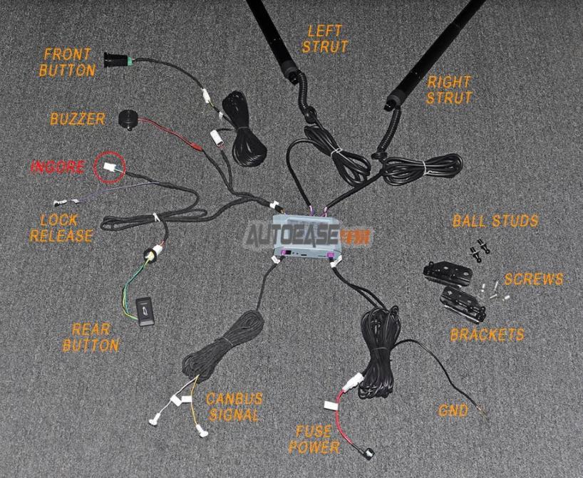

[MENTION=147513]gibburnz[/MENTION] Here's one for you, I was laying out the wiring and connecting everything to make sure I understood the layout.
I can't figure out where the white male connector that's on the lock wire goes. The connector right next to the purple wire tap that goes to the rear control box. Picture below.
If memory serves me correctly, you ignore that connector. I found this picture in my e-mails. I haven't installed the foot sensor yet, so I wonder if it has something to do with that, but I believe one of the connections on the control box is for the foot sensor.
That's what is looks like to me, a dead connector but why it is included is beyond me.
The connection point for the foot sensor is on the control box next to the lock assembly connector.
Yeah, weird they included it but I believe the control box is a newer model, so that wiring bundle could be from the previous control box. Also, I think a lot of those parts are universal for other makes and models, so it could tap into another harness on another vehicle but for the 4R, it's not used. #ShoulderShrug
