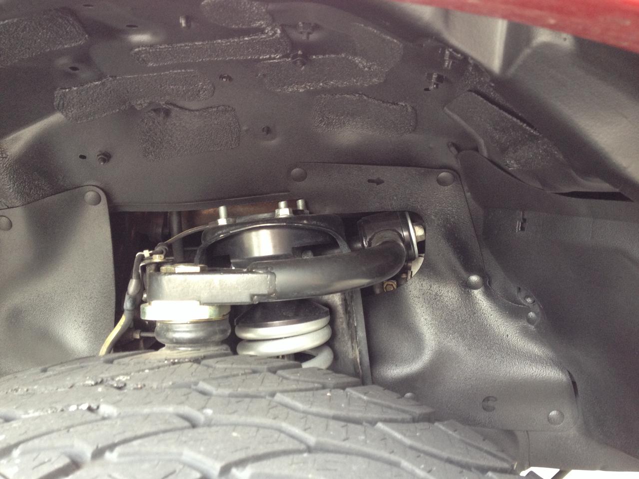

Have you thought about using aftermarket upper control arms. I have the light racing or SPC ones that Toytec sell. My 285's with factory wheels do not rub the uca's. I am also not using wheel spacers.

So I run 1.25" Spidertrax on my 4Runner with 285/70/17 Duratracs on the Tundra 17" wheel.
When I upgraded to the Light Racing UCA (This is the cheapest you can get them new... 05-current toyota tacoma front suspension - HeadStrong Off-Road) I was stoked to be able to take off the spacers and make some money back. HOWEVER the space between my UCA and Tire is still VERY close to 1.25", and I don't want to risk rubbing... Ever.
