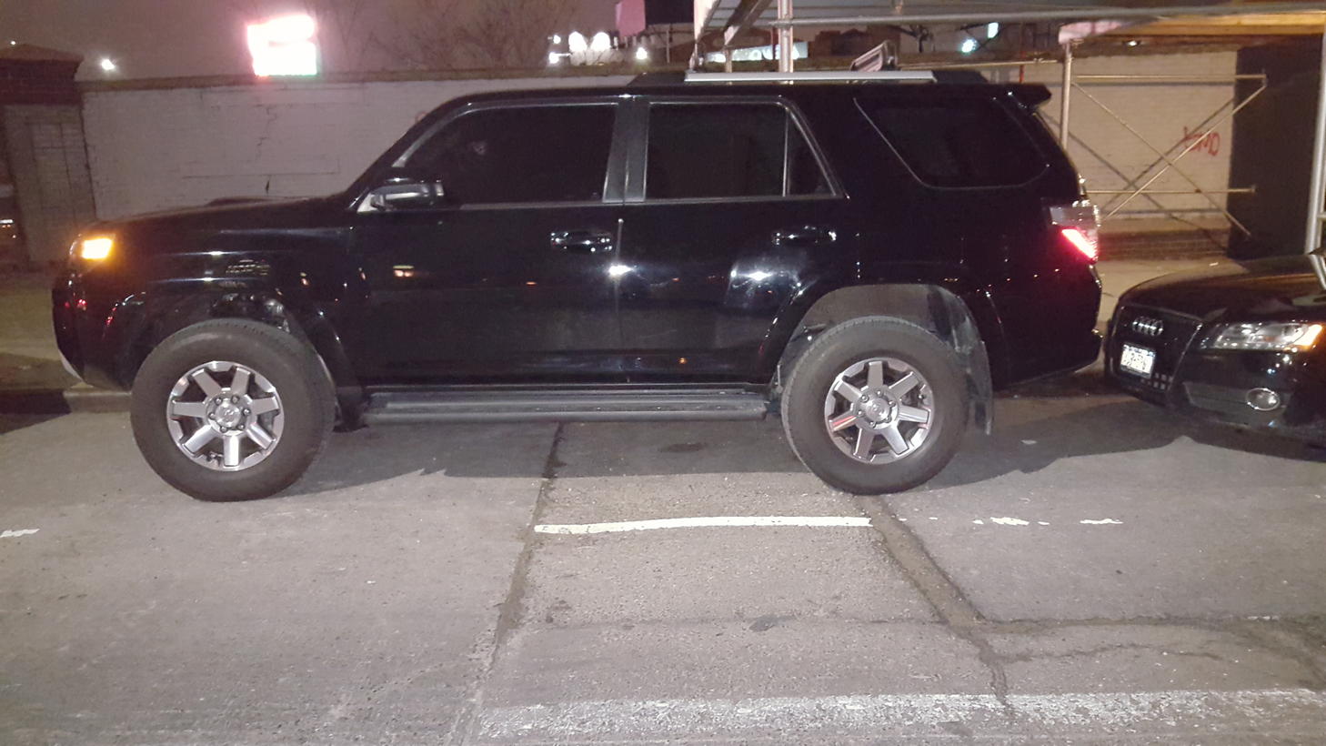

2014 TR4 Trail / Billstein 5100 .85 front, stock rear
just installed 5100s front and rear, wanted to level my truck with the least amount of lift. Rides much better, stiffer, no front end bounce like I had with the stock shocks.
What levels?
Sent from my Nexus 6P using Tapatalk
Front is .85 and the rear is stock (you can't adjust the rear billstein 5100 shocks like you can the front ones). To lift the rear you'll need spacers, I didn't want to add spacers.
Got new wheels 265/70 and I will post more pictures when I install the wheels.
