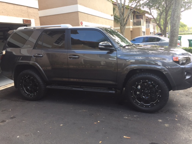

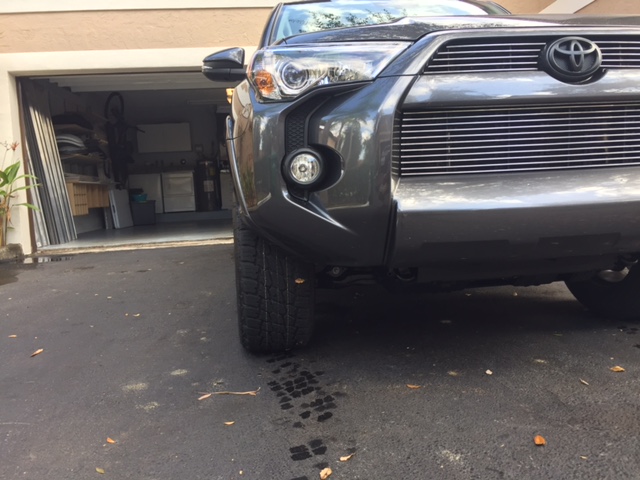

Ok guys, I been reading through this thread and wanted to ask questions and get some thoughts. If I am reading correctly I want to get 2 sets of blistins set the front to 1.75 and get cornfed spacers 1 inch for the rear? Should be these products.
https://bilsteinlifts.com/shop/toyota-fj-cruiser/toyota-fj-cruiser-2010-2011-2012-2013/complete-lift-kits/bilstein-height-adjustable-front-and-matching-5100-rear-shocks-for-2010-2015-4runner-fj/
And here are the cornfeds at the bottom
10-16* Toyota 4Runner Cornfed Suspension Lift kits
What are your thoughts on how that will look with my XP?

My fronts are 1.75" & my rear has a 2" lift and my short wife (approx 5ft 4" is able to get our 2mo old in and out with the car seat and everything. If I didn't have NFAB side steps she would probably have a very tough time though.
Your ride looks great. Those NFAB side steps look amazing and glad to hear they are functional. Congrats on the 2 mo old!
I haven't put the lift on yet, its sitting in the garage, and my 5'3" wife is still barely able to put out 16 month old in the car seat! Big congrats!!
Haha that sounds exactly what my wife is going to be like. Thank you!
