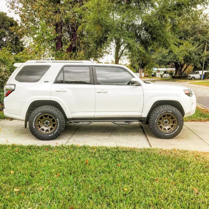

Installed 5100's today with method roost and 275/70/17 ko2's front is at 1.75 rear is stock.

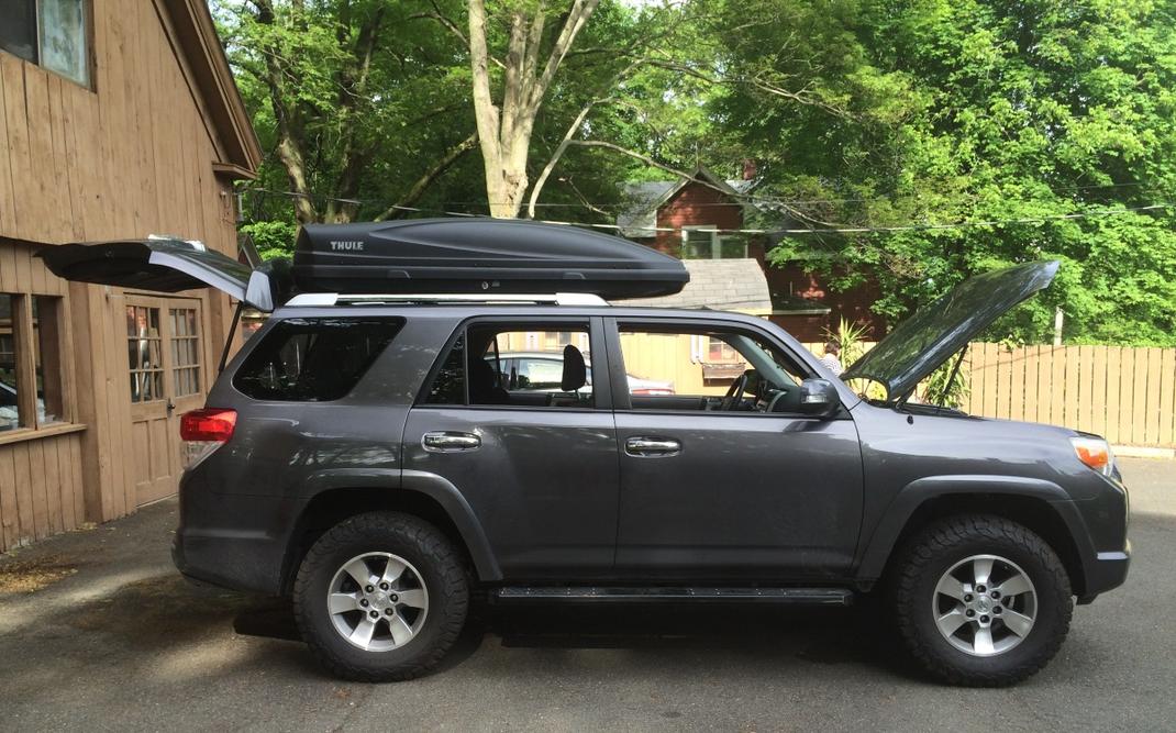

'10 SR5, 5100 at '85" in the front, stock rear. KO2 265 all around. Essentially stock.
My problem is that the rear is, dare I say, a bit too low, too leveled?
I often run with with kids (3rd row) or stuff in the back. That loads the rear end even more. The way I see it, I have two options:
1. Lower the front to OEM spec.
2. Modify the rear. But how?
I assume that a spacer in the rear will work, but which spacer to I get with the '85" setting? I don't mind slight forward lean. I think 1" is as small as they come?
Should I consider other options? A different spring? A different shock?
I don't want the vehicle any higher than it is now.
Additionally, I noticed that with a "leveled" vehicle, the nearby visibility isn't as good, especially to the right front/side. Anyone else noticed that? Perhaps that's another reason why OEM leans forward a bit?

Opps. But let the air out when unloaded or the ride will be a bit harsh.

This is 5100s all around (2.5" front) and Daystar 1.5" rear. I can't see why 1.75" and 1.5" would cause a problem. You will be "ass high" as you say.

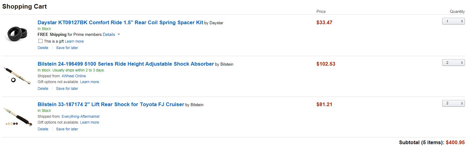

Can anyone verify my shopping list, look correct? Thanks!
This is what I ordered today minus the Daystar Spacers. I can confirm the rears are in-stock and shipped the same day!
