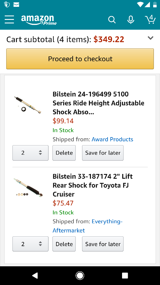

Thanks. I will for sure post pics with the progress. I should be getting the wheels and tires next week or so. I might as well order the 5100s now since those are for sure goin in :thumb:

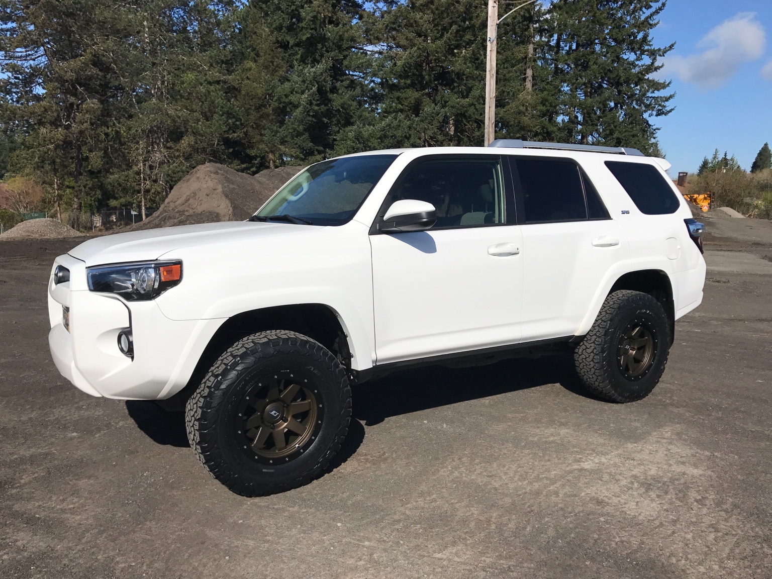

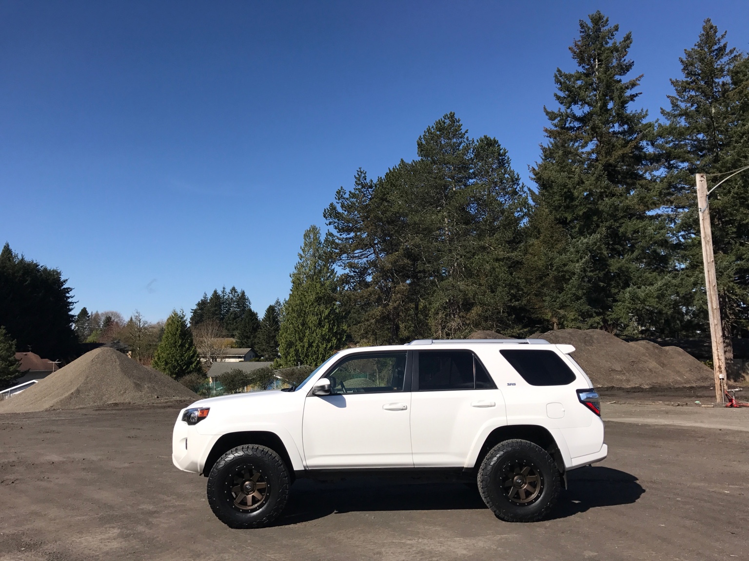

Bilsteins are in 5100's are in. Front at 1.75", stock out back. Perfect.

5100's on all 4 corners. Ride is great ! haven't hauled with it yet as we just picked it up today. Had it done while we were in Alaska visiting family. no 3rd row

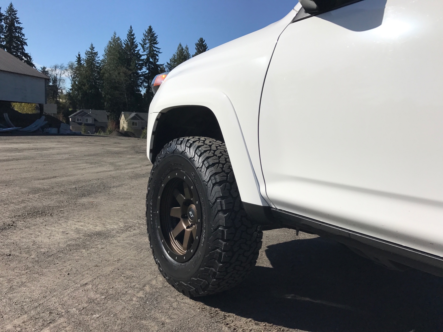

Stock UCA's for now. There was a slight rub which required trimming a sliver of the bumper and removal of the front mud flaps.
All good now.
How were you able to fit 285s on SR5 wheels? I thought they were only 7" wide and could only put 275s on stock wheels...if I'm wrong then awesome. One less thing to buy!
Looking to pull the trigger on some 5100s and a spacer out back. Question though, is Cornfed really the only quality provider of a 1 inch spacer? Want to do the 1.75 and 1 setup and just wanted to see all options before ordering.
Thanks!
I think most people pick the cornfed because, if I'm not mistaking, they are the only ones on the market that correct the left to right lean.. that's why I'm buying them. There are other quality set ups out there too but tried and true also help people sleep.

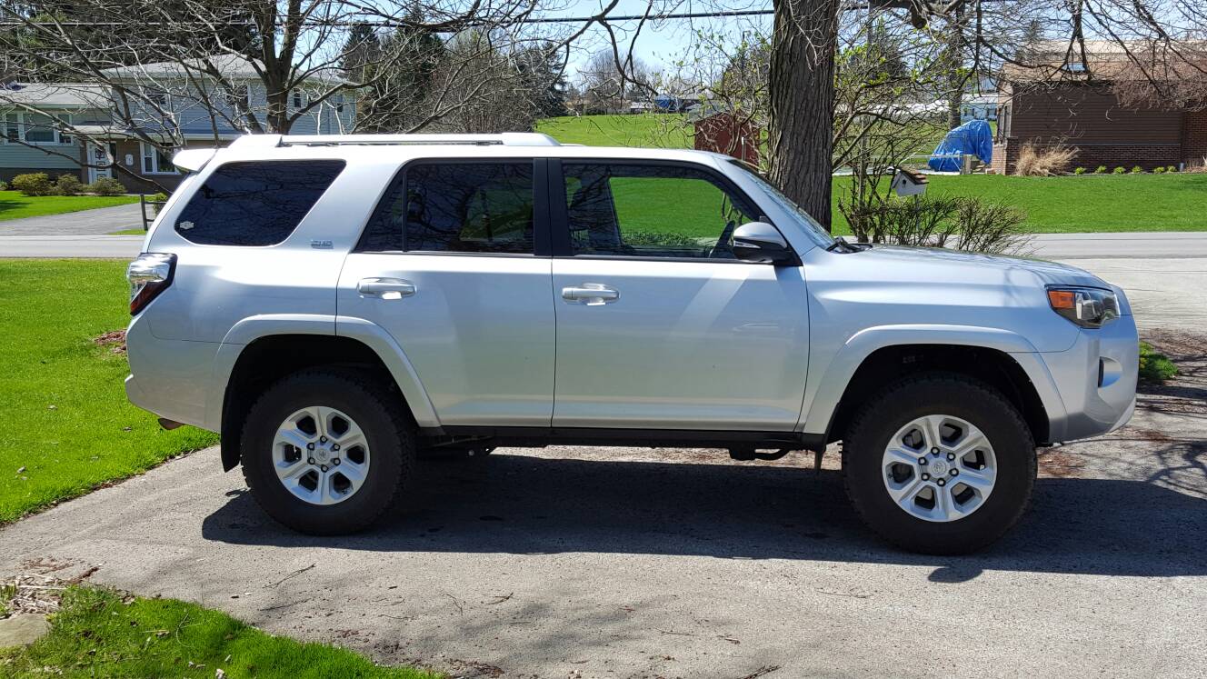

Front at 2.5" on stock coils- measured 2.25" lift.
Rear Eibach/Wheelers T13 "1.5" coils and 5100- measured 1" lift.
Rides absolutely amazing.
Front at 22.25"
Rear at 22.75"
