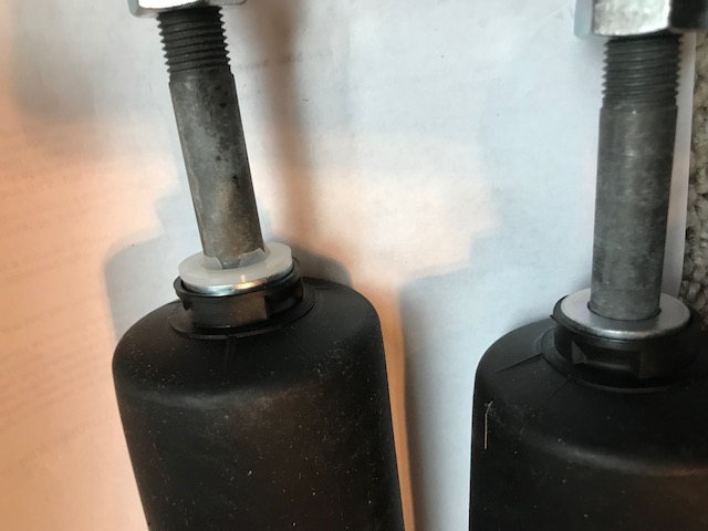

Ok, my 5100s were all delivered yesterday and I’ve got some questions about the parts that are supposed to come with the front struts.
They just came with the strut, circlip, spring seat, and nut. No other bushings or washers for mounting the top of the strut were there. Does this sound right? Also, one of the struts has a slotted plastic retaining washer which slides over the shaft to sort of keep the boot in place. This is missing on my other strut. Is that part just to keep the boot from sliding off the shaft during shipping, or do I actually need it? I can post pics if needed. Thanks for the help!
Here’s a photo that shows the plastic washer on one of them. I’m thinking it doesn’t need to be there?

I left those plastic washers on mine after speaking with wheelers. Supposedly they are there to keep the dust boot in place. Also, you’ll need to either resume your upper washers and cushions and top hat or purchase the KYB kit from amazon or rock auto.

Ok, thanks! Looks like I need to give Bilstein a call and let them know I didn't get one of those plastic clips. My current washers and cushions only have 2500 miles on them, so I'm thinking they'll be in good enough shape to reuse; just wanted to make sure those weren't missing from my struts too!

Just got off the line with Bilstein technical, and they said the plastic retainer is just there for shipping to help the boot stay on and keep from getting damaged in the box. The guy said if you were to leave that retainer on, it would just get destroyed since it would end up being sandwiched between the steel boot grommet and the steel top washer during installation.

So, I shouldn't have any issues with it being left in there?

Heres my thought: if the plastic retainer was taking up a 1/4" or 3/8" whatever thickness it is, when it breaks or smashes, you will end up with a gap causing the shock to be loose. Anyone else thinking the same?

Bilstein technical said it would just be destroyed the second there is any load on the shock and the retainer would come out in little pieces immediately. There shouldn't be a gap if something is pushing down on it, I mean it's literally the thickness of 2 business cards.

I'd venture to say the same. The rubber isolators compress more than the thickness of that, so it wouldn't really technically be loose. Worst case, just stick a wrench up there on the top nut and make sure it's still relatively close to 18 ft-lbs. of torque.

The plastic washer needs to be removed. If you go "bootless" you need to press out that metal washer and reuse from what I've read.

I am going to go ahead and install mine with it in place, worst case scenario I have little plastic pieces fly out when I put the truck back on the ground.
