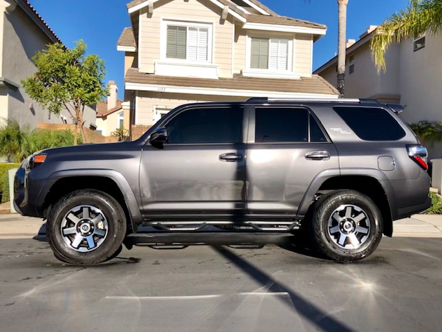

Here's 5100s all around. 1.75"/0". Long story short, shop didn't install 0.5" cornfed spacer. Question is should I proceed with the 0.5" cornfed spacer or should I go with 0.75" or 1" cornfed spacer? I think 1" spacer in the rear maybe too high for my taste. I looking for more of a leveled look or slight positive rake. In this pic, I can see the 0.25" negative rake from the nerf bars.
Put the spacer the body and frame aren't parallel so even rake by looks is actually negative which will be exaggerated with a trailer or full trunk. The 5100s help a ton with nose dive so dont let that be a factor
