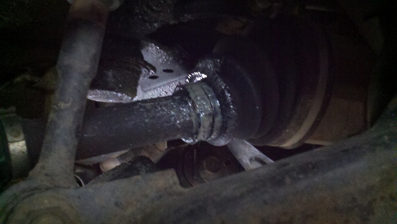

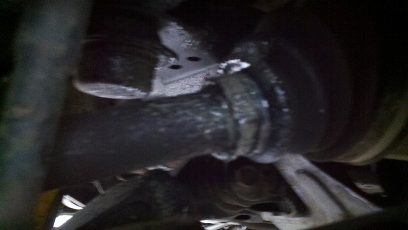

This is my 2006 sport. The inner boots are leaking on the right and left side. I installed a daystar 2.5" spacer lift on it in July. It seems that the leaks are not that uncommon after a lift. But i wanted you guys to look at it and tell me what you think. I may try to inject some more grease and add hose clamps.

Doesn't look bad at all. I'd regrease and re-clamp both sides. I re-clamped mine a few weeks ago and havnt had a leak since. I'm gonna regrease both sides when I have some time.
After I did my lift I got the same problem. The dealership was asking $600 plus for this job. I went home and did my research (a lot of threads about this) got an ordinary clamp from Autozone, and as the other member said "Dry as a bone". Problem solved.
I had the same issue. I knew I had a little leak but one day looked under and had what looked like runny grease coming out of the small end of both inner boots.
I went ahead and had a shop clean them up and repack with grease. The outer boots were not leaking at all, BUT when they pulled the outer boots, the grease ran out like water. So I had them put a whole new boot kit on. I figured if you're going in, do it right. It was about $300 with OE parts and labor, all four boots replaced, joints cleaned and new grease.

Got the clamps on this morning. I didn't have time to add grease (didn't have any), but I at least stopped the bleeding.
Its not an issue related to lifting your vehicle, it seems to be a common issue with 4Runners and Tacomas. The small inboard CV Boot clamps leak or the boot tears at the clamp. Had it happen to my rig and seen it a lot at work.
any automotive grease will work, you can even mix and match if you want

Did you use stock clamps?
I used hose clamps I had in the shop.

I put on my Daystar kit over the weekend, and I ended up with the same problem. I was surprised, once I started searching on here, to find how many people had this issue. I don't remember ever reading about it in my research before deciding on my lift.
Anyway, I just took it to my mechanic when I had the alignment done and he charged me $3 a piece for the clamps, and half hour labor to replace them. Not too bad.

Damn, no mechanic hook up? You couldve done it yourself for under $5 and less than 10 mins. Did he use hose clamps or stock clamps?
