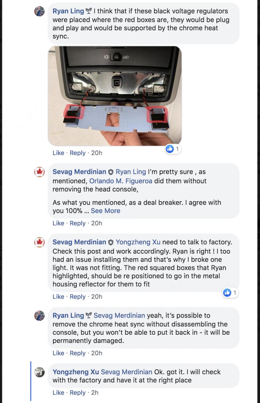

Mines raised too and looks like there's some good news. There was another post about fitment issues on facebook and cartrimhome is going to look into moving the black blocks for a second revision.
I was also somewhat able to get my lenses to fit by loosening the PCB screws on the rear of the light. I'm able to get the center lens to fit flush but it also makes my sunroof and garage buttons a bit harder to push but it's a workaround for now till these get replaced.

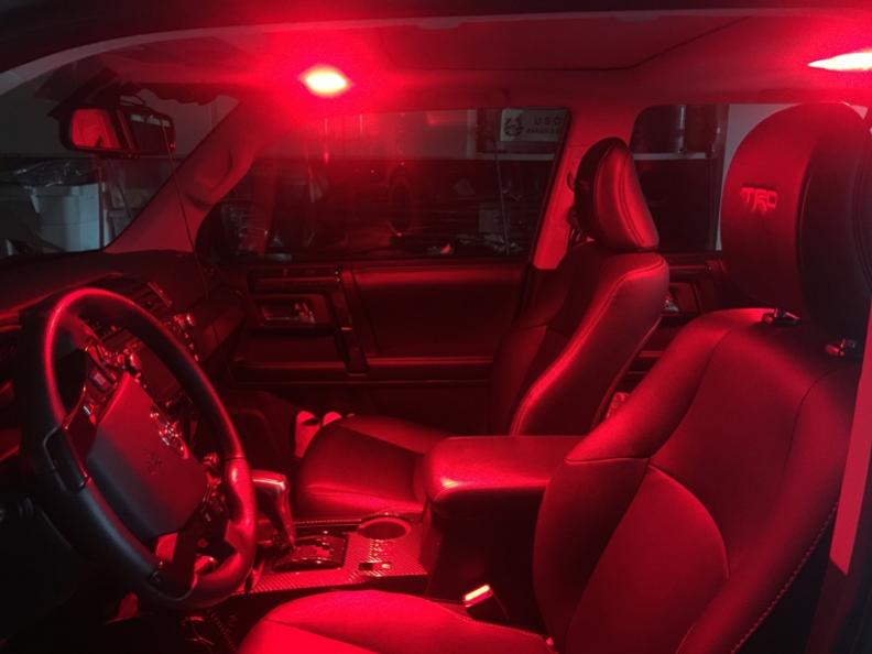

Red light mode!
Not that I want to support this blatant knockoff of Arclights, but you need to remove the reflector for this to work.
I did remove the reflector and the fitment is still pretty bad. I wasn't able to close my garage this morning so I took out the console and tightened the screws. Now my center lens is loose and barely hangs on since I wore down the stubs that hold the lens in by pressing it in so many times since the corner pops out randomly.
I doubt cartrimhome did any fitment testing and simply just released them thinking they'd fit since it's a copy of arc lights board. I'm going to stop by my buddy's place this evening to take a look at his setup and see if there's any differences and report back.
Having read all of the concerns with fitment of the map lights I am taking this approach.
Metal reflector had to come out, not the least for space issues let alone the possibility of shorting out the back of the circuit board. I used some tools to reach in to bend back the reflector's small retention tabs and removed it. If I ever want to struggle with putting it back I can stash it away for that day.

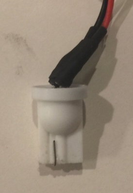

The goofy plugs that go into the 194 bulb sockets are too long so I modified mine. I unplugged the wires from the 194 plug body then removed the wires and metal prong from the white plastic body. I cut some heat shrink tubing for each wire and one to go around both wires.
I shrunk the tubing around each metal prong and then shrunk the larger piece around the two insulated prongs.
On the white plastic 194 type plug I cut the rectangular plastic away from the two metal pins so that they are free and clear. Next I plugged the insulated wires directly onto the two metal pins and ended up with what is in the attachment. A shorter assembly where the wires can be bent over and clear the LED circuit board.

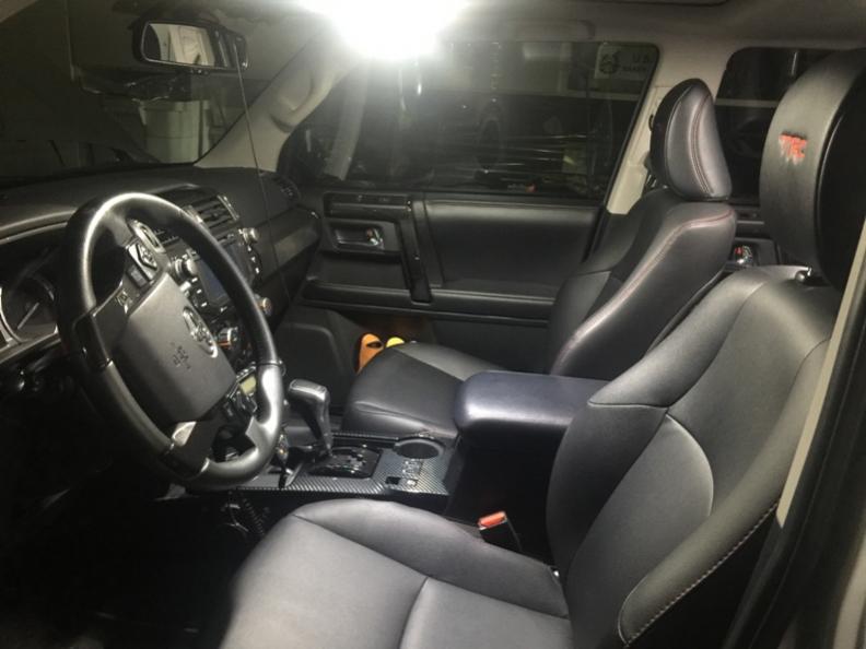

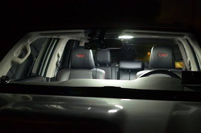

Some nighttime photos of the upgraded interior lighting in operation.
