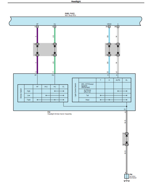

[MENTION=116156]TheWraith[/MENTION]
Hope this helps...
