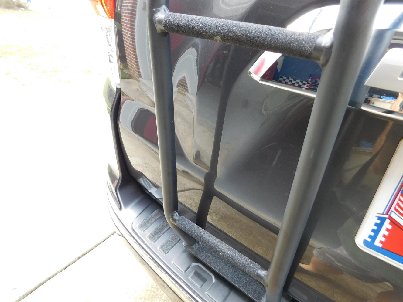

Put some grip tape on the bumper and ladder- long overdue for that. Speaking of the Gobi, it's starting to look a little rough from use. Lots of chips and surface rust and the powder coat is getting dull. I'm gonna take it off and paint it probably this summer.

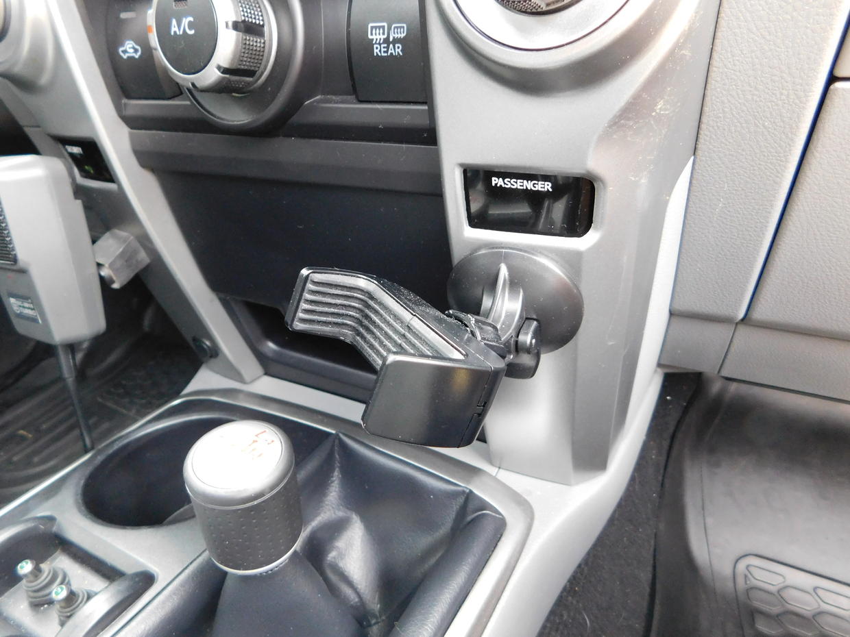

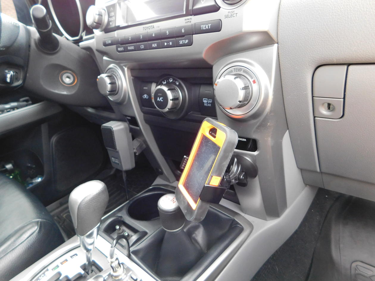

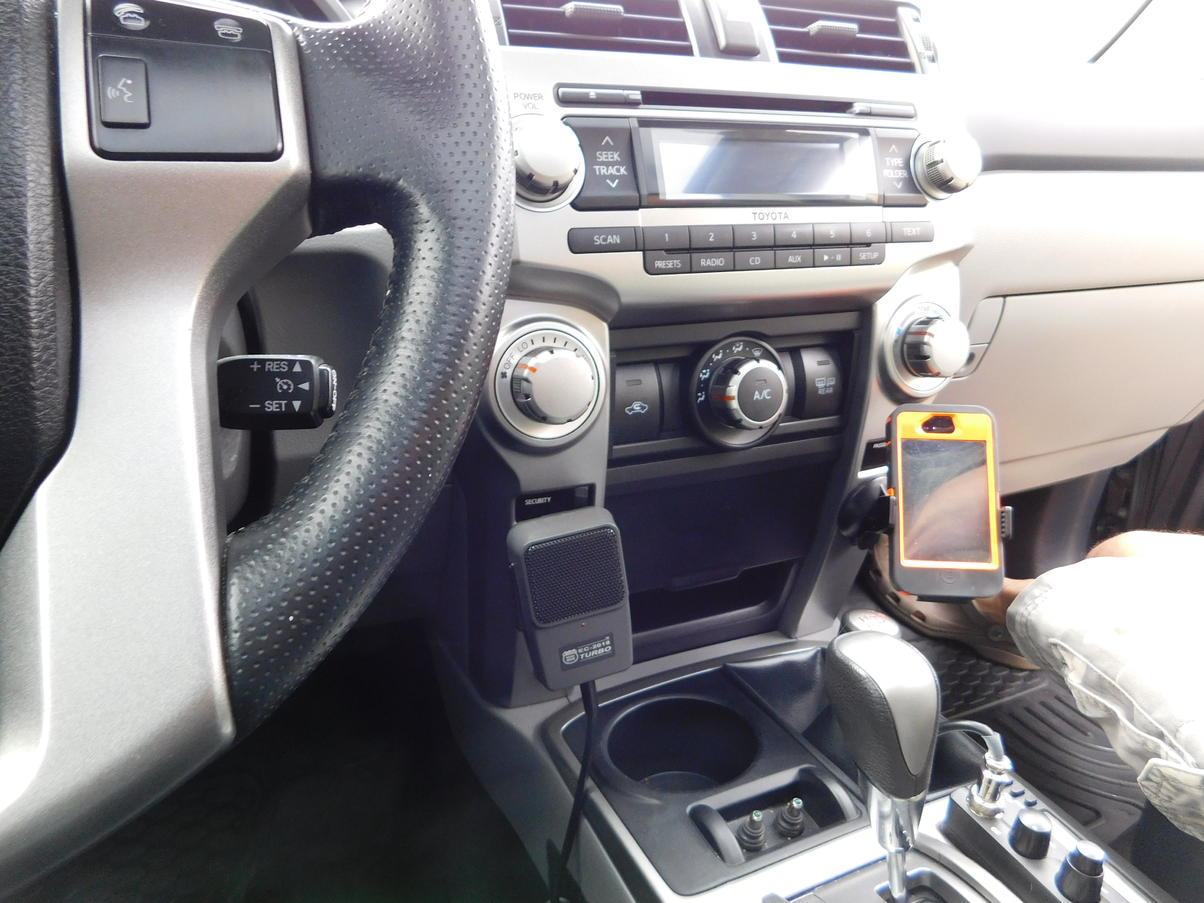

Also took a phone holder that wouldn't work in the space I wanted and swapped bases with my Garmin. I also screwed it in from behind the panel. The cam still works and pulls it nice and tight. Pretty happy with this.
