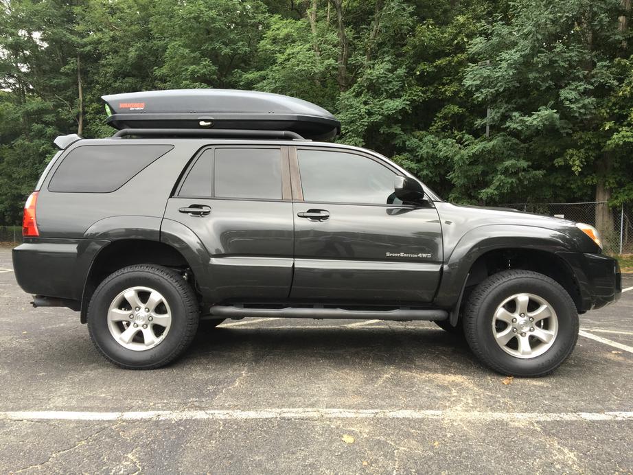

I installed mine about 2 weeks ago. The front set at the fourth notch.(1st notch being the lowest) the rear sets are 5160 with wheelers off-road 1.5inch rear Spring. I'll try and upload a pic. Didn't measure anything but I'm happy with the looks and ride. 115k miles on the old xreas for comparison.
I'm not a suspension expert but I feel that it does A better job when I hit big bumps. It also tows better than before. The factory rear springs sag more with the same load and didn't tow as well. By that I mean It feels like it took the shocks longer to settle out after hitting bumps when towing a load.
I haven't taken corners aggressively but it does feel like it leans more than the old xreas system I took out.
It's Hard to quantify how much better because everyone is different and prefers different handling characteristics.
if you have worn out factory stuff you can't go wrong with the upgrade. Mine factory xreas had 115k miles when I swapped them out.

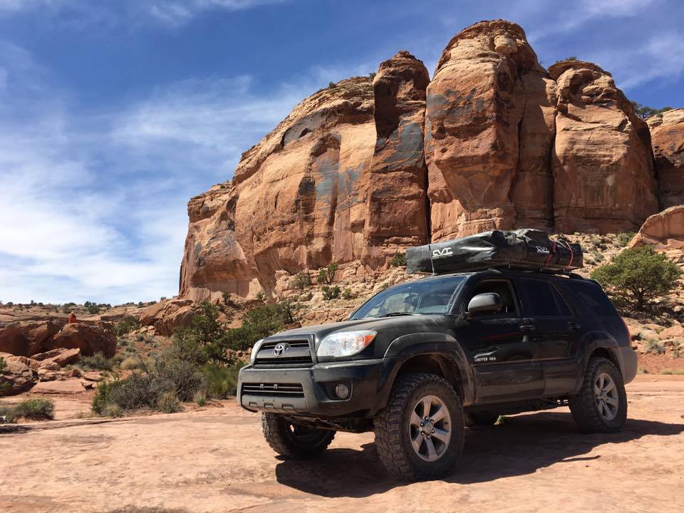

Ordered 2.5" in the front, but it really turned out to be closer to 3" I think. I went +2" Radflo springs in the rear and I'm not quite level - rake a slight bit towards the back, which I'm not happy about but will live with until I re-do the rear end down the road. If it really starts to bother me I may throw some 1/2" spacers in the rear just to change the rake.
2008 Toyota 4Runner 4x4 Limited.
Daily Driver & Weekend Warrior
This is such a sick ride. Love the Shadow Mica and the lift with the cargo top. Looks very balanced.
Looks pretty good, pretty much the exact setup I want... I'd want the rear a tad bit lower, but it looks pretty good as is!
