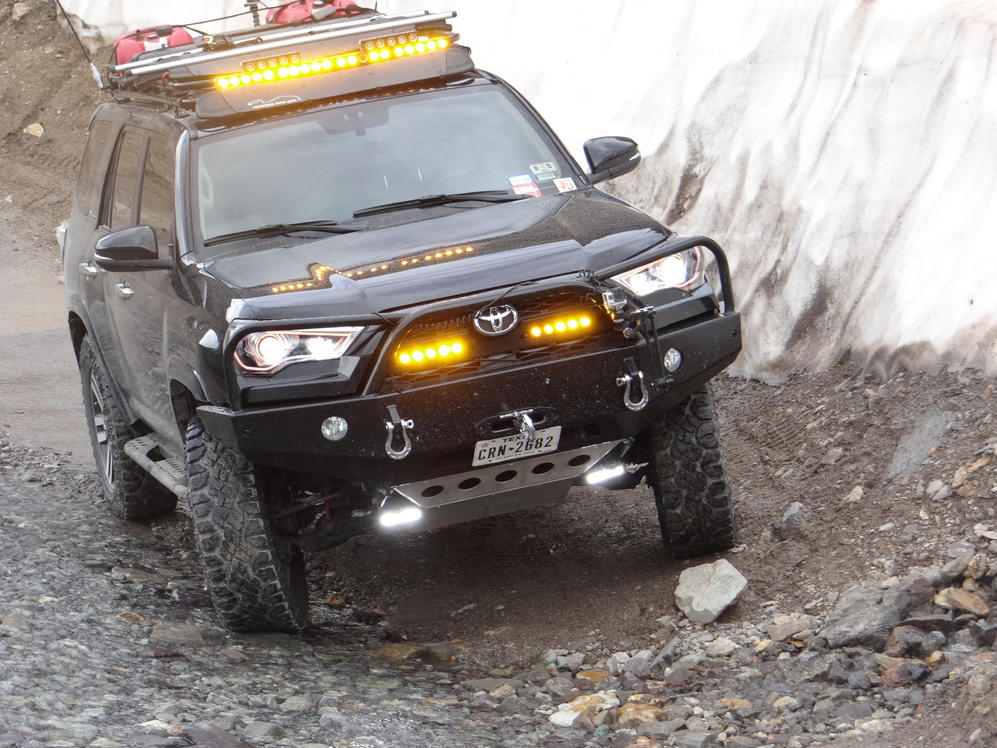

May I humbly suggest the link in my sig, I've tried to collect most of the cool lighting mods that I've seen people throw on their Runners. I will say that I haven't seen anyone add additional fogs BELOW the front bumper, I think this is because most of front lighting is completely taken care of with the mounting of an LED bar in the grille, not to mention that adding fogs under the bumper (no matter how clean or tight the install) will effect your approach angle and would generally be more vulnerable to damage than an LED bar in the grille.
Good luck with your search and please let us know what you go with especially if it's something different (and take pics of the install!), so I can add it to the Lighting Info thread. :rockon:

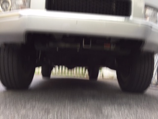

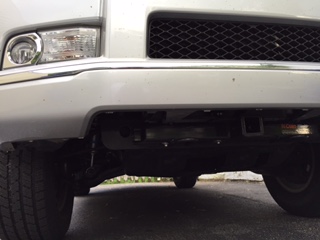

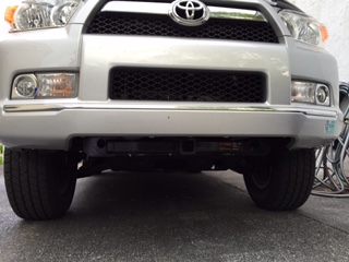

You should probably post a pic of your front end.
Thanks Philsy. Great idea. Here we are.
I will say that I haven't seen anyone add additional fogs BELOW the front bumper, I think this is because most of front lighting is completely taken care of with the mounting of an LED bar in the grille, not to mention that adding fogs under the bumper (no matter how clean or tight the install) will effect your approach angle and would generally be more vulnerable to damage than an LED bar in the grille.. :rockon:
Thank for the input. I understand that they’ll be more voulnerable. I don’t think they’d detract much from the angle of approach more that the front hitch already does, which is fairly insignificant. If you look at the pic w/ the fish, as you can see I use my runner as a surf fishing beach buggy. I use a front cooler rack. This is why I installed a front hitch. An in grill light bar would be covered by the rack. I need lighting underneath of the rack. Like I said to see whats on the ground up a head on dark, foggy, rain beaches.

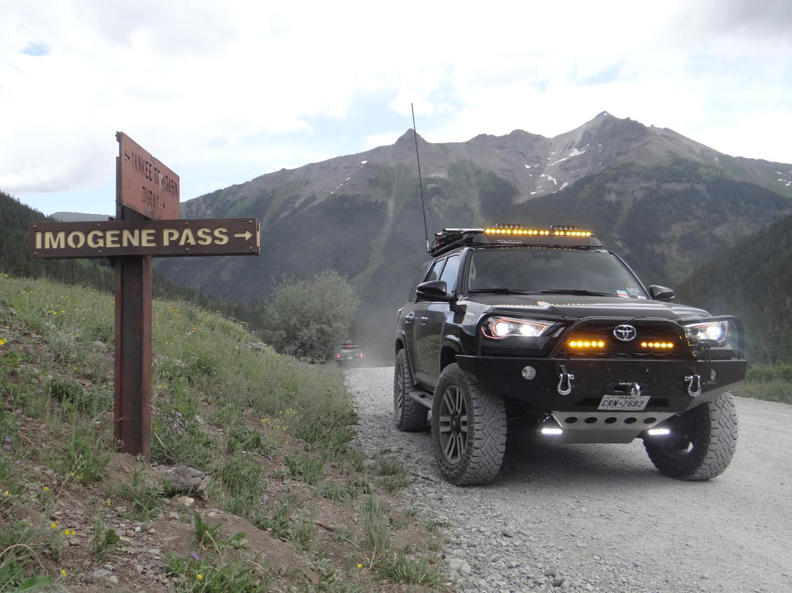

I don't like that location and don't think I've seen anyone doing the same so you may be limited to a custom mount - should not be that difficult. There are some lights such as Rigid that offer yellow covers so you can duel purpose the lights. I may have pics of them in my thread.
Just a thought...have you thought about "ditch lights" instead? You can aim them how you want and they won't get all roughed up under the vehicle.

If I were running that kind of set up, I would just mount them to the carrier and wire in a pig tail to the front of the vehicle that would be plug in power. That way you won't drag them off and by your post above would only have them mounted when you need it.
I'm with 1engineer about this one. You could probably even splice the plug into the original foglight harness under the nose so you would activate them with the same switch.

Sort of confused. Are you driving around with that cooler and rack mounted? If so, the only decent solution would be to put lights on the front of it (and have a plug), or go with roof or ditch mounts.
Thanks engineer & friends. Yes I only have rack on when on the beach & too & from. The rack rides quite high up between headlights. I thought of mounting fogs to the rack but kind of want to be able to use them even when don't have rack on. But the more I thing about it, you guys are right, they would get rubbed off. Prolly pretty easy to bolt some lights onto that rack.

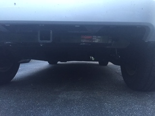

Gotcha, much clearer on the need now. As suggested above, I'd bet some of the amber duallys could work well, or maybe even a couple of the 6" Rigids. From the pics it looks like maybe you could go with a drill-in mount on either side of (bottom of) the front hitch crossmember?

I like that idea. If it's on the front of the hitch, it's somewhat protected as the hitch is resessed from the bumper/grill. If it hung down it would get rubbed off.

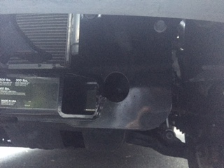

I am onboard with [MENTION=66316]1engineer[/MENTION] and [MENTION=105481]3wbdriver[/MENTION], but also there is the possibility of a maybe an "L" bracket made to get those lights out in front of the hitch without compromising the integrity of the hitch itself & not getting rubbed off..........
Possibly a dual setup, one set on the rack (plugged in when using the rack) and another set on the hitch (plugged in when rack is not mounted) using the same plug for each application.
That would be easy to do!

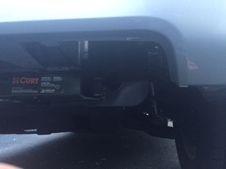

I took a closer look at the front hitch. There are circular cut-outs on eaither end that may serve as a mounting position for low mounted fog lights. I don't how I attatch them there but they seem to be a good location.
What do you think, are they good locations & any ideas on how they could be attached?

I added these white ones. THey were like $15 each off of ebay. I figured if I accidentally crush them, I wouldn't be out that much...
