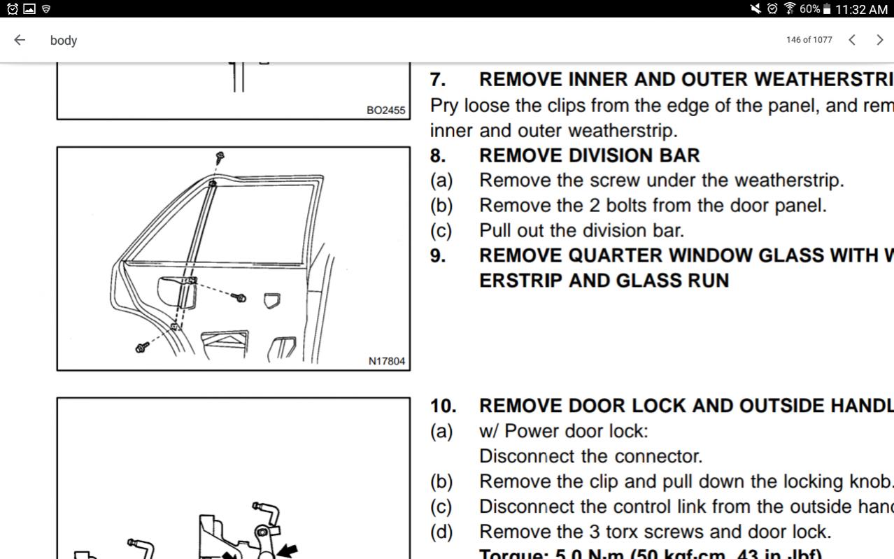

This pic from the fsm might help.

He's got it right. I've done it a few times. You can get it in and out without taking the track out of its spot, but it's way easier to pop the inner door panel off and unscrew the track, then it just slides right out.
