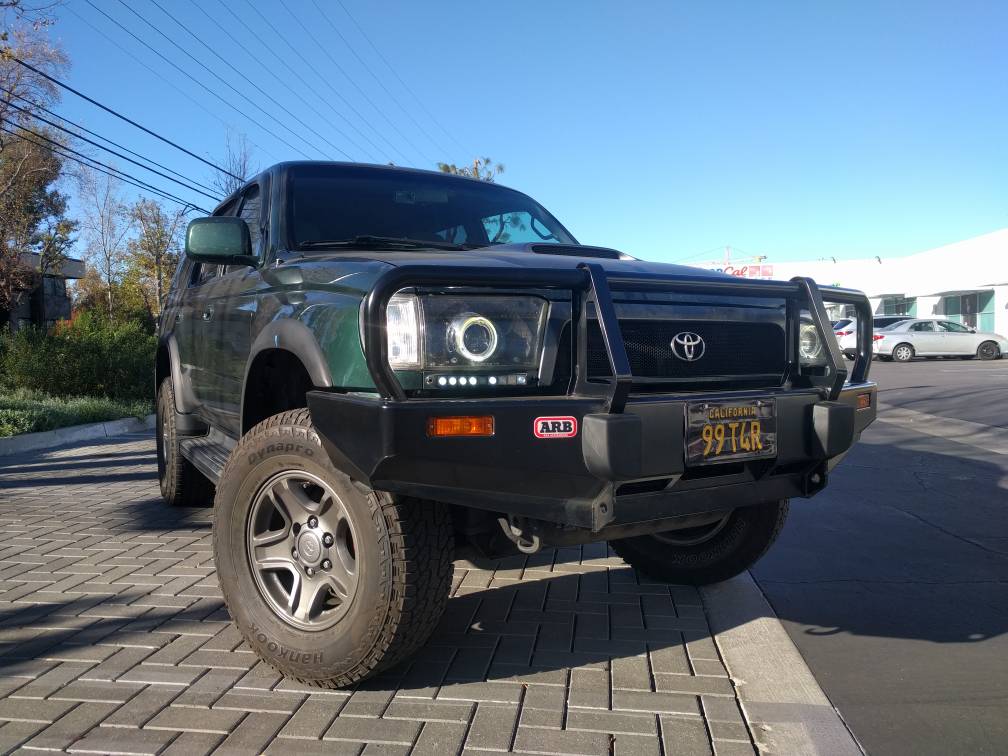

Well, here she is. Dirty, and not in tip top shape at the moment, but I'll get her back to her full glory soon enough :D
Issues as seen in this pic
-bad wheel stud/lug nut on passenger front
-cracked grille
-bent front fender/headlight filler on driver side
-LEDs in passenger headlight filler out (ugh)
