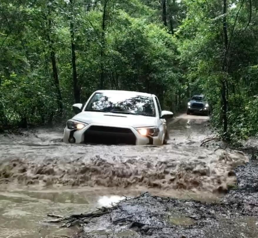

I feel the same, they don't really suit the angular factory lines Imo way to round -anyway my last outing had me thinking..
After looking at a video someone took this weekend I wondered if I'm teetering on the border, I already have a three inch lift and the rainy season has not really begun yet!
