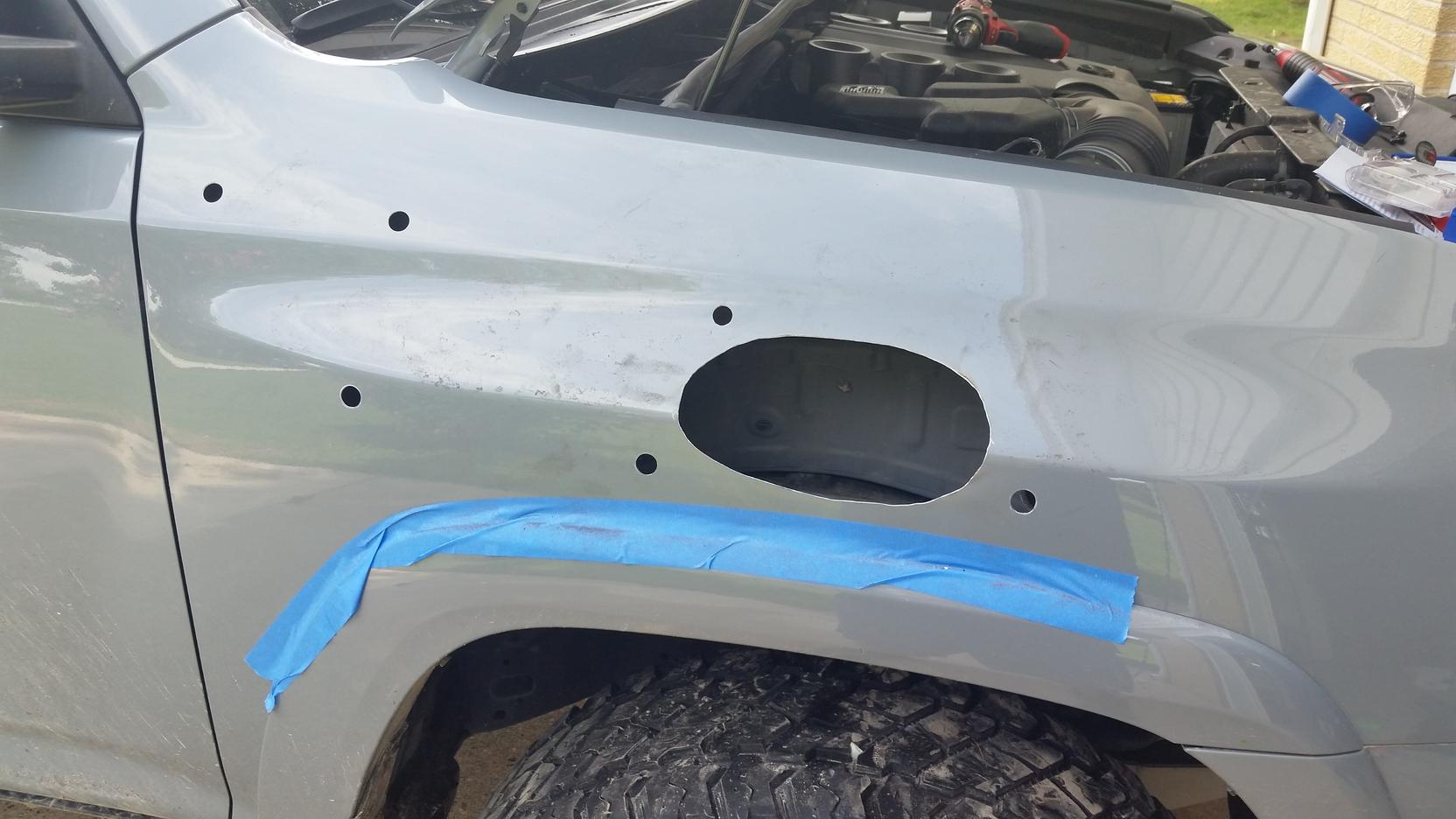

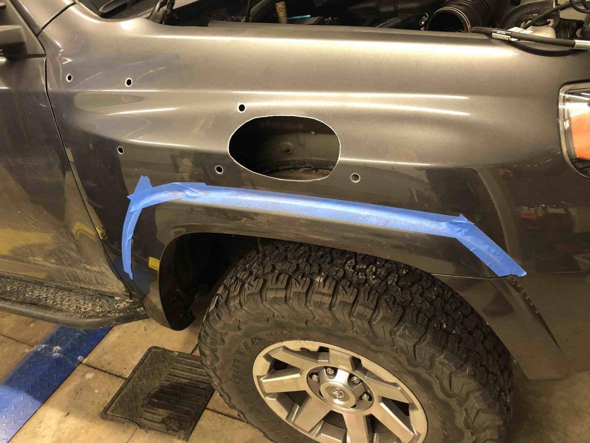

Just got my snorkel installed. Wasn't to bad. I think the inner fender was the worst part. Only I would add is just take the front tire off and put it on a jackstand. You can do it with the tire on but in hind sight it would have made things easier.

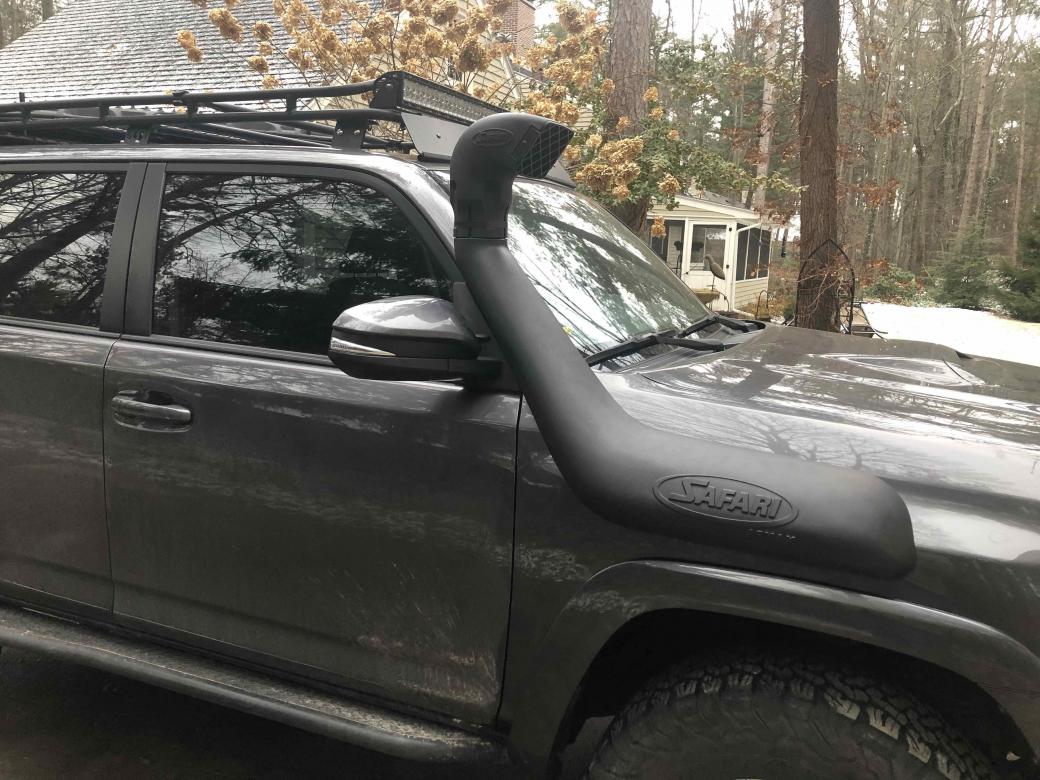

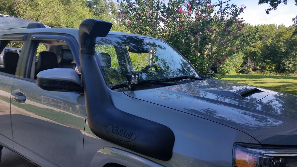

Another install, all went well other then I found taking the rubber piece that connects the stock air box to the snorkel and heating it up and then pushing it through from the engine bay worked like a charm vs trying to work it into the engine bay from the inner fender.
Very solid piece and in person looks better then the photos, still slightly sluggish looking but not as bad as I was expecting
