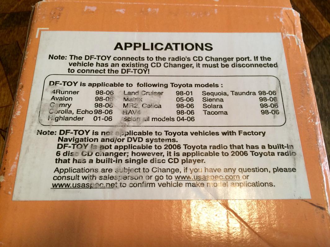

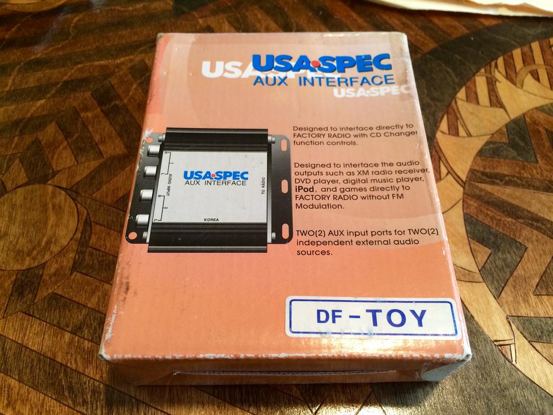

I have one in my '99 that works great and I've been very happy with (I can identify with wanting to keep the factory look). I'm at the dealership right now, but I'll grab a picture of the box when I get home. I was able to purchase it off of another member on this forum actually.
Edit: Here's a picture of the box. I installed this in the center underneath the plastic between the cup holders and the shifter and ran the wires into the back of the stock head unit; there are line-outs for two sets of rca jacks but I only use one of them to run a standard headset adapter. Everything fits great with no issues.
Backside of the same box:
That's the one I had! I sold that one to you haha. I ran that in my Supra for a couple years as well as my 4Runner before I upgraded both to aftermarket units. That thing sounds way clearer than those cassette adapters for sure.

Wanted to come back with an update. I installed the same unit 99problems referenced above and it works fantastic. The sound quality is as good as a CD and the transition is pretty seamless. For now, I would really recommend it - hopefully it lasts...

2) The ebay seller I used only had one unit, out of his own car. It looks like the DF-TOY has been discontinued for some time but USA-SPEC may have follow-up units or there could be other units from other companies. It seems like the biggest thing is that you actually need a unit that converts the signal rather than just a change in the connector like the moonet units.
