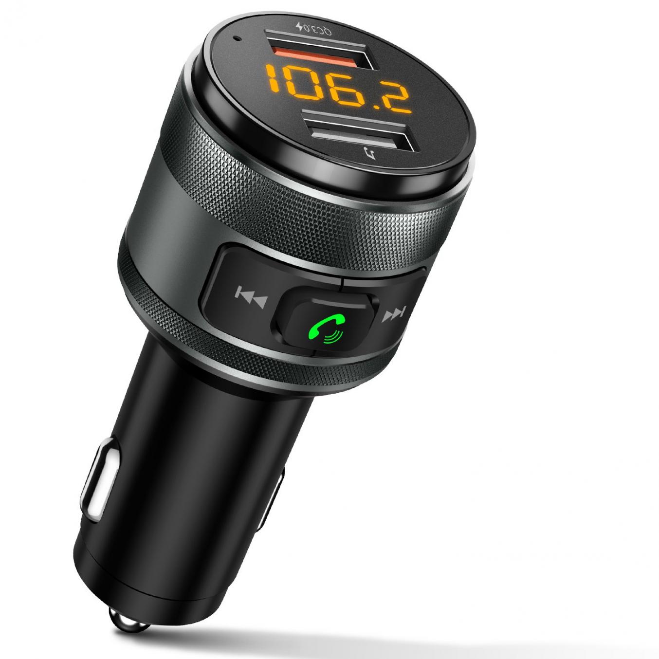

I have a 2002 LTD with an A56811 OEM head unit, double-din in-dash 6-disc. Works like a charm. With this unit, is there an additional deck port (pls god) to install an aux audio input? Also, if that's the case, anybody hear of an aux input (pls god) with Bluetooth connectivity?
Hey, did you ever find an aux unit for your unit? I have the same unit: 2002 Limited with an integrated 6 CD player (not an external changer). Will this work?
