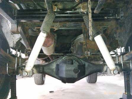

Interesting you mention shocks. The shocks have been mounted at angle. But the mounting point is at the back. As I've been looking at traction/anti-wrap bars I started to notice that most who have angled the shocks have them mounted in the front. Or at least as far as I can tell in the pictures.
I wonder if the mounting position of the shocks play a role. In that with the shocks at the rear of the axle, they help push down on the back causing the axle to turn upwards and emphasizing the problem. With the shocks mounted in the front of the axle they would provide some extra resistance when the axle wants to turn up. ???
