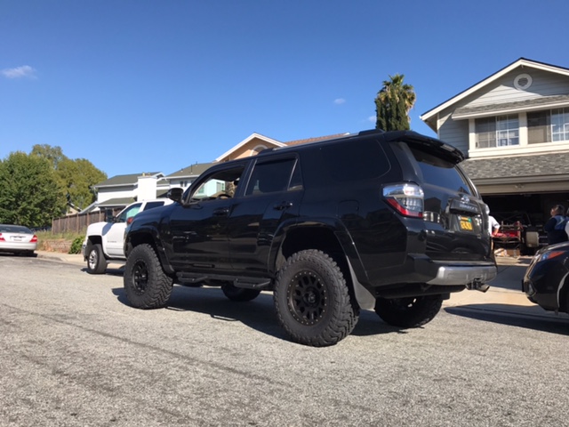

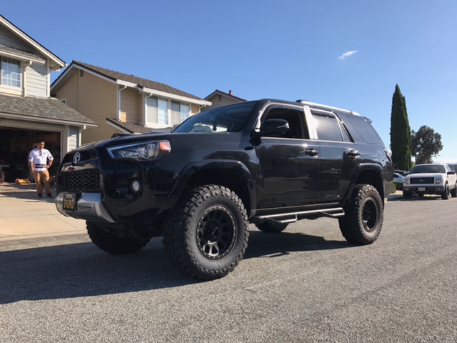

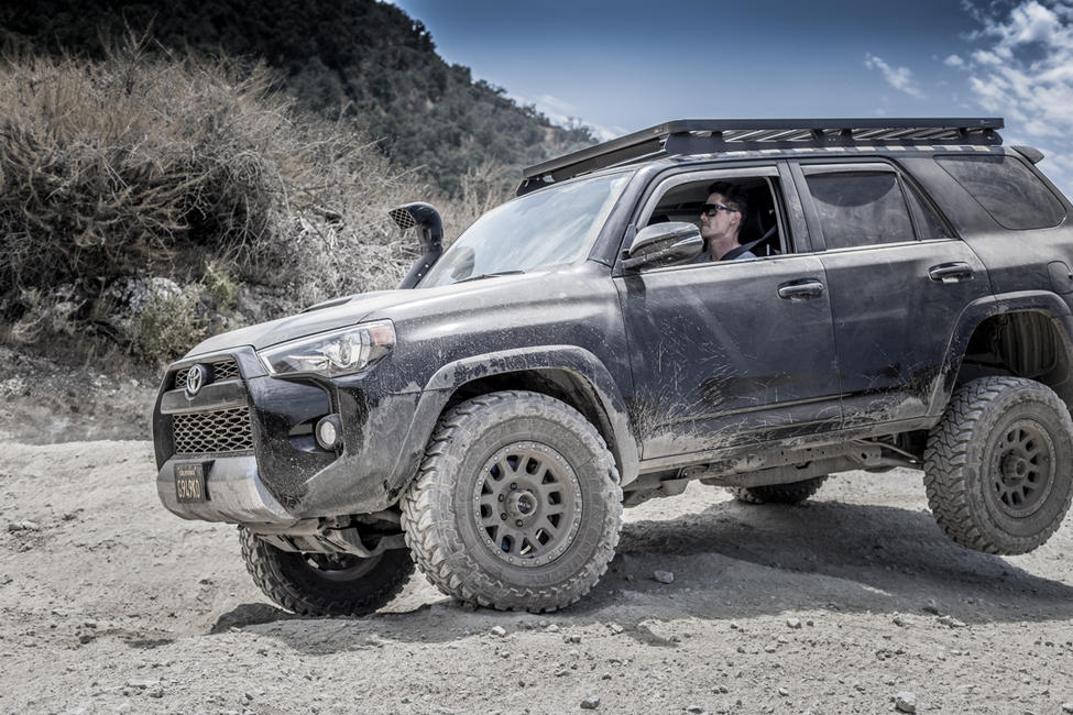

How she sat in the beginning:
How she sits now:

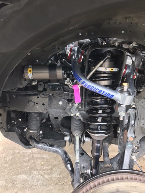

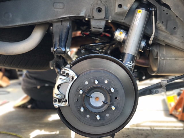

First things first - I wanted to make moves on getting the suspension done and build the 4Runner up from there. I did plenty of research through these stages, and wanted a setup that would perform off road without sacrificing ride quality on the road. While I would have liked to go King's for shocks and coilovers, I eventually decided on the Old Man Emu BP-51 kit thinking I could upgrade if and when I added the additional weight to justify it. I also decided to go with Total Chaos UCA's. For wheels and tires - I had experience running BFG KM2's on my Jeep but this go around I went with Toyo Open Country M/T's in 295/70R17. Wheels - I meddled back and forth whether to go black on black or not for a long time, but I eventually decided on the look of Method Race Wheels 309's. I knew I'd have to do a body mount chop and ordered Metal Tech 4x4's kit.
Installation:

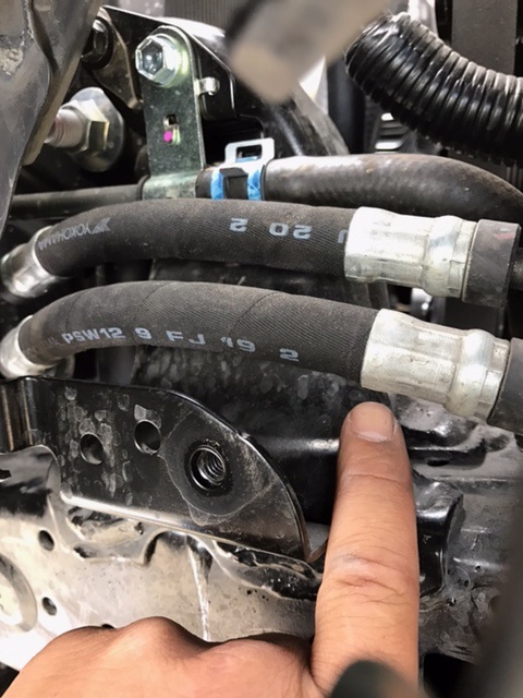

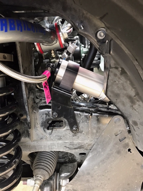

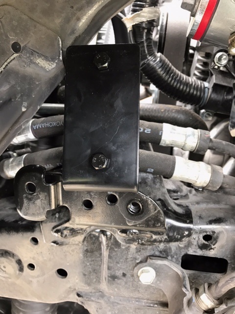

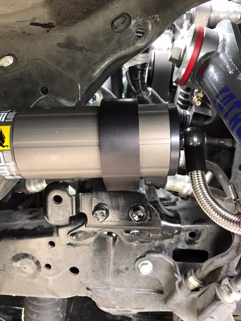

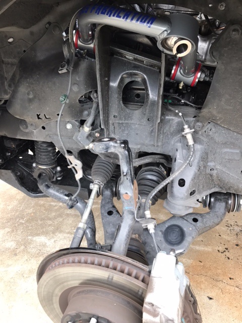

Things went smoothly with the suspension install until we reached the point of needing to mount the front driver's side coilover reservoir. The bracket that was sent to me from ToyTec was an exact mirror image of the passenger side bracket, which for those of you with KDSS, will not work. I was fully aware of the BP-51 kit and it's intended use for the FJ before purchasing (there may be a 4Runner kit out now), but I knew that the only difference would be this mount. I made sure to double and triple check with David prior to ordering the kit that the bracket included would work with KDSS, but after calling him back during the install as well as talking to the technicians at ARB, we decided to move forward with fabbing our own mounting bracket.
KDSS Lines clearly in the way of the mounting bracket
Made some changes to the bracket ToyTec sent
Fabbed bracket
End Product

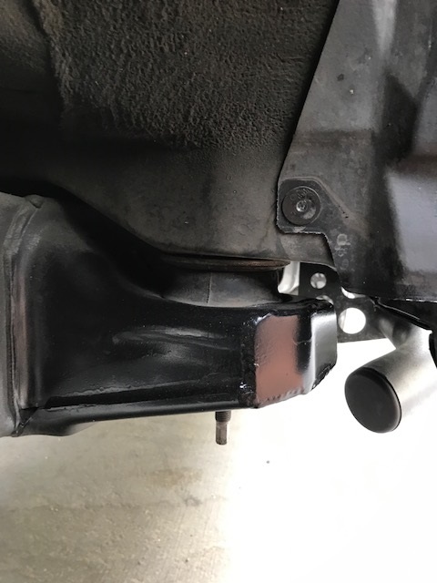

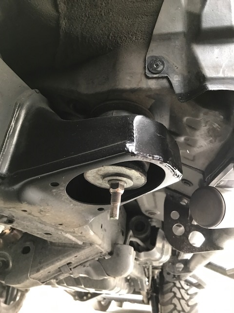

Moving on to the finished product of the body mount chop...

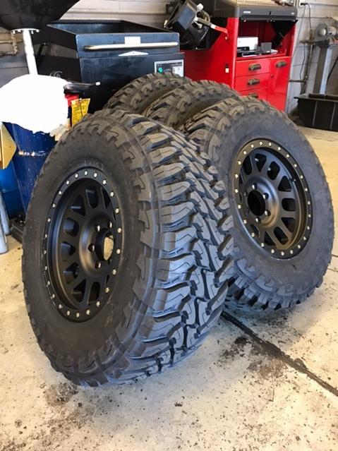

Tires and wheels all mounted up... donezo!
Overall I'm a very happy camper with the outcome of the suspension - still have slight rubbing when I'm at full lock in reverse, but nothing a little trimming can't solve. Ride quality is excellent.

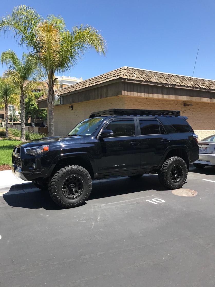

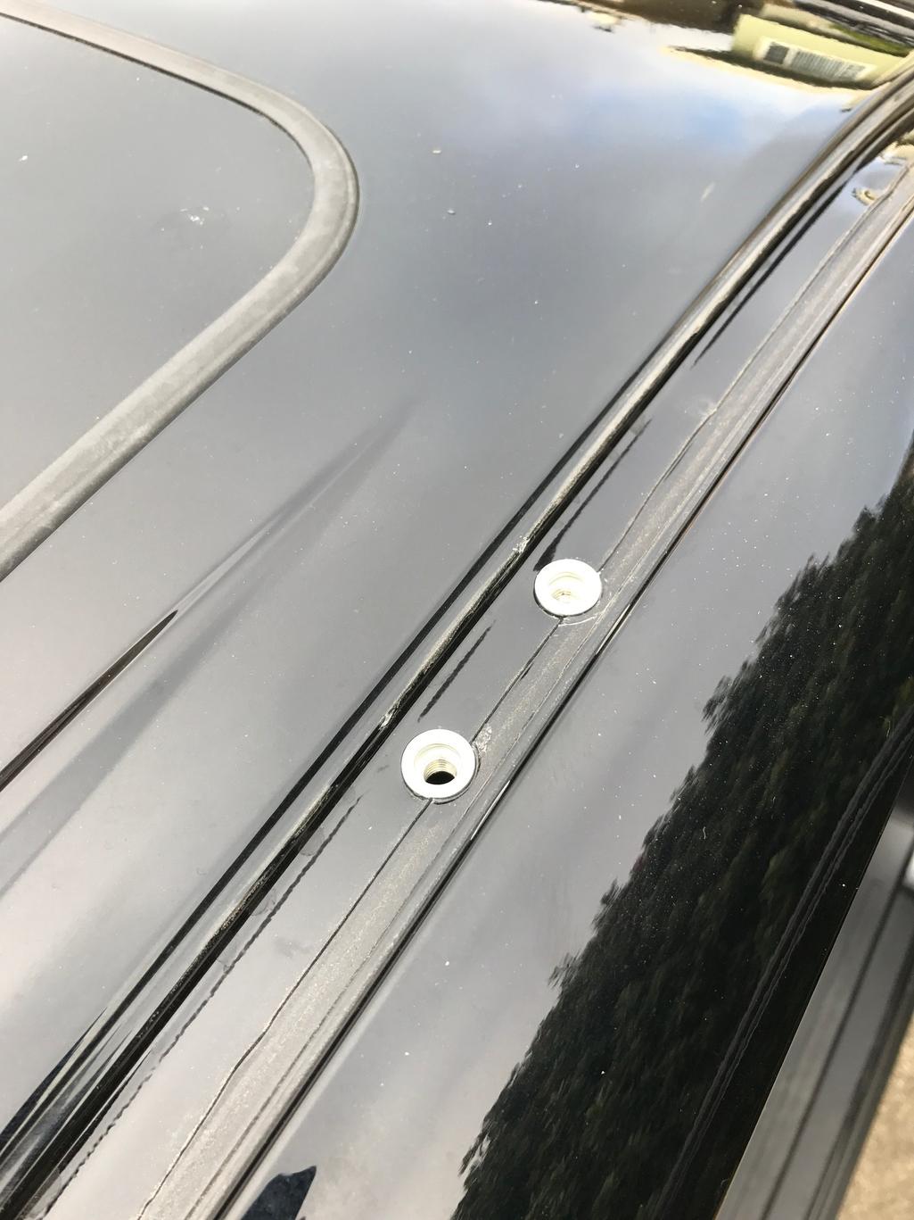

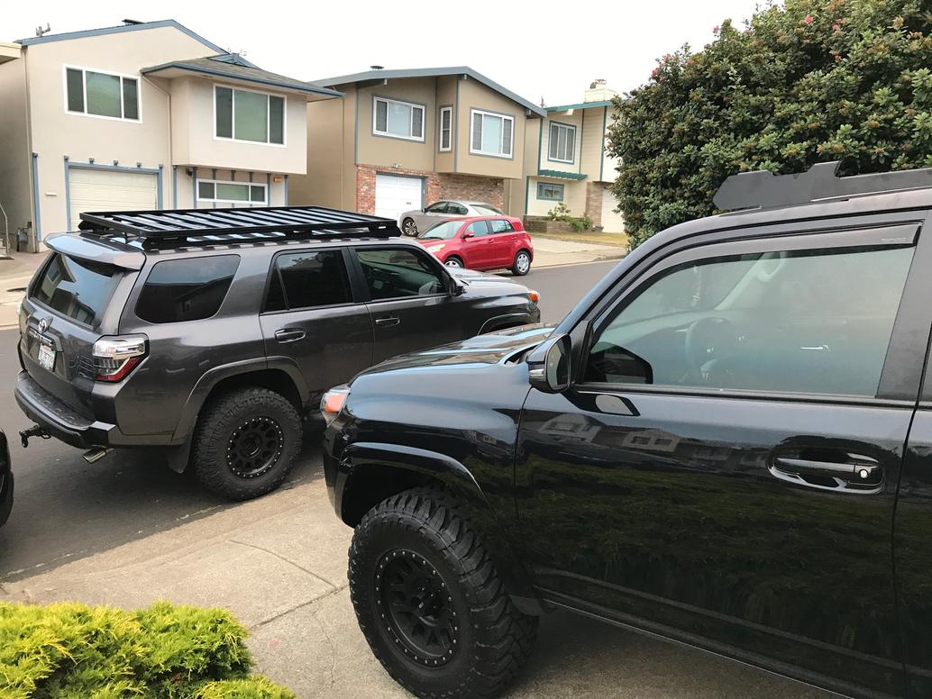

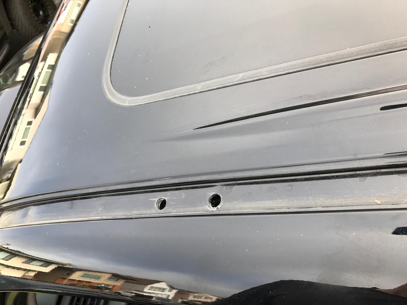

Time to get caught up! Got the Frontrunner Slimline II Rack installed last week and I couldn't be happier. A few photos below of the install,thank you to a fellow t4r.org member up in Daly City for helping with the rivnuts:

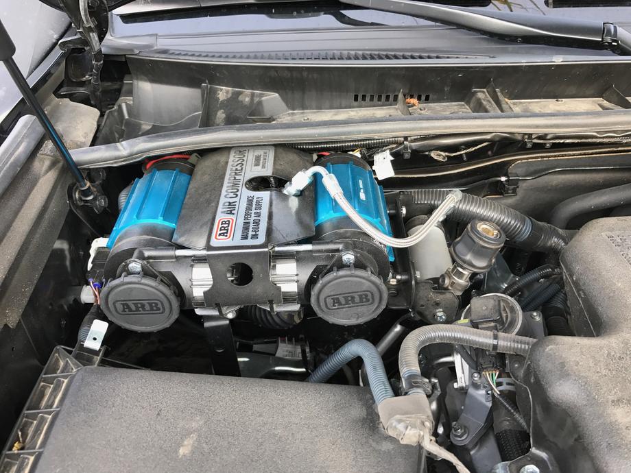

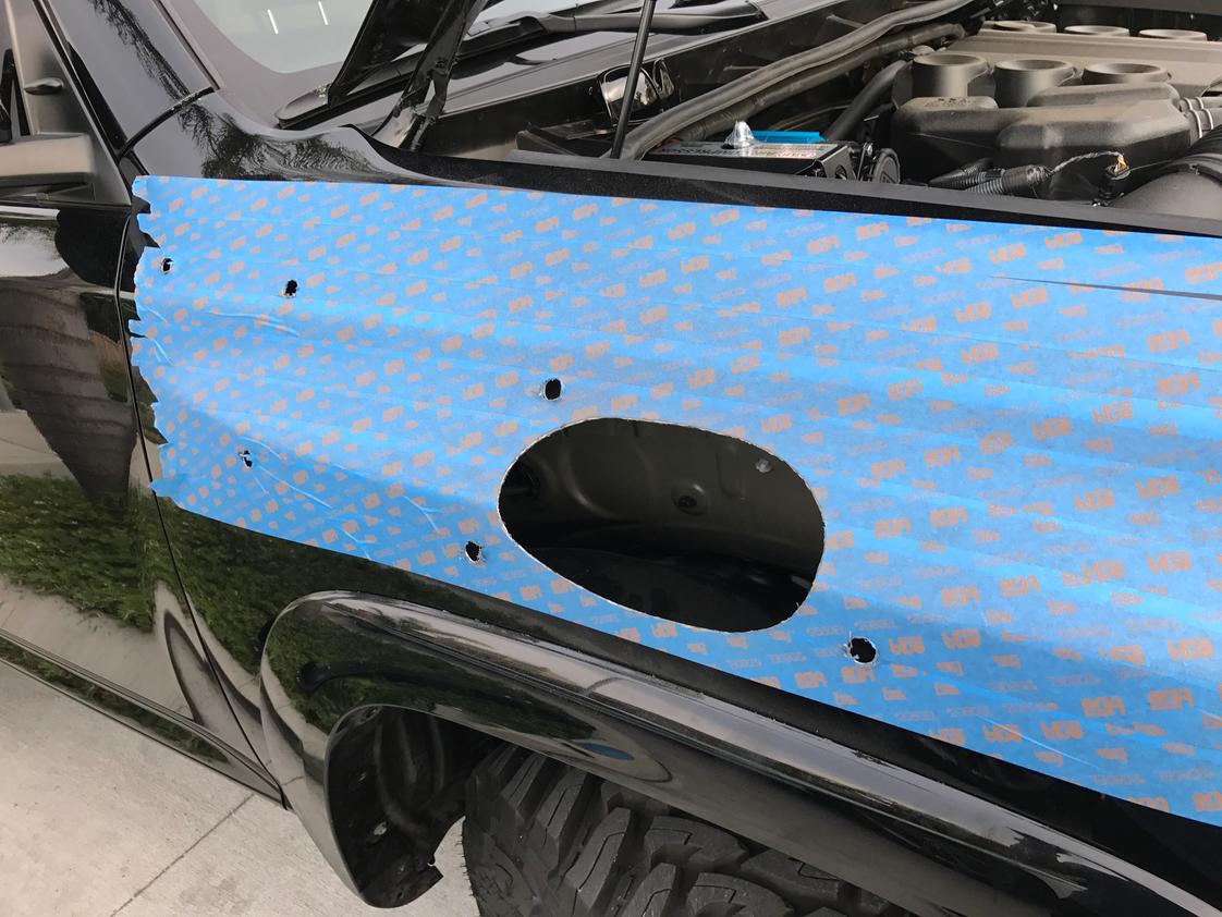

Went full send after the successful roof rack install and decided to keep drilling holes in my car. Spent a couple of late nights this week getting the safari snorkel installed as well as installing my ARB dual compressor + manifold. Couldn't be more happy with my @bandi mount. Will post more photos later today - more garage time after work today to get my ARB Differential Breather installed.

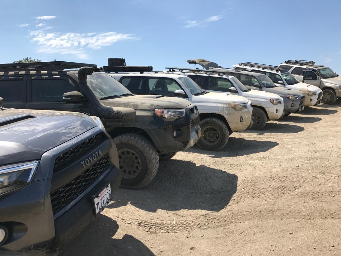

Went out to Hollister Hills this weekend with [MENTION=130461]1G3runner[/MENTION] and a few other trucks. In attendance were ten 5th gens, two Tacomas, one 3rd gen 4runner, and a Chevy Avalanche. Felt good to get off pavement for a bit!

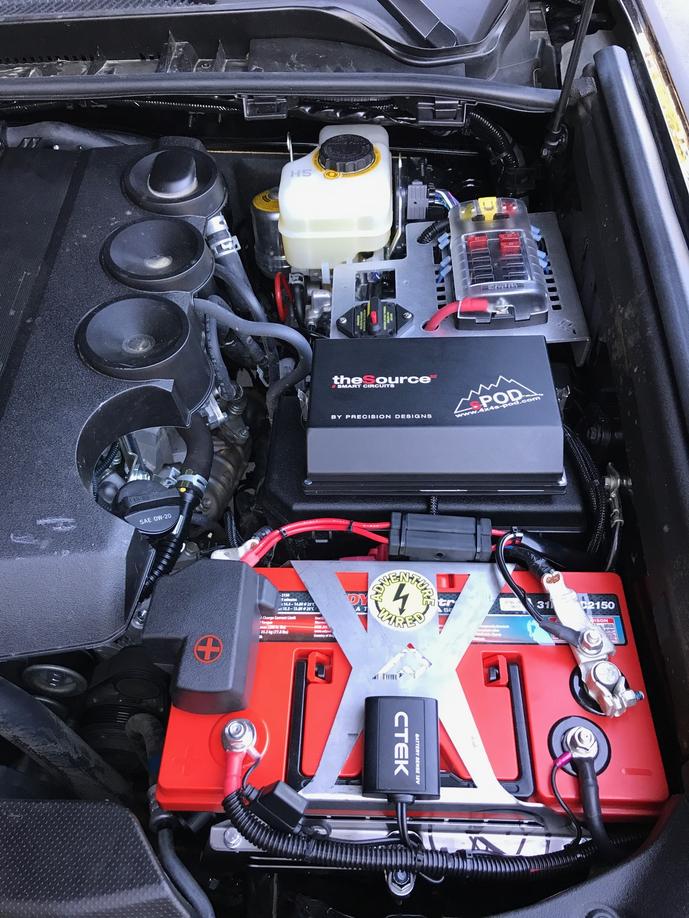

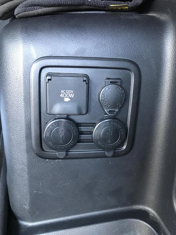

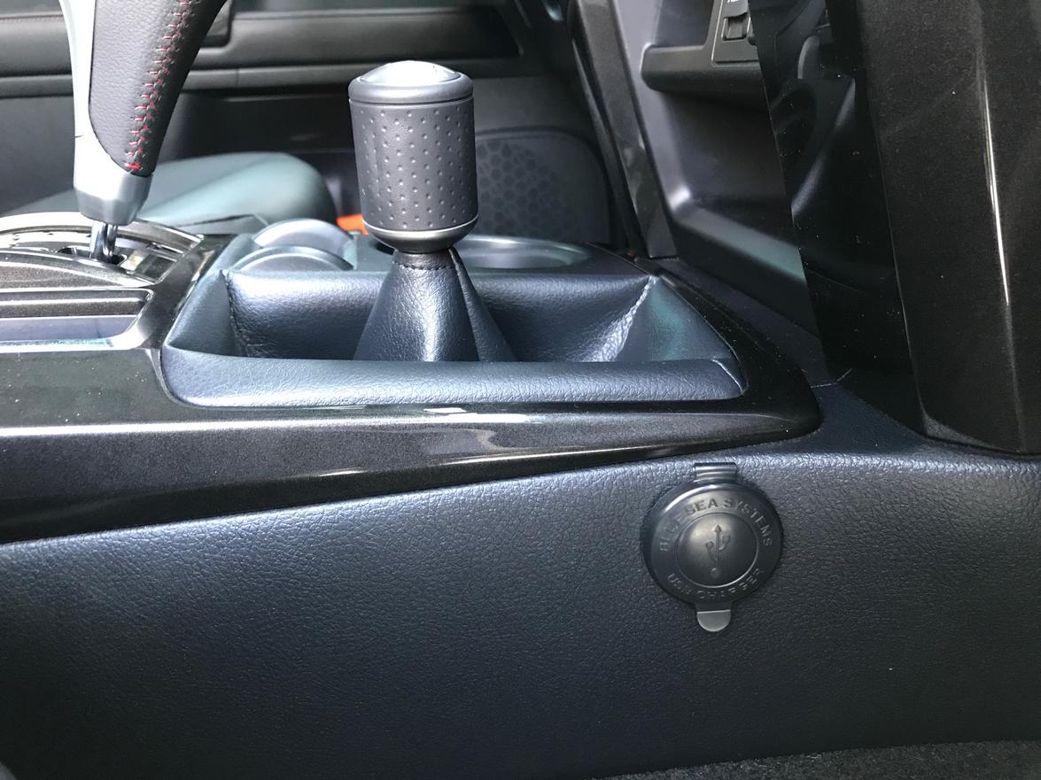

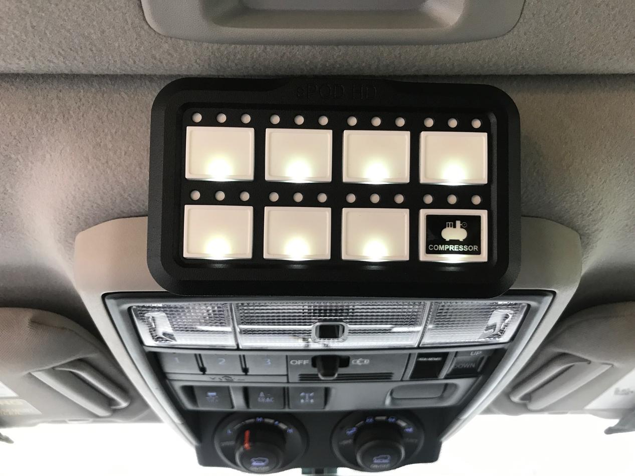

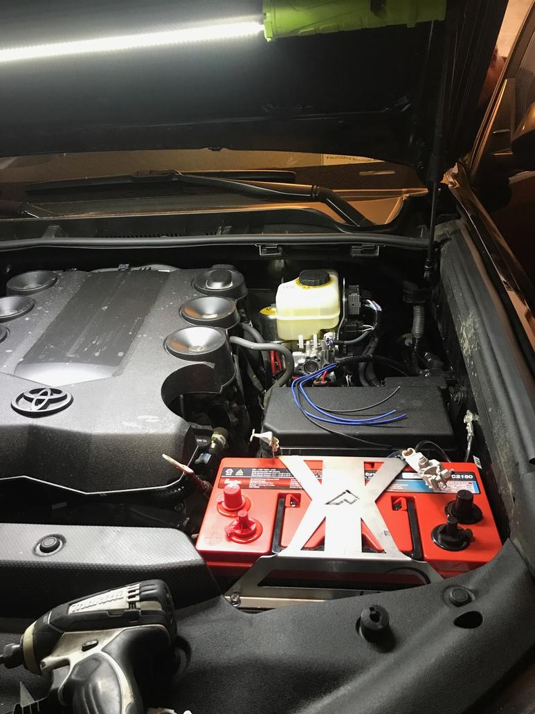

Electrical/Battery Setup
I teetered back and forth between going single vs dual battery setup - I decided for my needs only a single battery would be necessary, along with a solar setup to help keep the battery charged. I went with an Odyssey Group 31M battery and used Pelfreybilt's battery cage.
I wanted a central switch system that would have a central switch panel and a clean way to keep a mess of wires from cluttering my engine bay. I chose to power my ARB dual compressor + manifold and future light/winch upgrades by the sPod HD. All items that need to be wired hot will go to a Blue Sea fuse block supported by the Pelfreybilt fuse panel. Also added: 1 Blue Sea 1045 USB charger in the front and 2 in the rear, and a CTEK battery monitor that runs to my iPhone via bluetooth. Huge shout out to Mitch at Adventure Wired for the extremely clean install, I had a blast watching him and helping where I could.
Rest of the switches reserved.. stay tuned :tongue:
ARB Compressor + Manifold (post trail run)
Finished product:

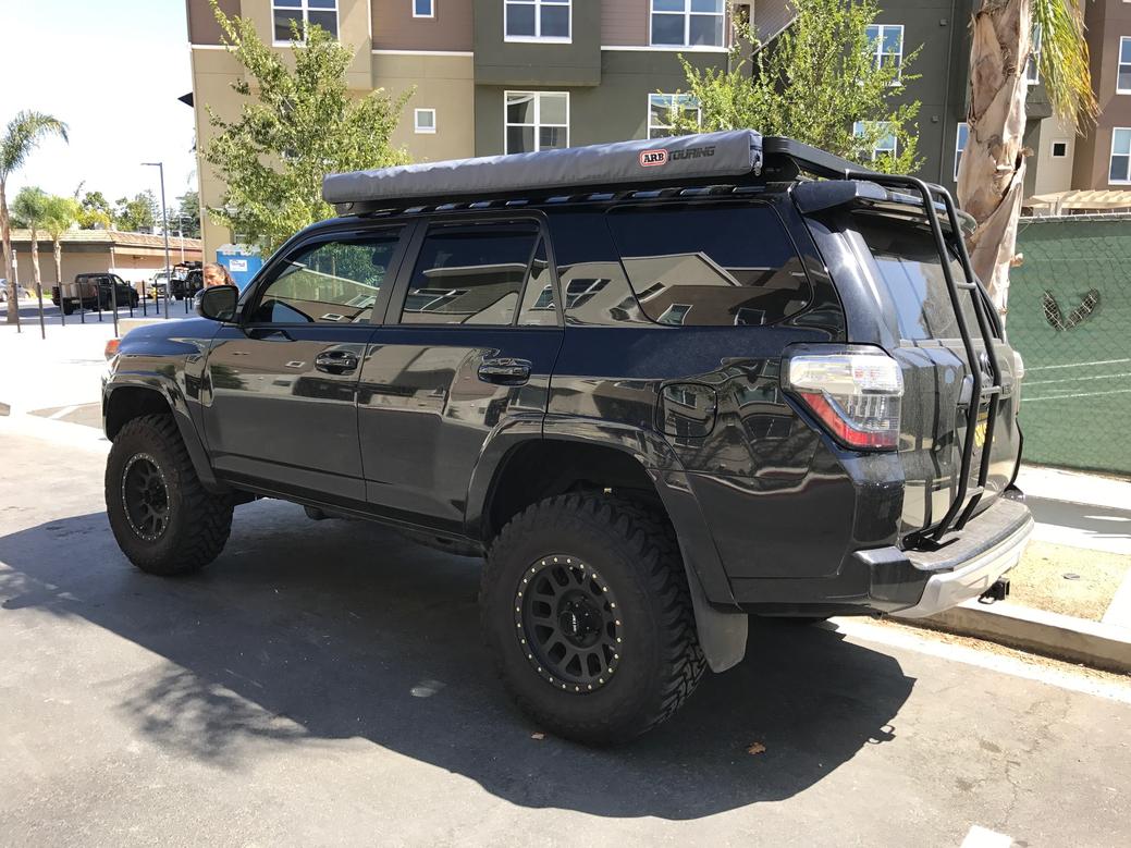

ARB Awning - I wanted an ARB awning to provide a little bit of shelter and shade when camping and going on trips, so I decided to go with the 2000 opposed to the 2500. It provides a good amount of shade and sits flush with the roof rack (lengthwise.)

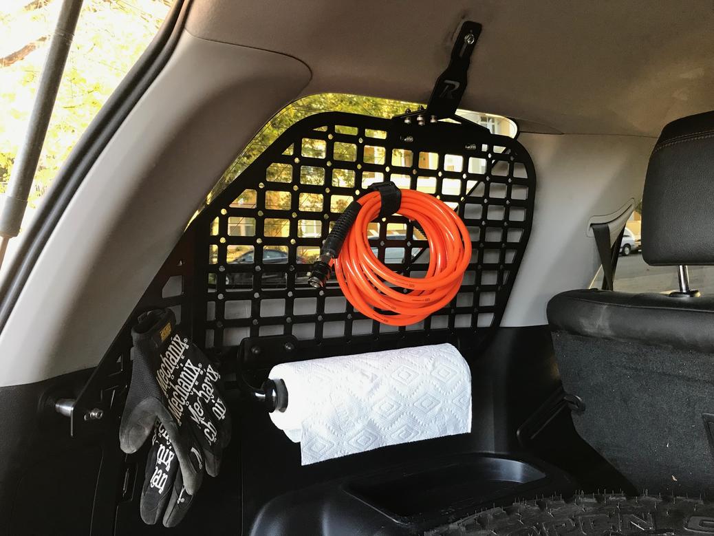

Rago Fabrication Modular Storage Panel - I snagged a good deal from the folks at Rago Fabrication during one of their garage sales, and added their modular storage panel for my drivers side. The idea behind just one side was to leave as much visibility over my shoulder in the passenger's blind spot. Install was extremely easy and so far I've found it useful in holding a few different things.

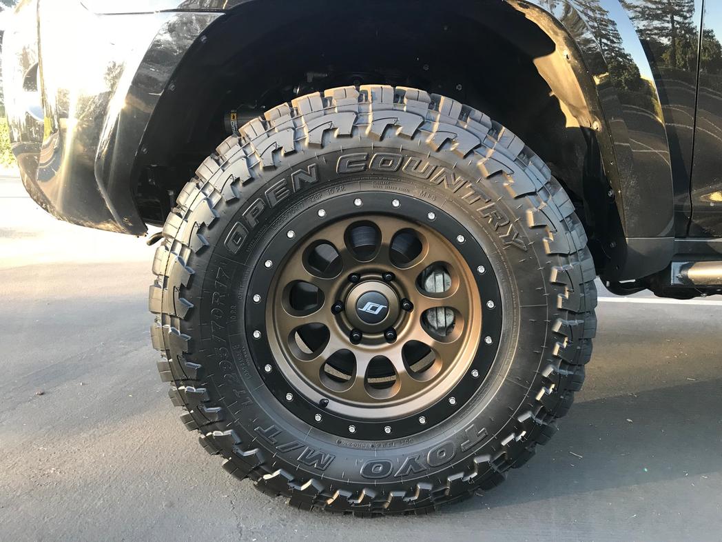

Stealth Custom Series Ray10's 17x8.5 - I loved my Methods, but bronze Ray10's have been a long time want for me. The opportunity presented itself for me to snag a set and I took advantage - I love the look and the offset provides a little bit wider stance, which I like since I'm not running spacers currently.

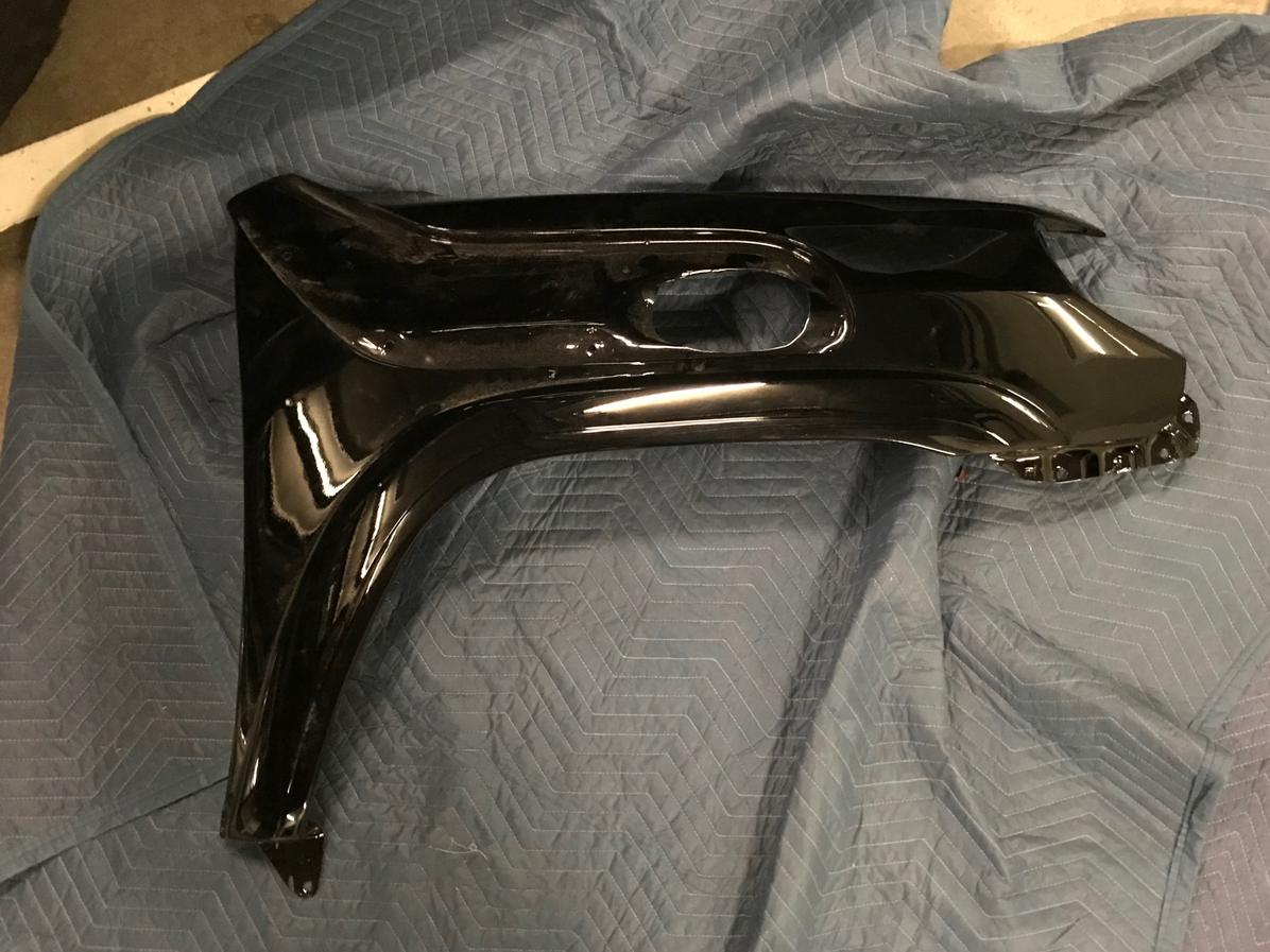

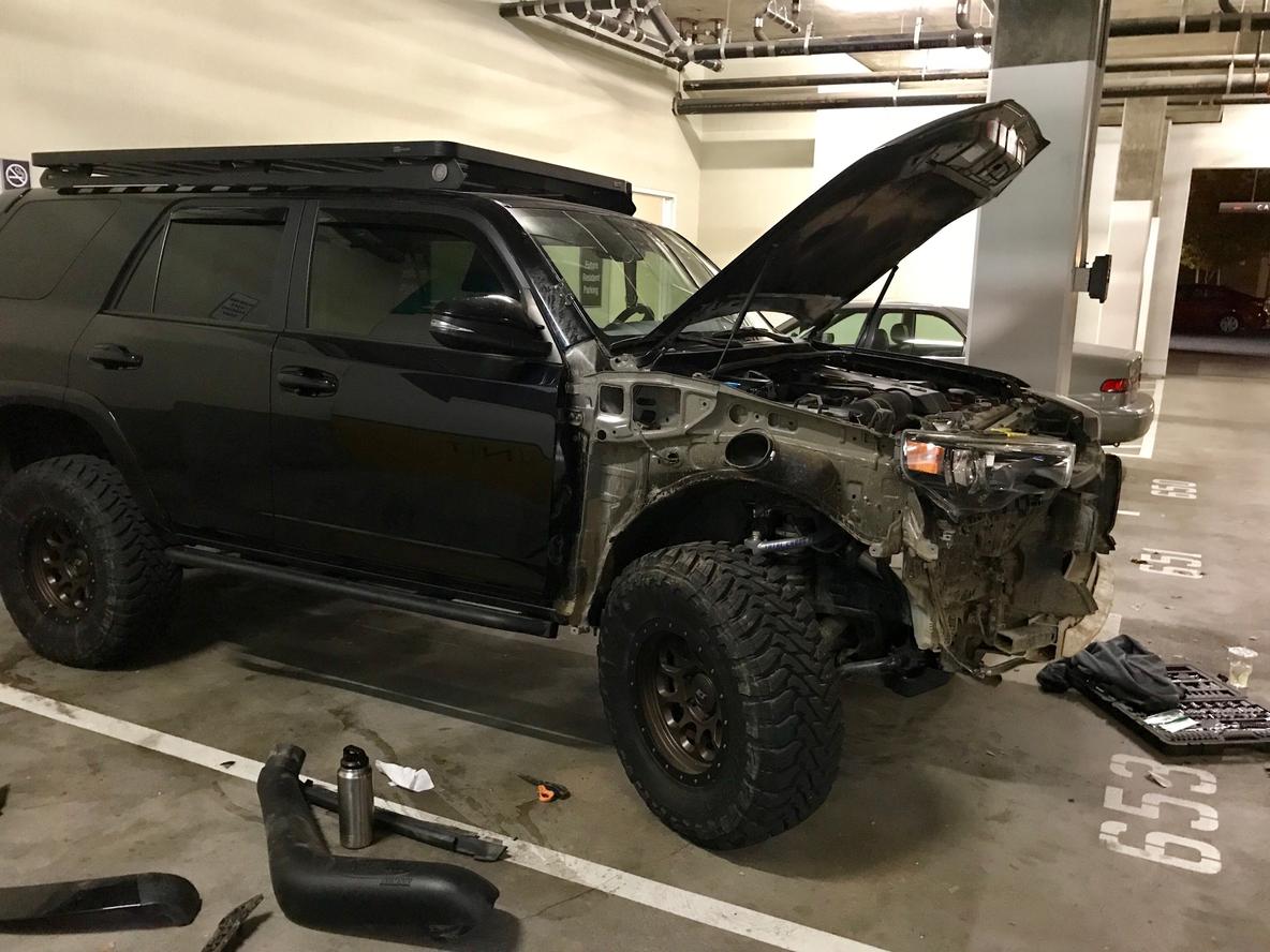

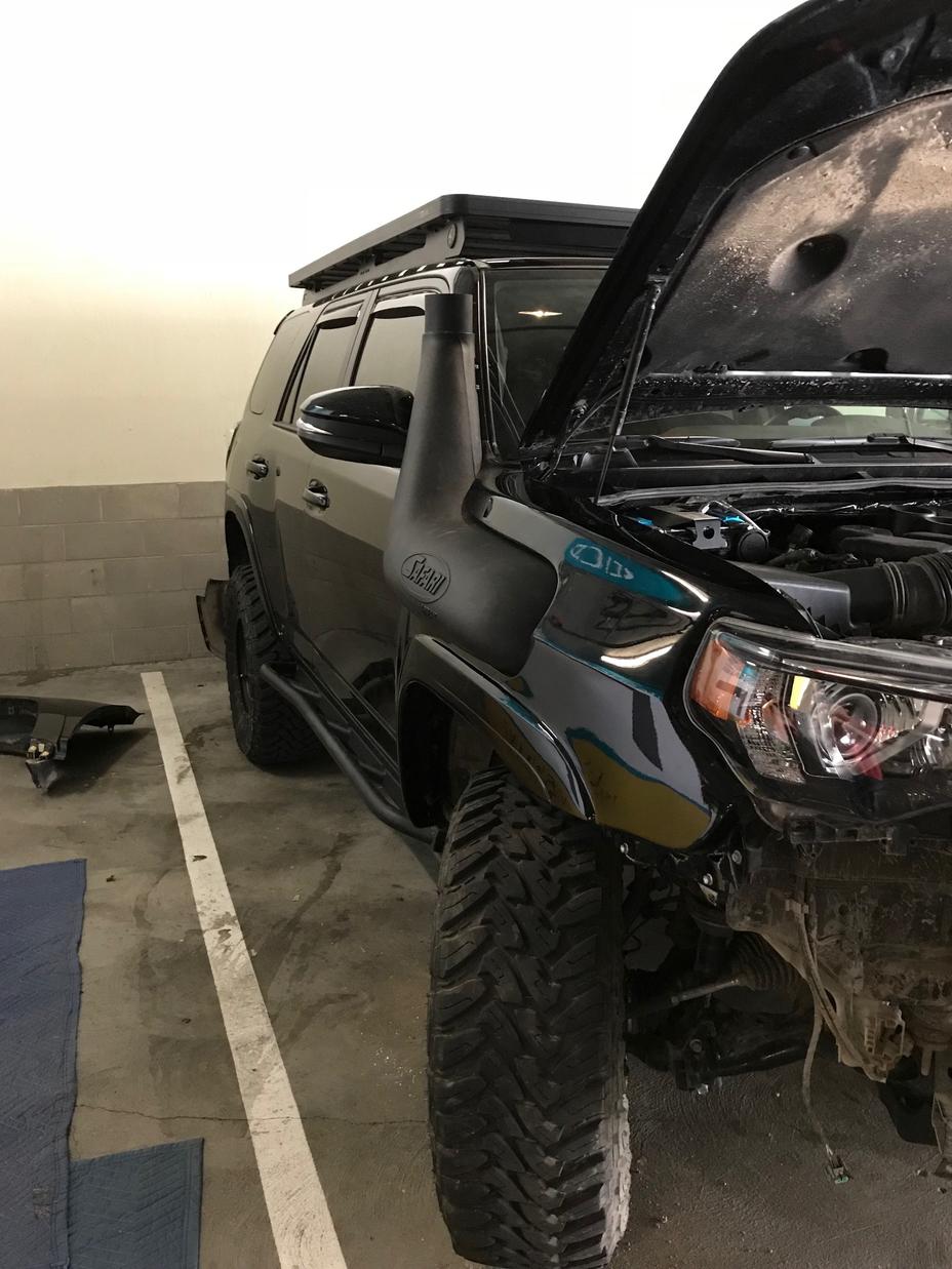

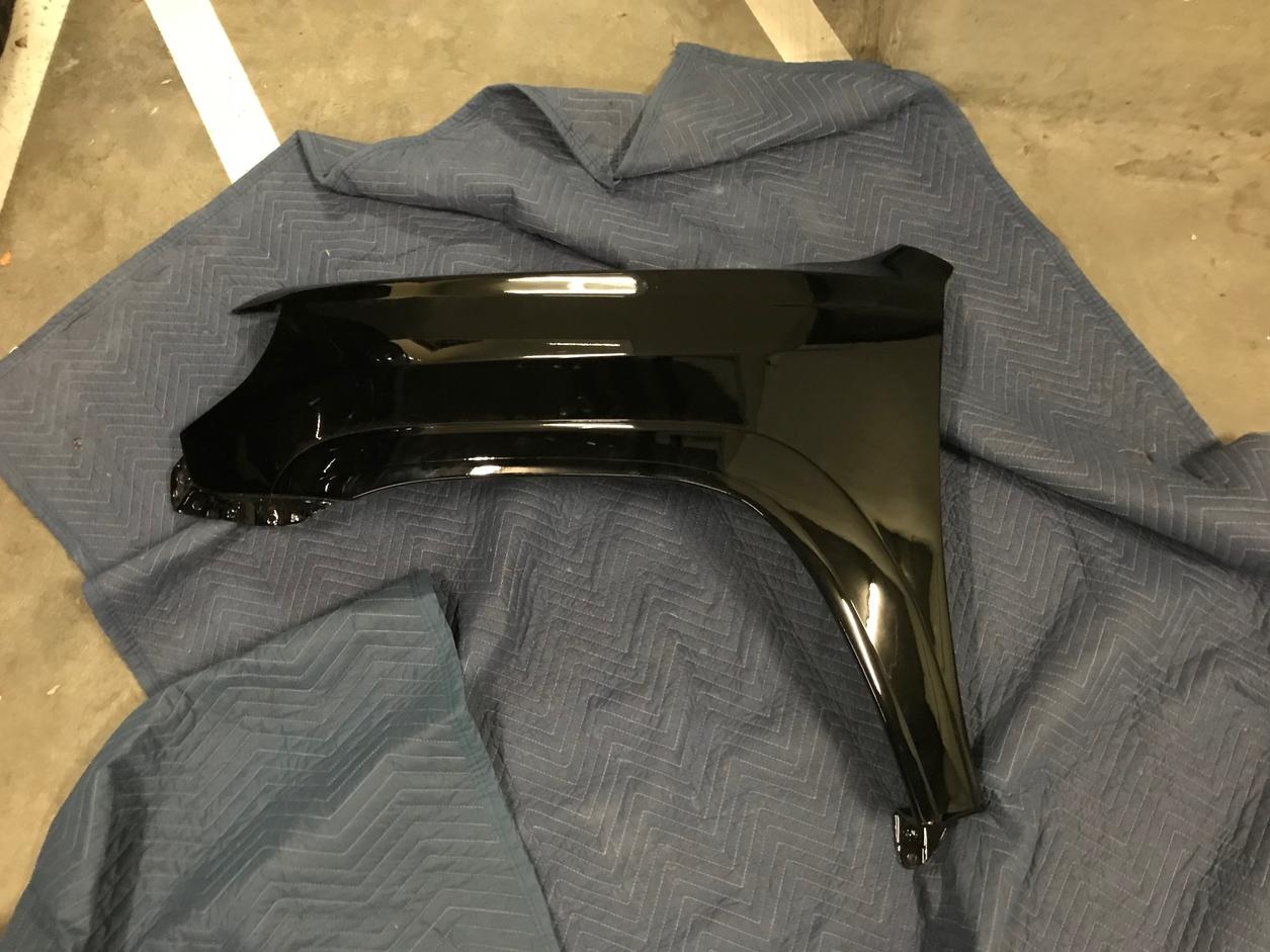

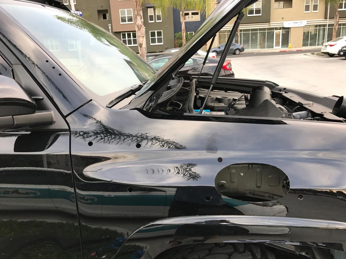

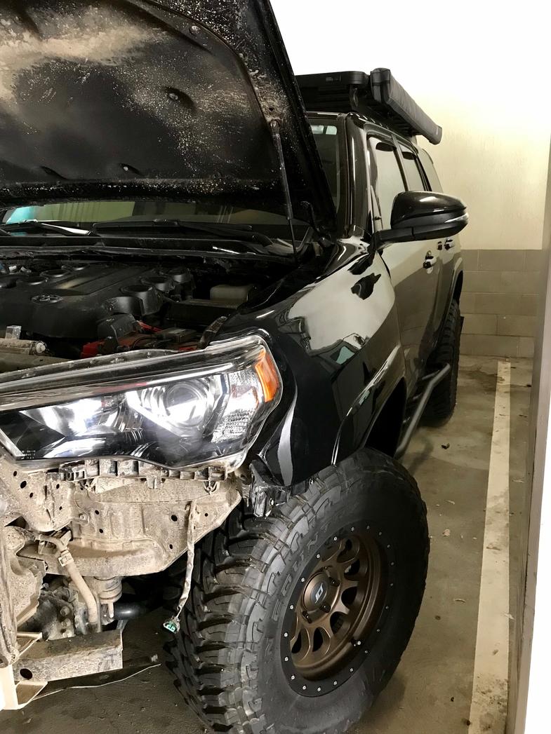

McQueen Prototype Designs Fiberglass Fenders
I owe @weeee a big thank you for not only helping in the design of these fenders for our 5th gen 4Runners, but for driving my set back up to the bay from LA and helping me with the install - I would have been in the garage for a few hours longer without his help. I'm currently running 295's and fitment is snug with a bit of rub against the factory fender liner when at full lock in reverse, and as you might expect there's quite a bit more rubbing when on the trail and articulation becomes a factor. While I don't intend to baja race my 4Runner, I wanted to have some extra room in the front for peace of mind when wheeling, and to free up some space to go up in tire size as well.
The McQueen Fiberglass fenders provide 3" of additional clearance and are compatible with the ARB snorkel.
The fenders fit snug and are extremely well made, not to mention look nearly factory at first glance.

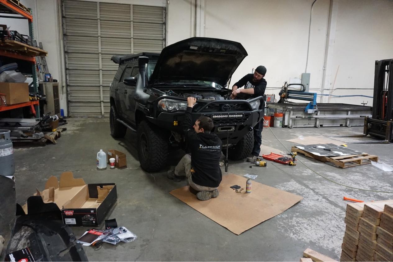

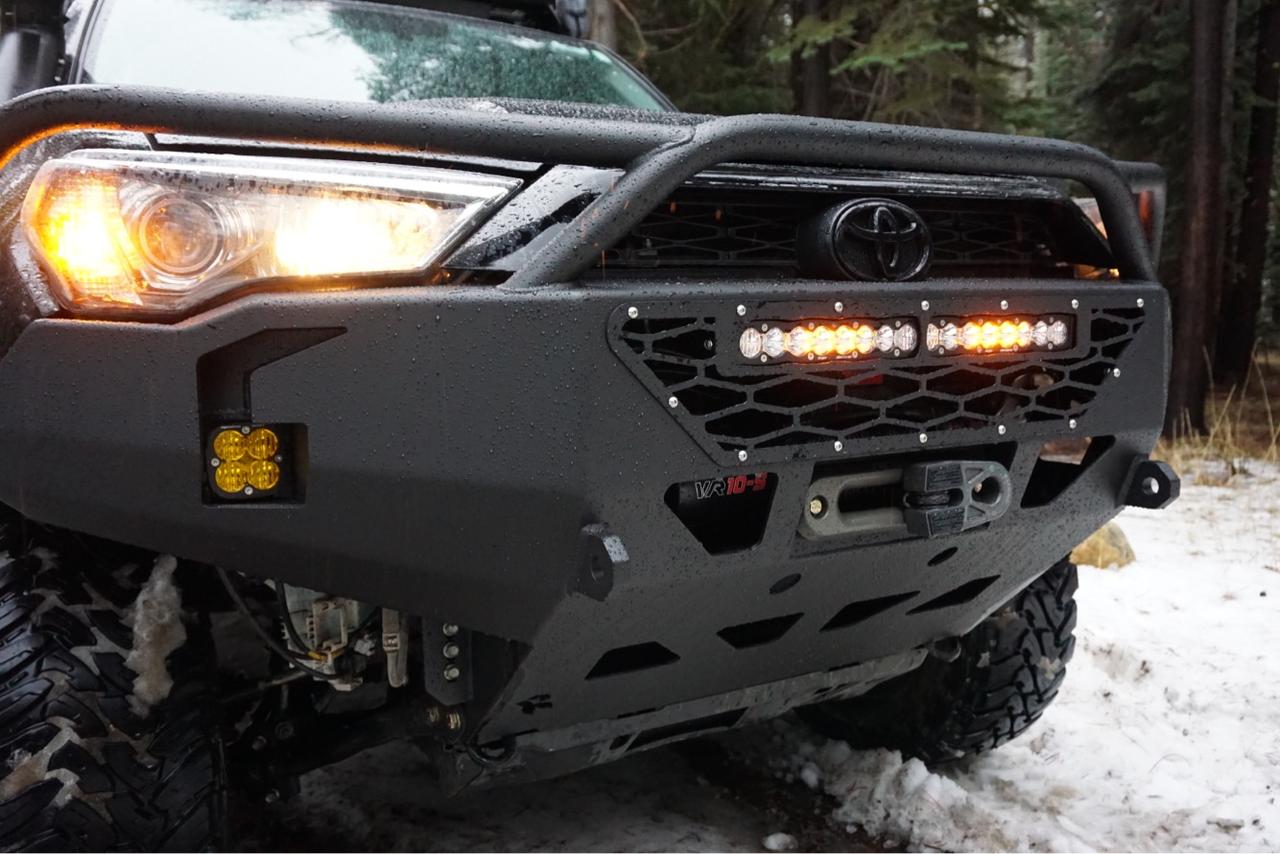

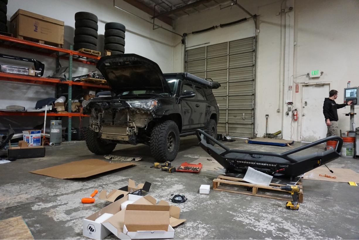

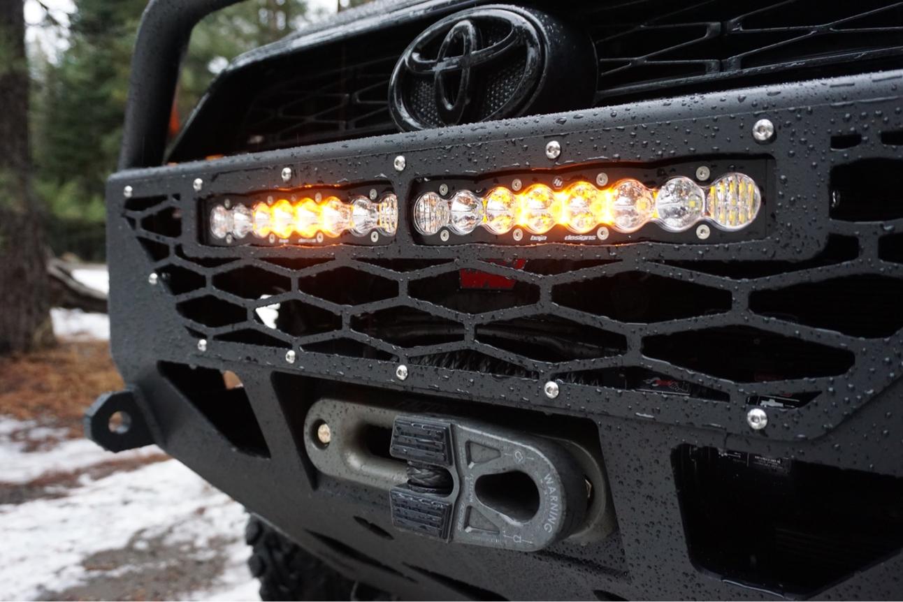

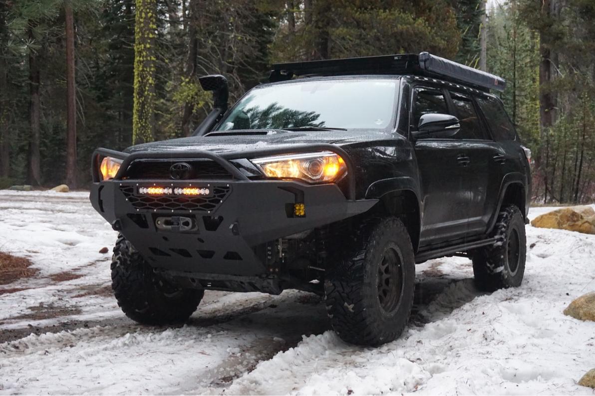

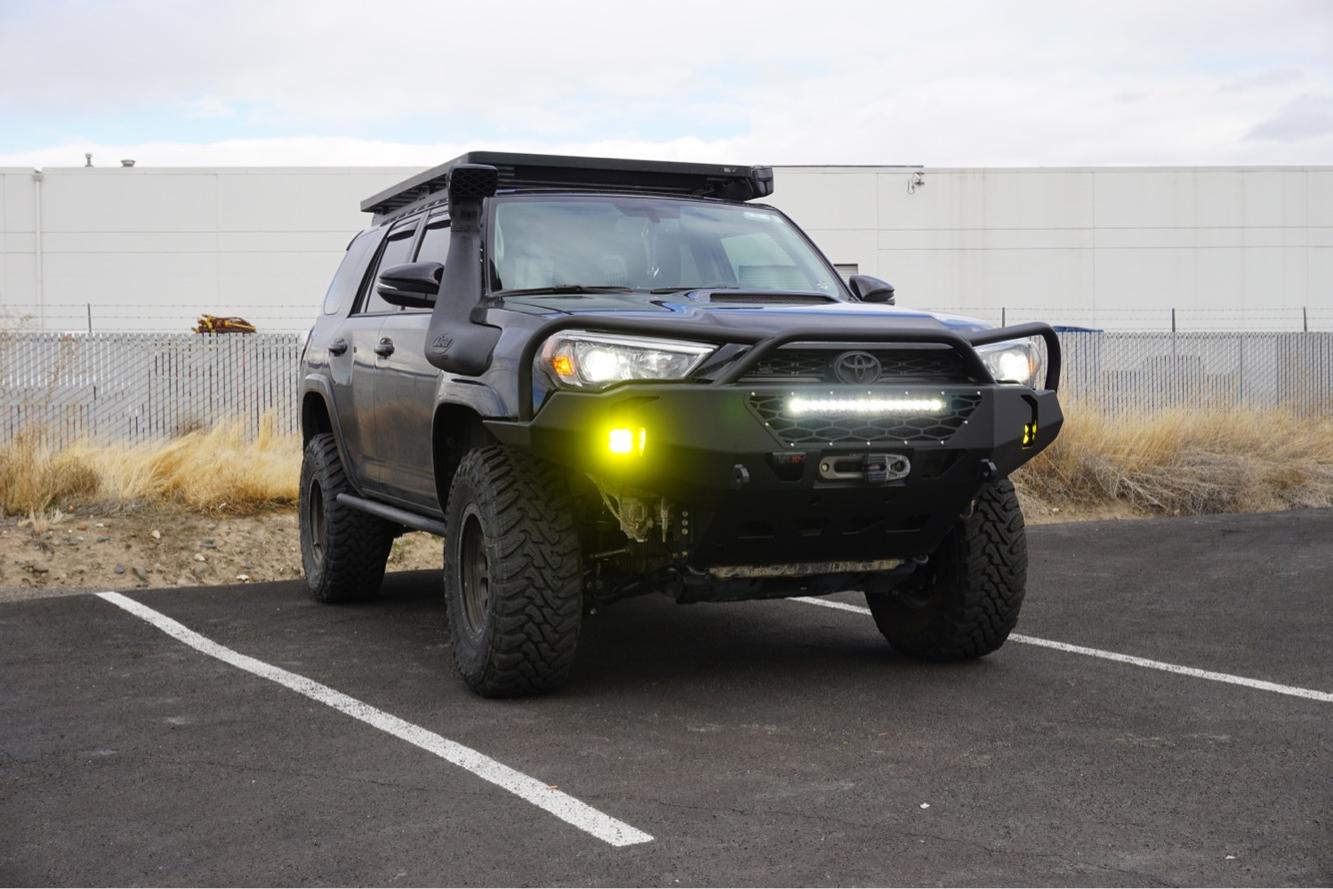

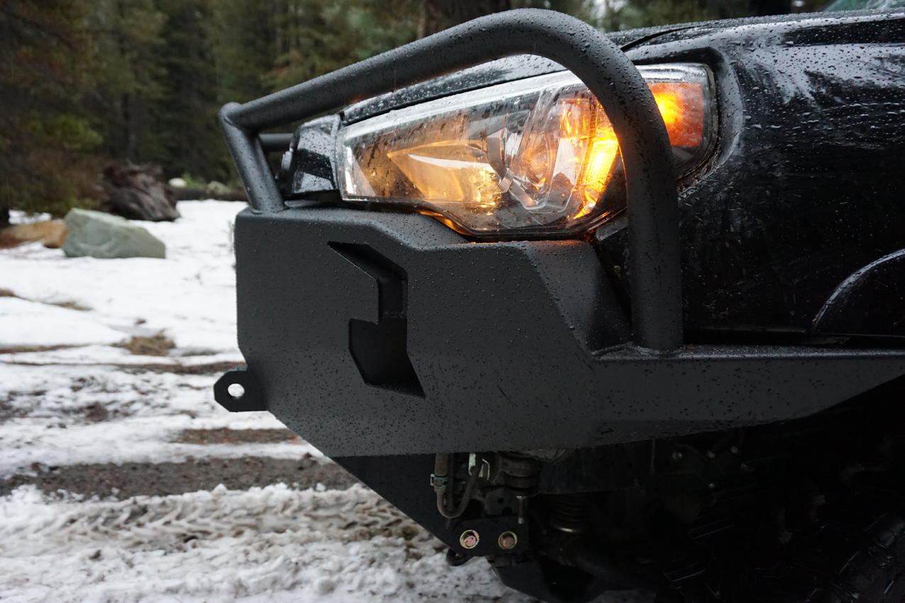

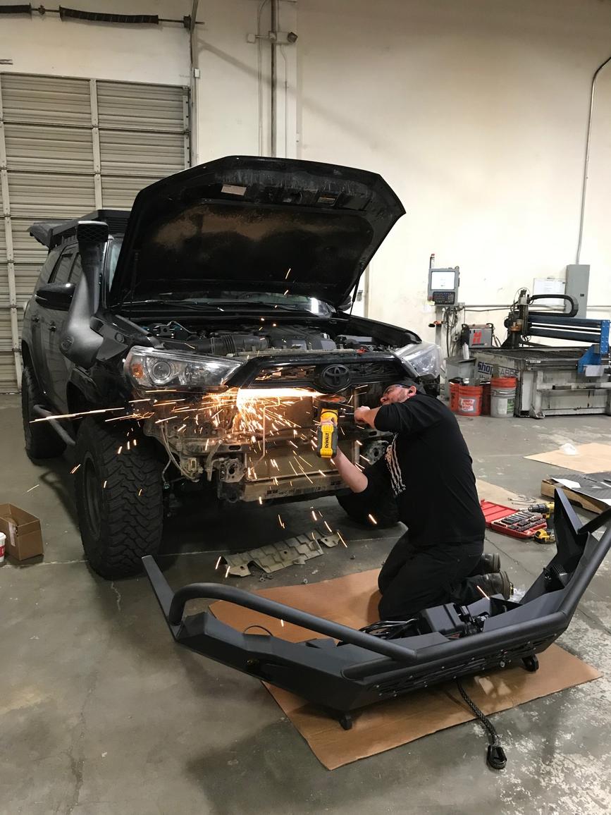

Relentless Fabrication Predator Bumper
To complete the front end makeover I went with Relentless Fabrication's new Predator bumper. It's a full replacement bumper and is full steel which I wanted for strength while winching. Shrockworks and CBI were also of interest to me and I had actually initially planned to pick up @weeee's Shrockworks bumper, but managed to squeak in Relentless' pre order group just in time. My biggest concern with the bumper was the amount of space between the fender and the hoops on their bumper, since the hoops are mounted right where the fenders begin to bulge. Knowing there might need to be some troubleshooting to accommodate the fenders, I took Friday to drive to their shop in Reno to get it installed. Fitment with the fenders ended up being seamless as if they were made to be a perfect match. I can't say enough about how awesome Eric and Brittany are, and how top notch Relentless' craftsmanship is.
To go in the bumper I chose Amber BD Squadron Sports Wide Cornering, a BD Driving/Combo S8 lightbar, Warn VR-10s winch with wireless controller, and Factor 55 Fairlead as well as Flatlink E.

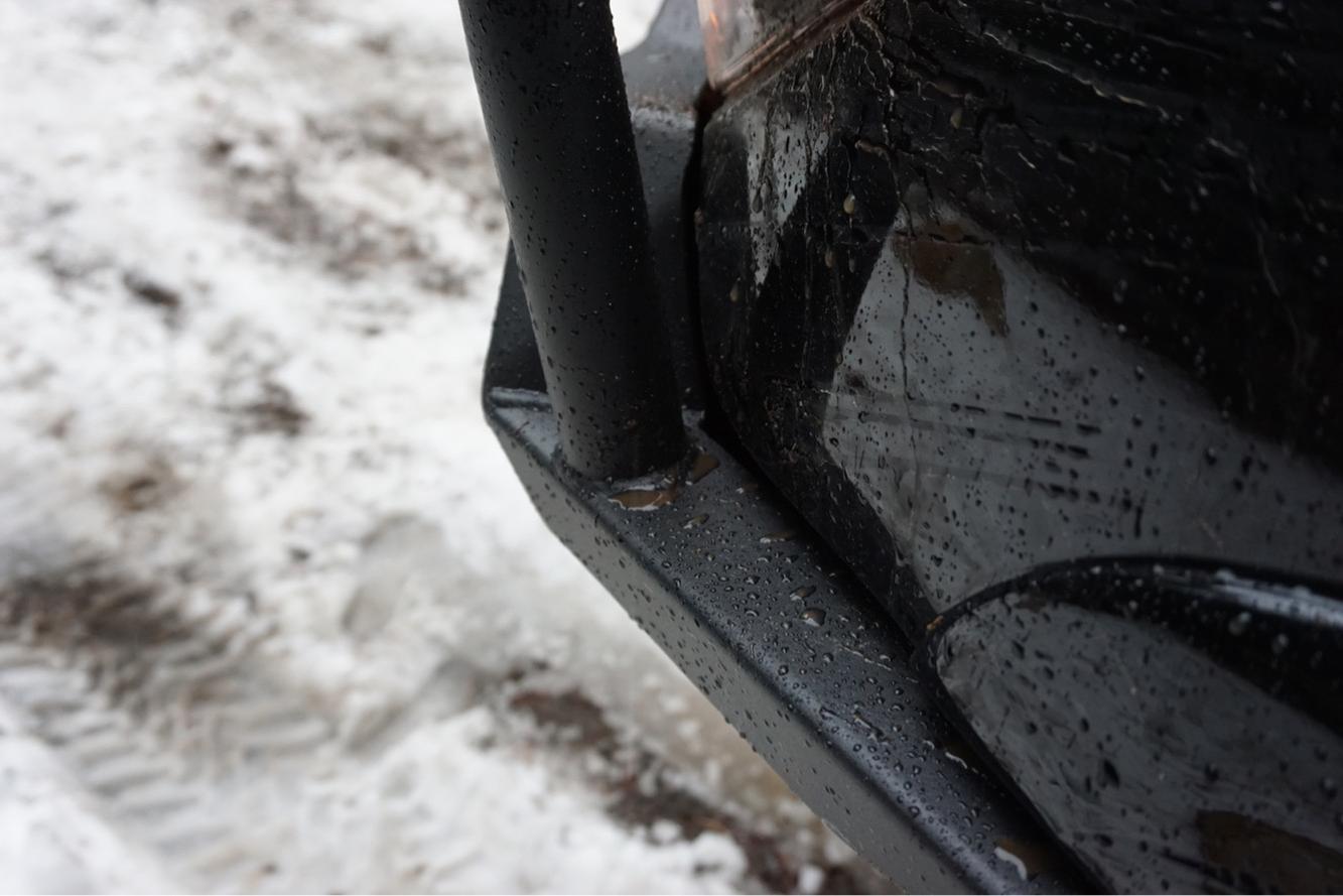

After the install, I decided to hit a few trails in Tahoe National Forest. With weather becoming increasingly inclement and a good bit of ice on most of the fire roads, I didn't stay for long but had a good time and got some more shots of the bumper in the wild.
The original area of concern I had with the fender bulge being in the way of the hoops. Perfect fit!
