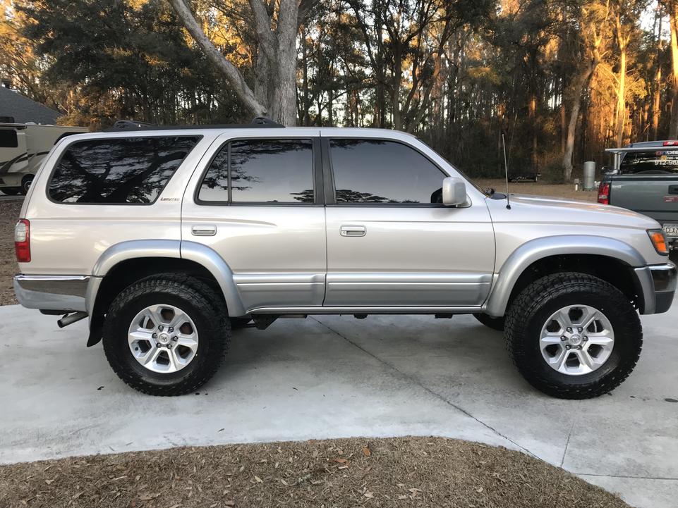

I went with the Toytec/Bilstein 3" lift from Toytec. Pretty affordable and gives a good ride. Clears my 285/70r17 Duratracs which only rub when rear driver tire is fully stuffed.

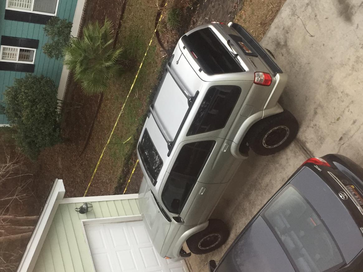

2" lift
This is my set-up: Bought the lift components from MRT. Chas is great. This gave me appx 2" of lift.
Bilstein B8 6112 Front coilovers (47-258624)
Bilstein 5100 rear shocks (24-249966)
OME coil springs - rear (2906)
Falken AT3W 285-70R17's. I don't do much off-roading but this set-up suits me just fine. As you can see, this is a limited. The left front tire rubs the fender flare just a little. Rides great. I love the tires, too. No road noise. Hope this helps with you decision making.

I'm thinking of the same exact setup. What setting are you on for the 6112 front coilovers and are you using any rear trim packers? Tia
I used the highest setting, as suggested by Chas. Installed the rear springs and shocks and nothing else. Rides really good. The drivers front tire rubs a little when turning right but nothing to worry about. Good luck. I just bought another 4runner. 2000 SR5 with 189,000 miles. Great shape, no rust and the body is nearly perfect. I am going to order the same lift components.

Did you have Chas assemble the 6112 front coilovers? I'm thinking of having them do it to make the installation easier. Thanks
I did not. I had them sent straight to the shop. Didn't have time to take on the install. I will have them do it this time, however. I gonna try to tackle this install myself. Good luck.

I jusr picked up a 2000 with the Sonoran 1.2 kit a 2” body lift (not usually a fan of that) and 285/70/17. Only driven it once since I got it because it needed both wheel bearings replaced but even then the ride quality was really nice.
