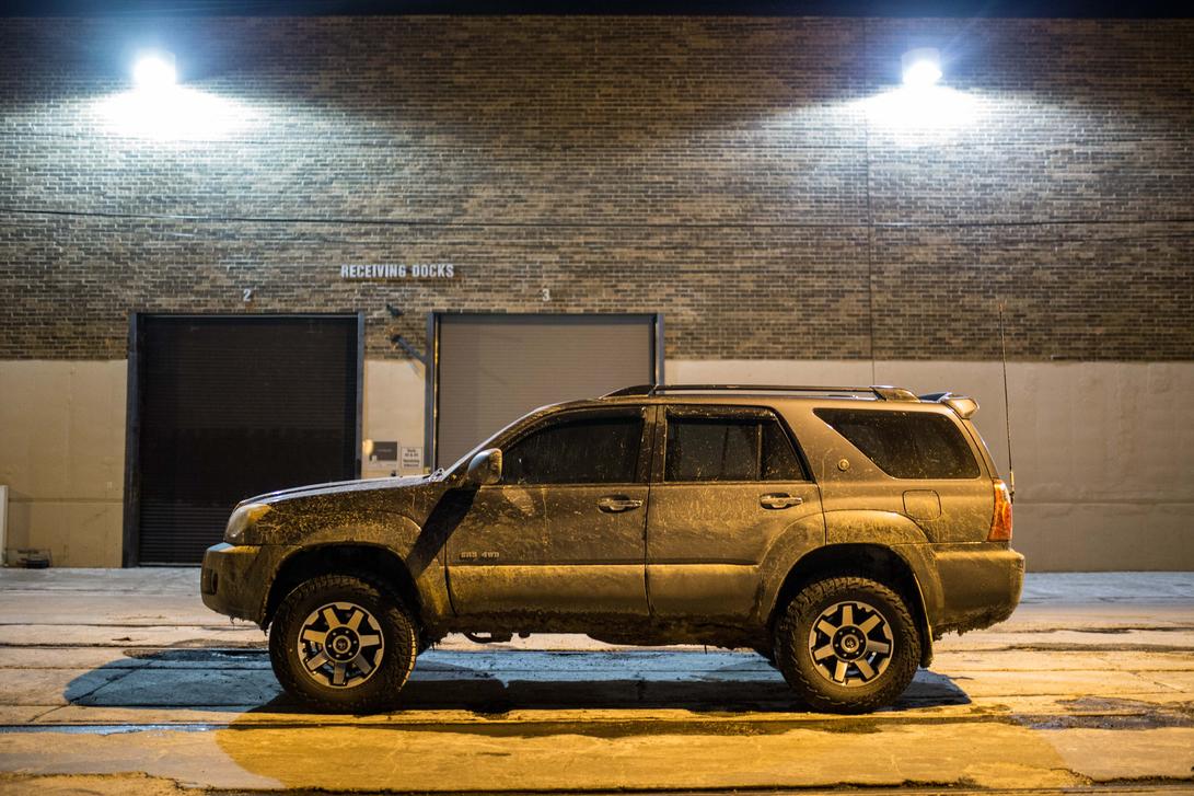

I just had my 6112's installed with 5100/OME 895e's in the rear. Debating on going in and lowering the fronts a notch or two or to swap the 895e for 895 medium springs. Kinda want some of the rake back.

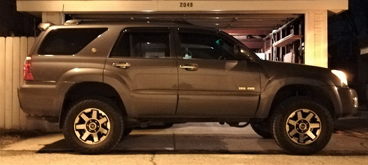

On another note, I lowered my 6112's to the 4th notch to bring the front down a bit. Sits perfect to my preferences. Sorry for the potato pic, I'll get better ones when I have my DSLR on hand
