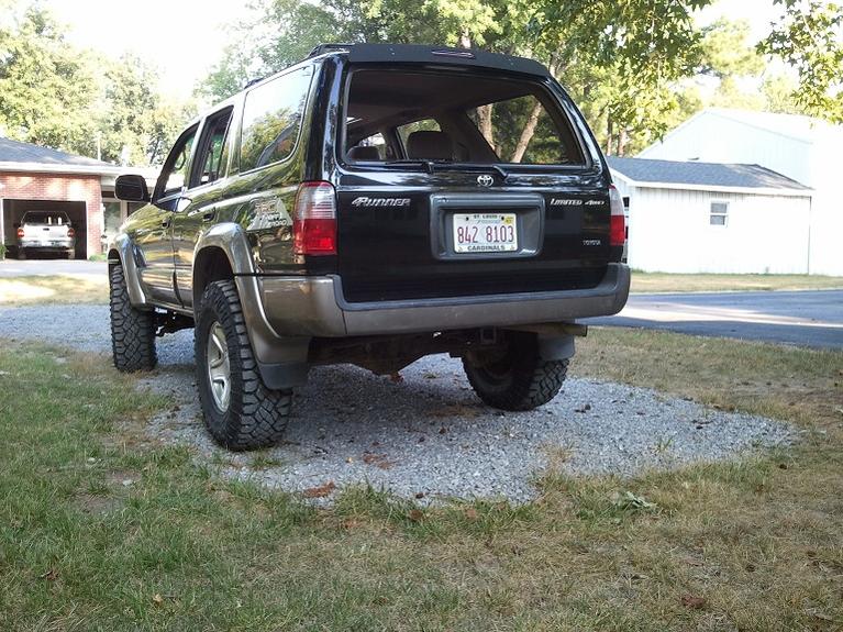

So considering you are the king of mods, I have a suggestion for you to do. This Mod is not my idea but a mod of one of my buddies and his rigs that I look up to and get ideas from. I think that you will really like the idea and hopefully try it. but once again I can't take the credit. It has to do with the rear hitch. One of my complaints has always been how toyota just threw on the hitch almost as an afterthoght. So after trying to think of ideas how to create a better looking and more clearence in the rear without getting a new bumper, i Saw my buddies rig who did this and thought it was easy yet genious. All it consists of is flipping the rear hitch steel bar (3 bolts on each side). Then you will have to cut part of the rear bumper just enough to fit the hitch and two tow hooks. Then put some door trim or rubber trim over what you cut. Then you can flip the hitch and screw the 6 bolts back in. I will try to find some pictures if I can because I know it will help tremendously with the explanation.

Multiple people including myself have done this.

yea, I like this idea, but I have the welded hitch so not as easy for me to pull off
[MENTION=50784]Full_Throttle[/MENTION] did something similar which looks even cleaner imo.
