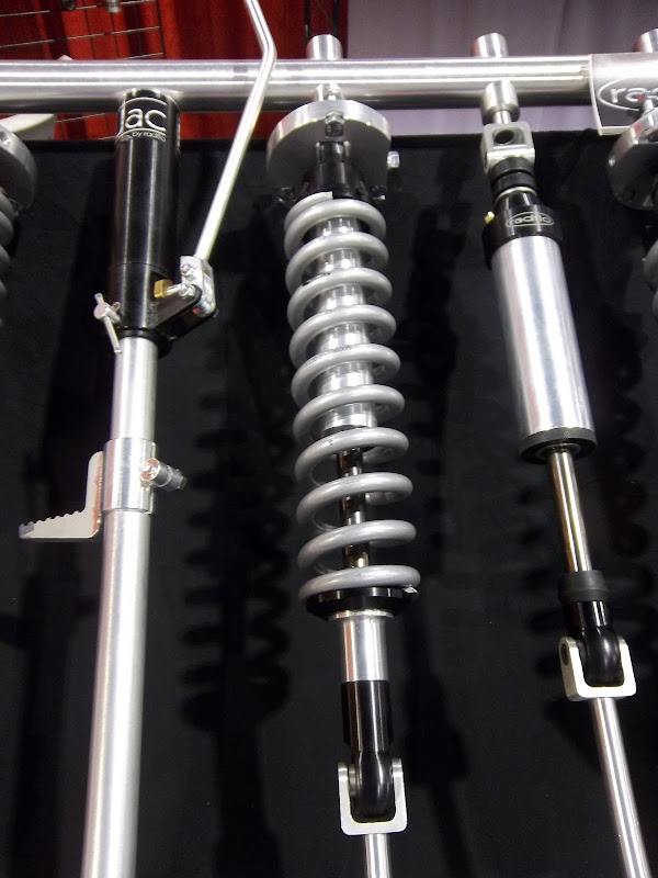

I stopped by their booth at SEMA and have to say that I was impressed with their products. They didn't spend a boat load of cash on a vehicle to display, or a chick in a bikini. They jammed as much product as they could display for the area they had. I've seen them on the various online forums I frequent, there are also quite a few reviews with positive comments about your offerings, quality, product line, and price point. I've seen a few with complains of squeaking noises, which I wouldn't be surprised to find on a coilover.
Their display:
I'm tempted to order a pair of their rear 2.0 setup to try them out. Although at today's prices it is only $140 more to get the 2.5s, which would be comparable to an external reservoir 2.0... but add $200 and you would have Icon rears, which are trusted and known.
I sent a follow up email to get dimensions on them. I forgot to ask if they were a floating piston or emulsion style, and whether the valving was basic or digressive. I guess that's for the third email...
I'm interested on what you dig up from Radflo. I'm in the process of educating myself on shock technology and valving. You wouldn't happen to have found out the valving for those rear Bilstein Tundra shocks, did you? Or the OEM LC Tokico valving? I need to find the "most appropriate" valving numbers for our rigs...
