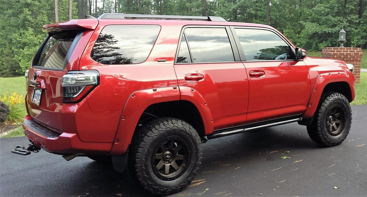

Bushwacker made fenders for the 5th gen!!

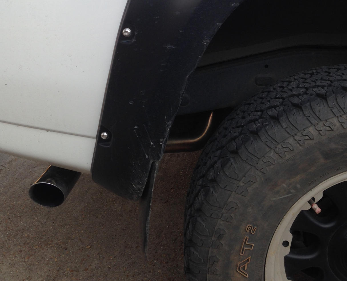

The flares have openings in them for the factory flaps to blend in. They will look kind of incomplete without the factory flaps. You could just trim your flaps to fill in the openings. I only have a rear picture from my install but you can see the opening.

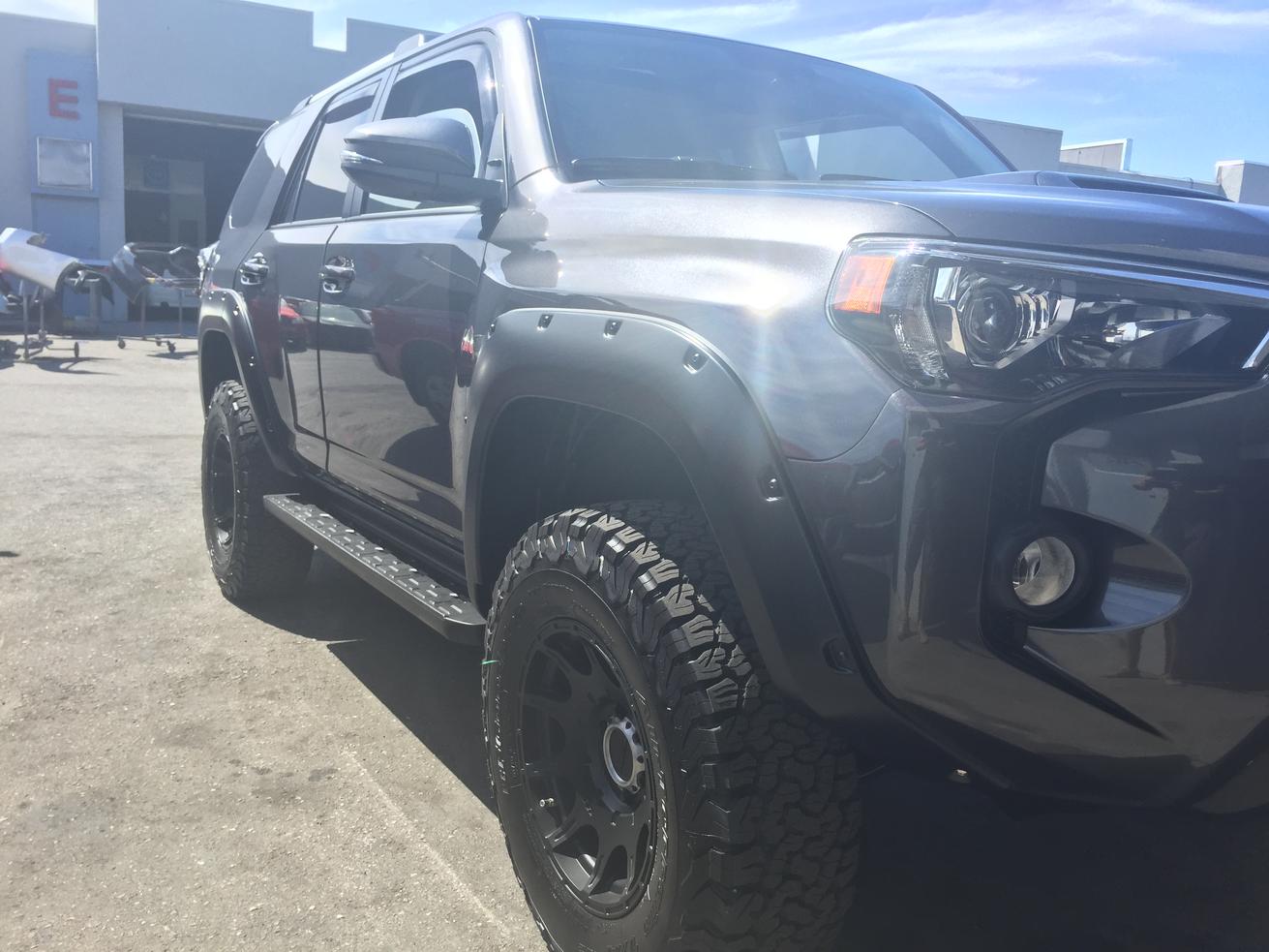

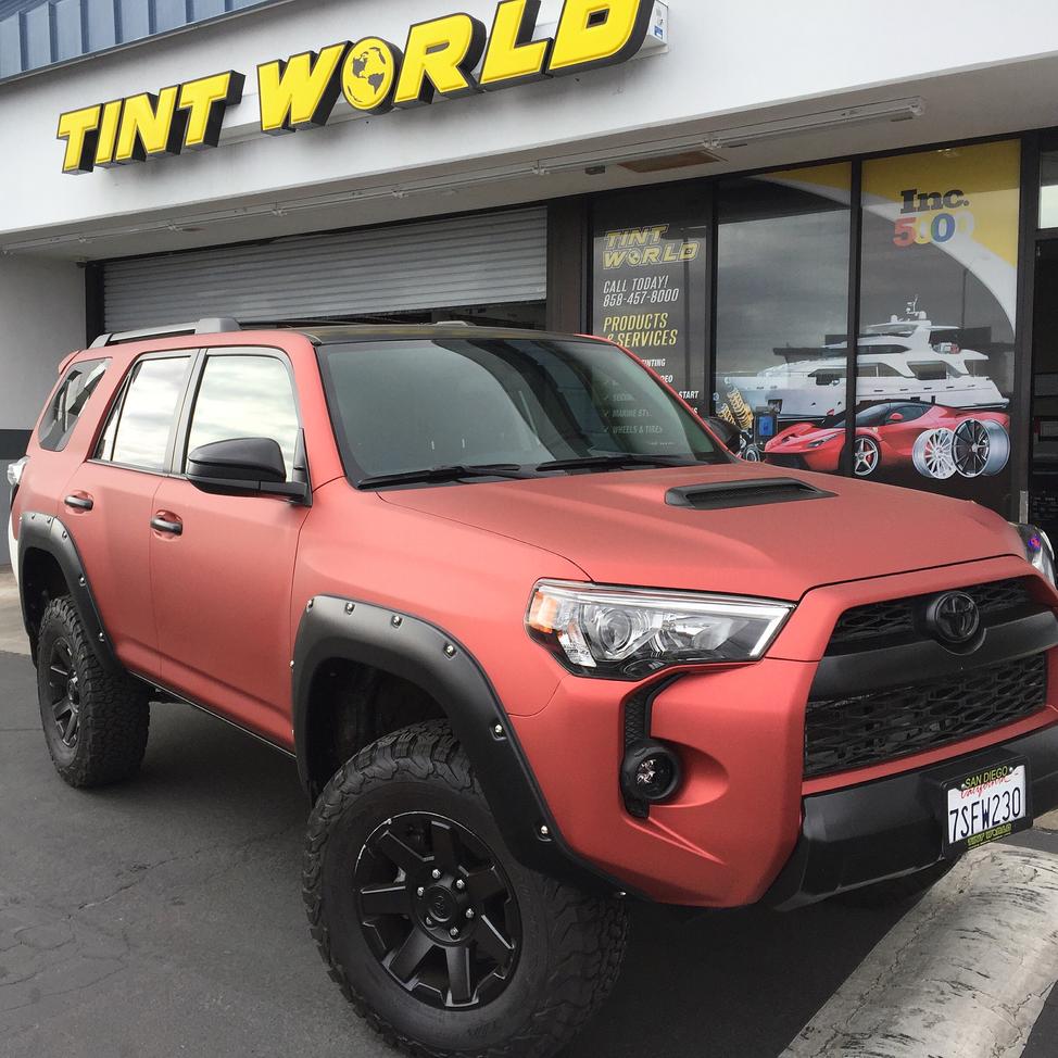

Installed them this weekend. Had to notch out fronts to fit over rockers.
Took me about 2 hours start to finish, not counting washing it down to the OMG White and a couple smoke breaks. I also had to trim a 1 1/4" x 1 1/4" piece out of the front flares to fit over the square tube of the Shrockworks sliders. Knocked right out with a Dremel. Like chudiddy I am running 1.25" spacers, but with 8" wide wheels. Sorry about the pics. I keep forgetting OMG White and clear sunny skies do not make for good pictures!!!

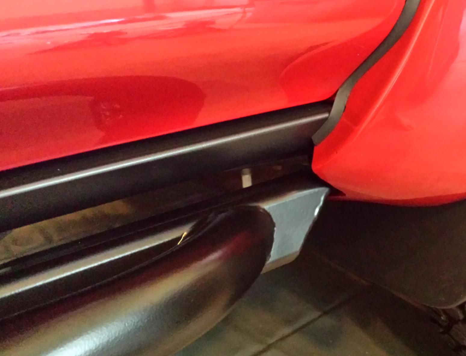

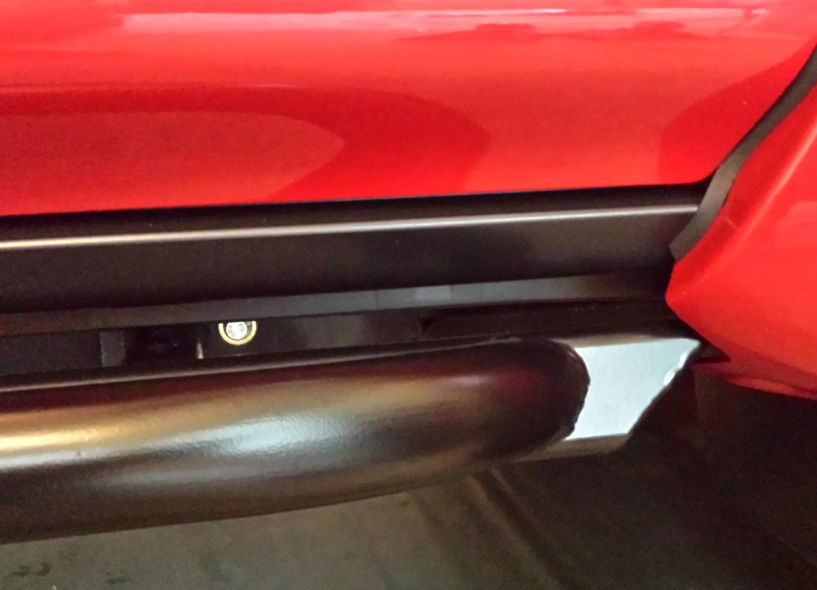

I have OPOR sliders and this is how I trimmed the flares. There was no way they would have fit without doing so. I think it turned out good and looks like they were made that way.
