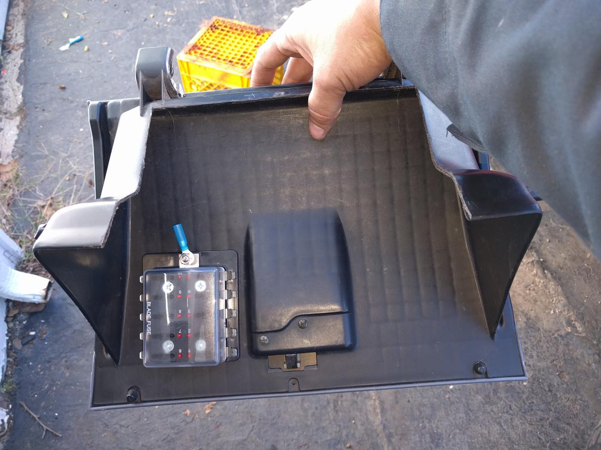

Trimmed out the backside of the glove box so I can mount a fuse block and the MAP ECU 3.

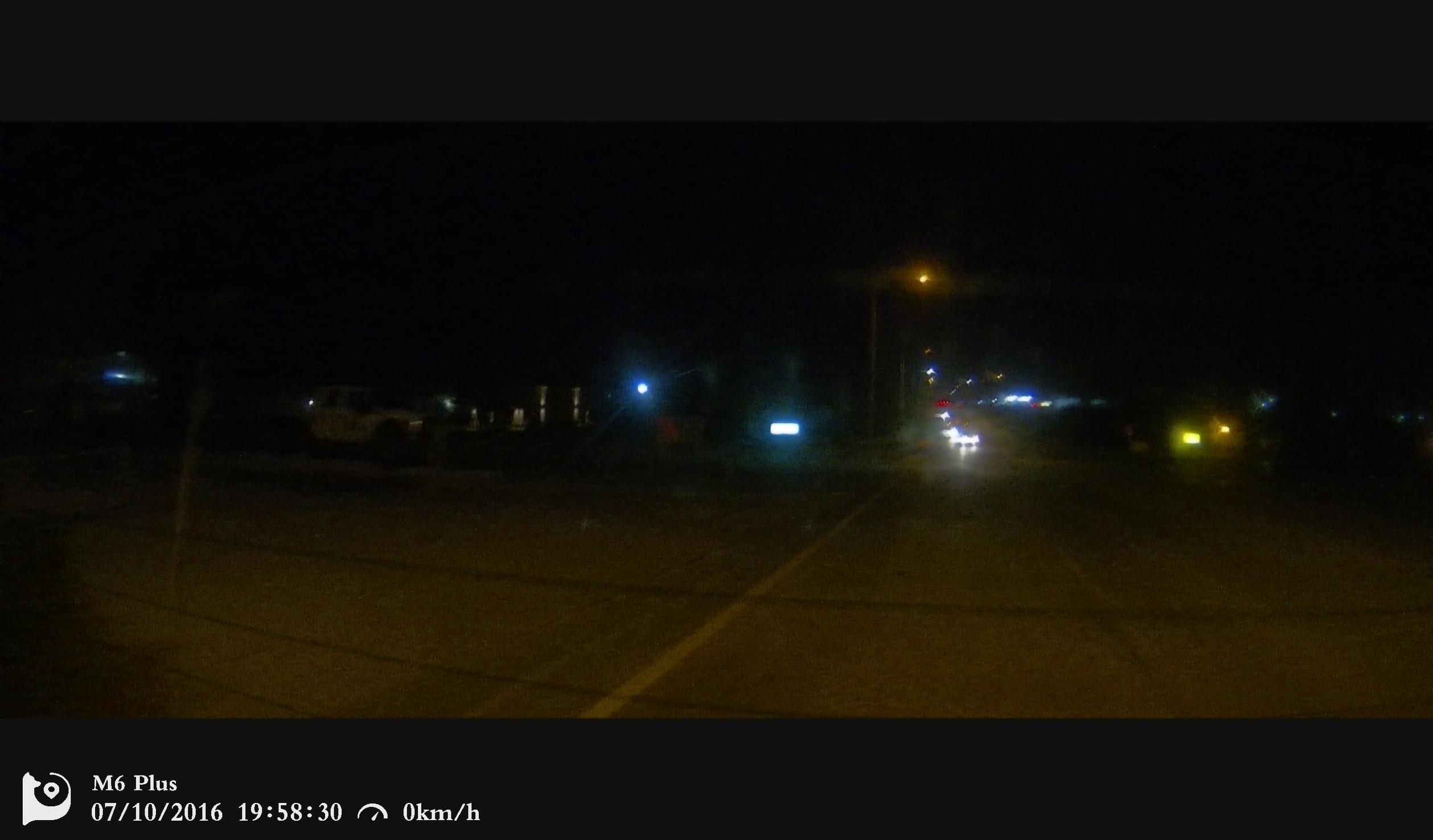

Got the rear camera powered up, now I have to switch it to keyed power.

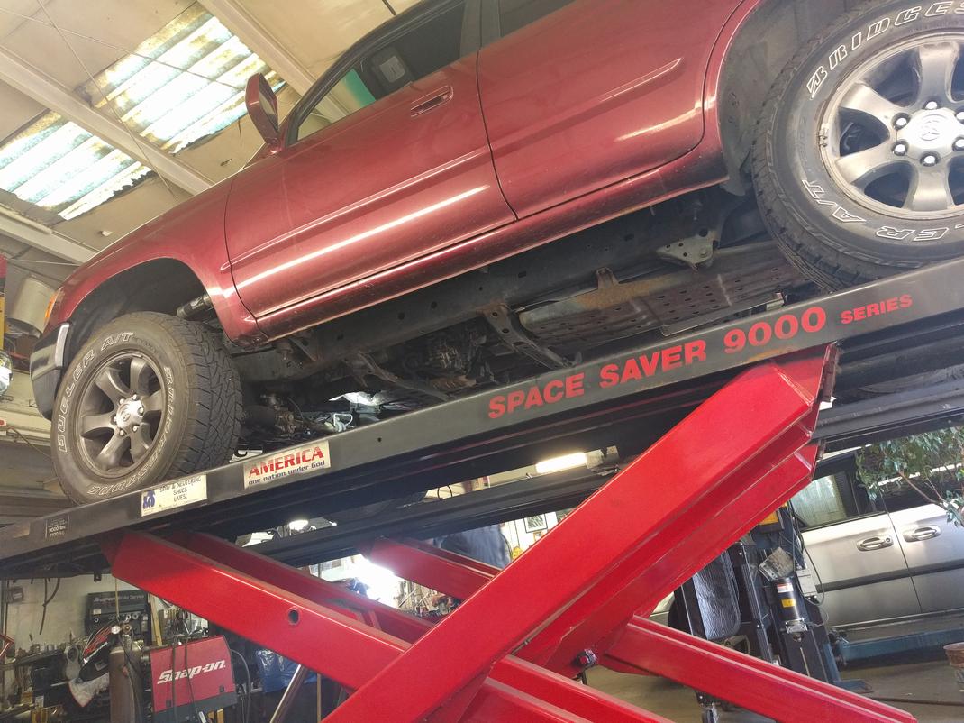

Digging the John Bean alignment lift, it's old, but it's a good one. That one was made at the Wheeltronics plant in Canada, now a warehouse. One more victim of cheap labor in the far east.
