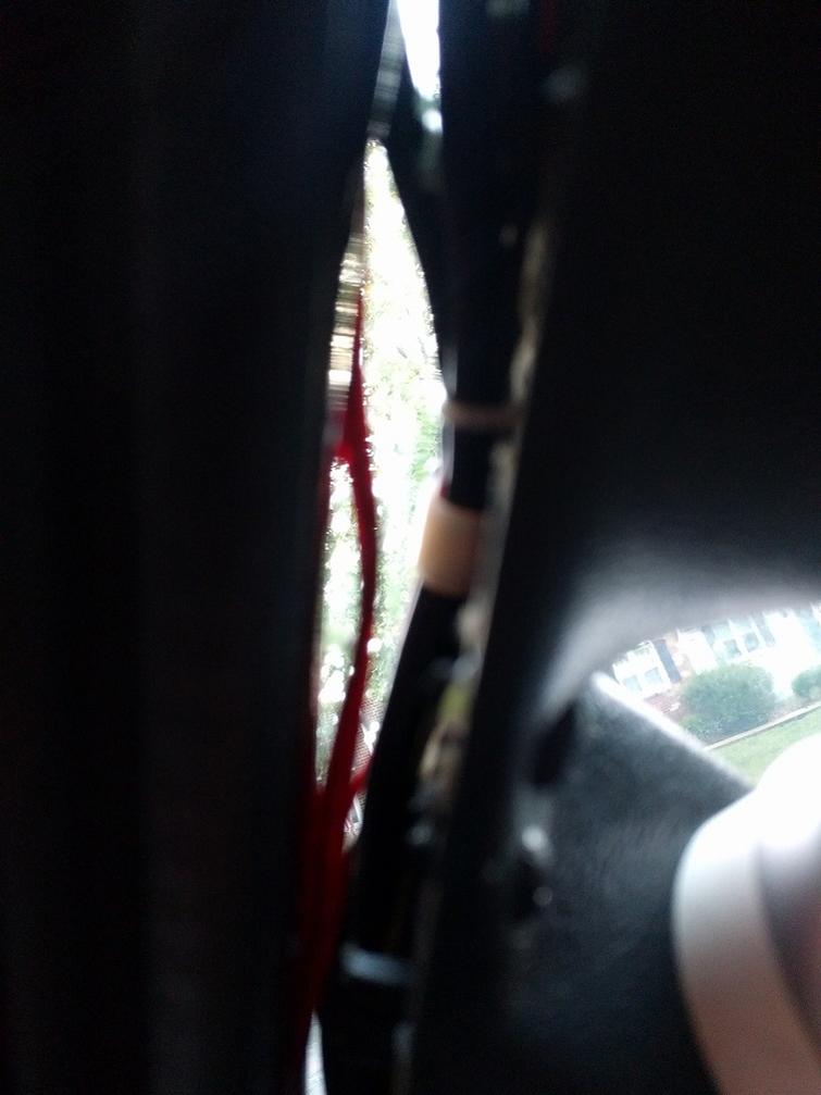

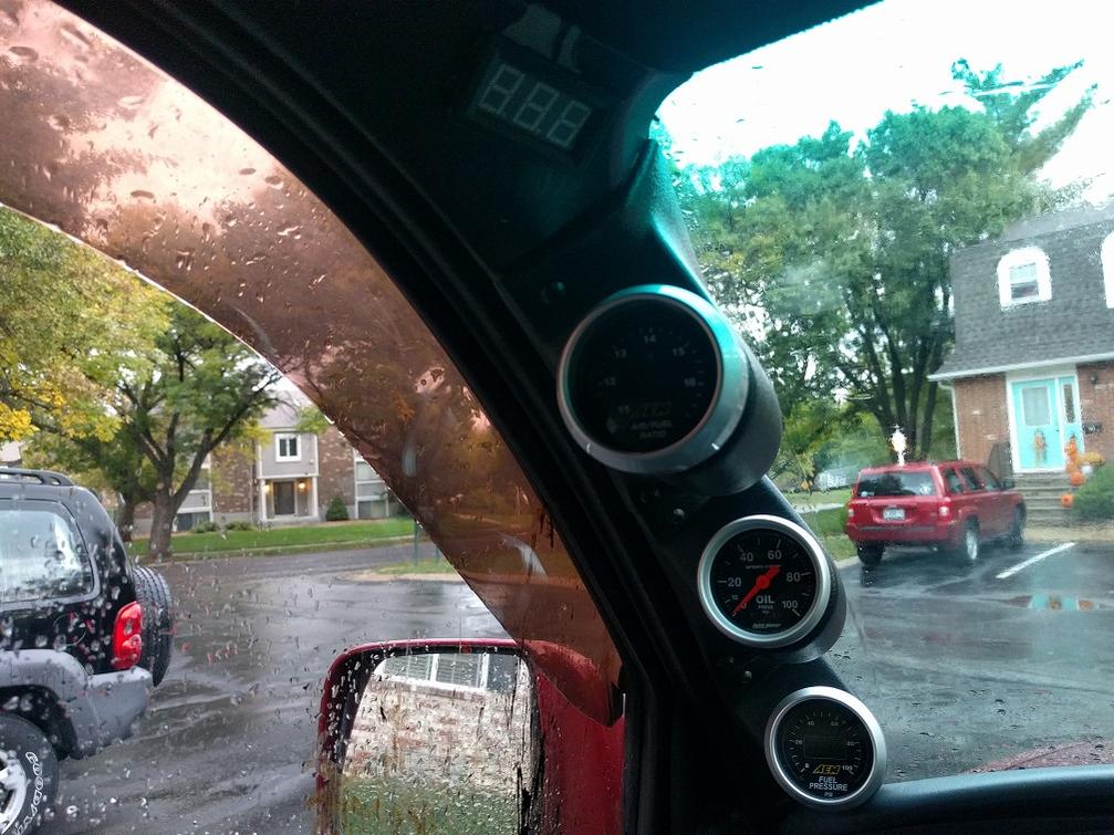

Finally got around to installing the gauge pods and doing some wiring. Had to relocate the 1/0 wire from the main harness grommet going through the wire wall to another hole that I had to drill out and put a grommet in. All gauges are wired up behind the pillar, but still need to do the final connections. All power and grounds are keyed power except for the oil pressure, which will be to lights.
Will need to come back and clean up the voltmeter install, but for now, it's in place.

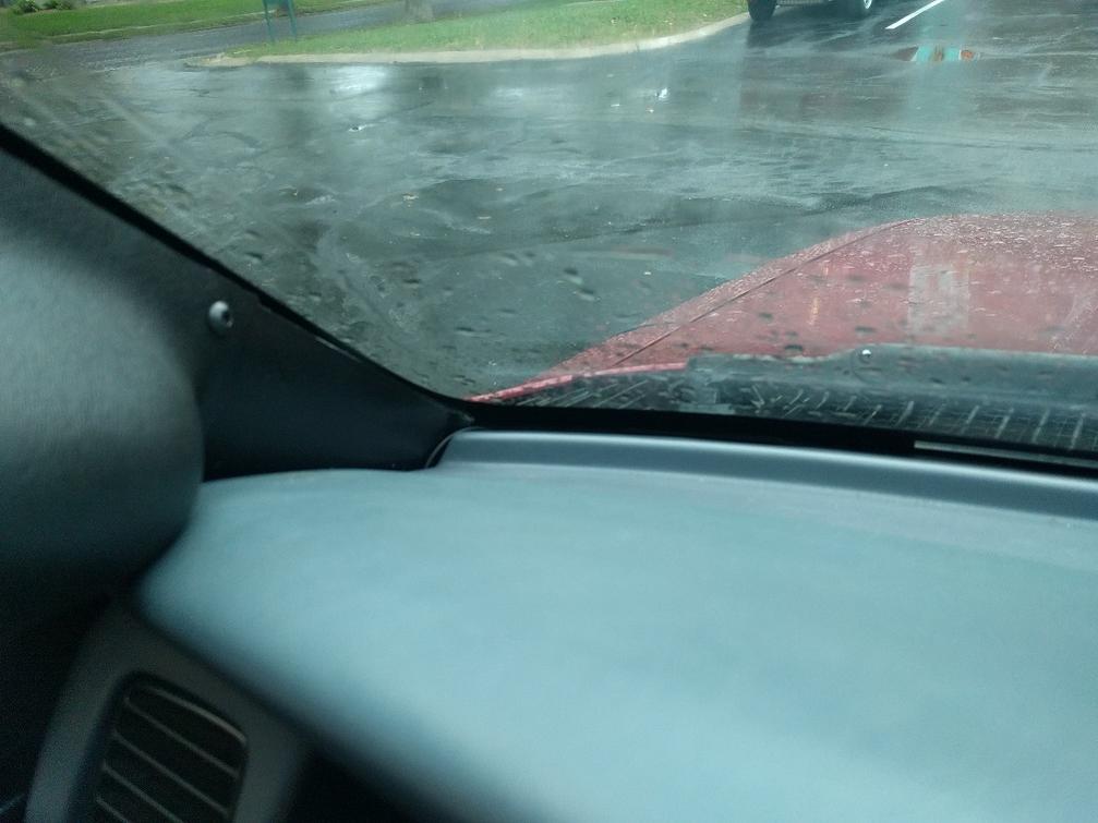

Additional wiring is for the front camera and tucked in microphone for the handsfree.
I won't get around to doing the clean final installation until I can finish powering up the gauges and making sure everything works. Unfortunately the oil pressure and fuel pressure won't be until after the engine swap.

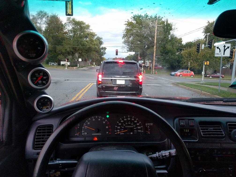

Last picture is of what it looks like from the drivers seat, when the final install happens, it'll tuck in and won't stick out so far.

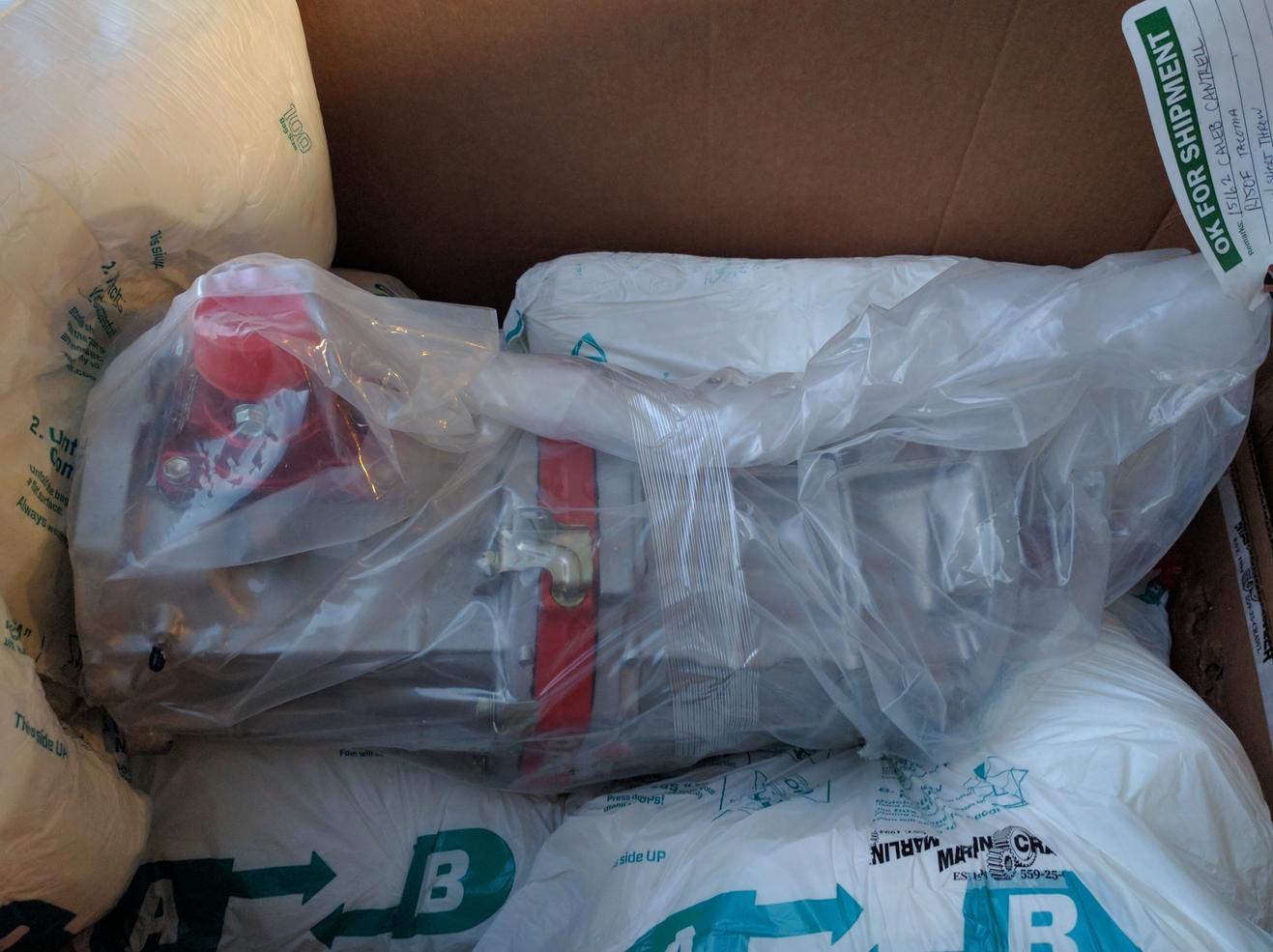

Transmission
Marlin HD tranny showed up today.

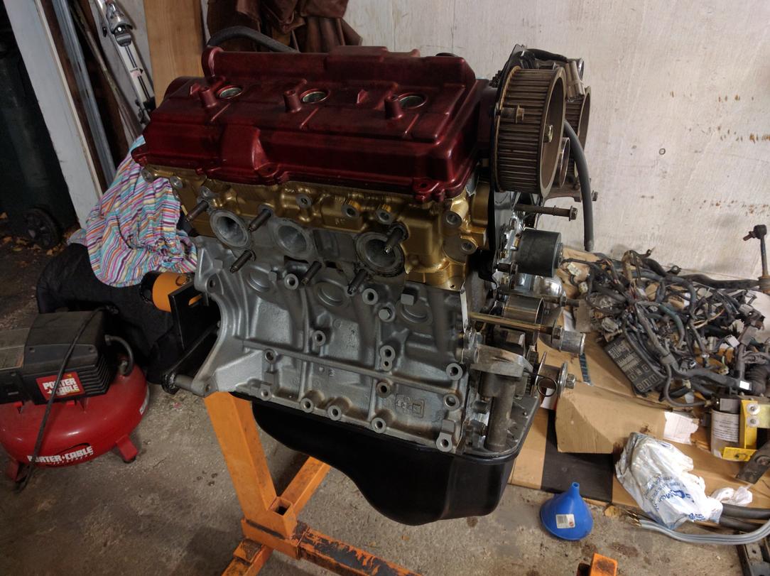

Cleaning garage
Don't need the spare chassis in the garage anymore, time to make room for the final chapter of the engine build.
Decided to go with stock intake for engine break-in.

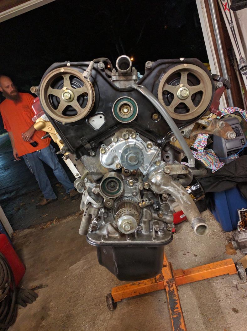

Engine and transmission swap completed.
New engine is very quite, barely vibrates at idle. AFR is below 14, but staying above 11. If I decide to adjust the tuning w/ the mapecu I'll need to figure out a way to keep the ECU powered so that it doesn't re-learn w/ different settings.
Marlin transmission, flywheel, HD clutch, and short throw is impressive. Insert something tight analogy here, and you've described this transmission compared the the old one.
Had a few run ins with problems, thank fully I had a spare set of injectors that I had cleaned and they all flowed the same (brown injectors).
New 170 thermostat wasn't flowing very much at the startup, engine warmed up to 204. Thought maybe the water pump had air in it. Pulled the thermostat out of the old motor, cut the spring off and tossed it into the new motor. Engine is staying around 140 degrees now. Winter is starting to push in, swapping back to the 170 now that there is water fully in the block.
