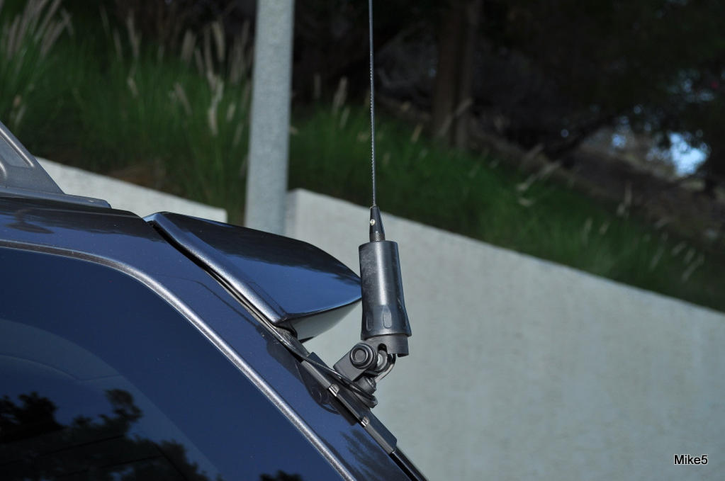

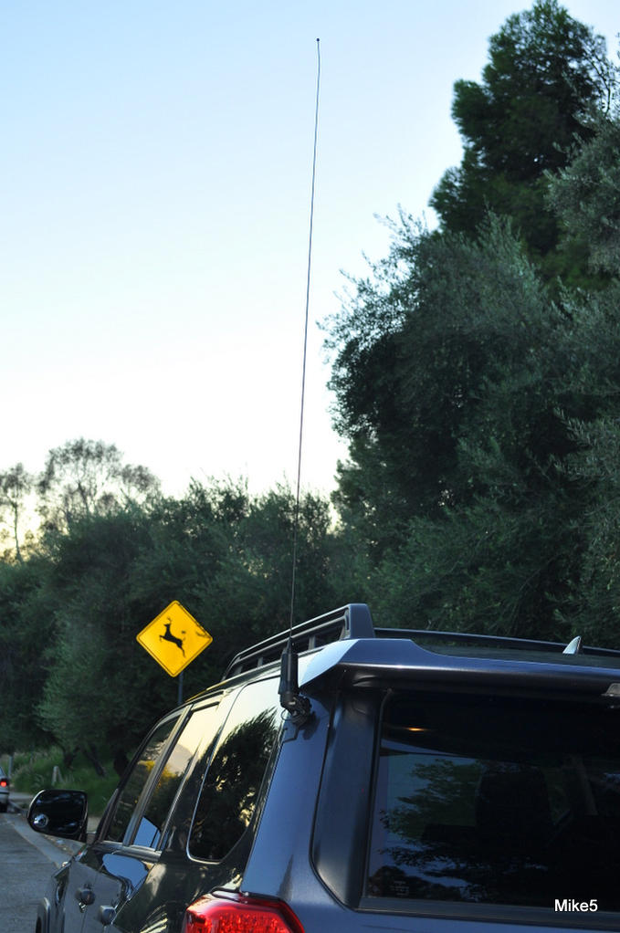

I have the K400 with a NMO mount and a Larsen antenna. Started out with a Firestik and spring; but realized that's probably not a good idea in case the antenna gets caught on brush or something else. The spring doesn't really give.

Swr doesn't have much to do with the radio you buy. It's all about the tuning. I tuned my cb antenna and probably doubled the output on an advertised pre-tuned antenna.
What he said. You gotta tune the antenna. I have mounted in my Bronco, but need to think about one for the 4Runner. I can tell you that I used to use a hand held emergency one that had the magnetic antenna. Put the antenna ont he hood of the 4Runner, but it kept getting knocked of by branches. Our trails are tight.

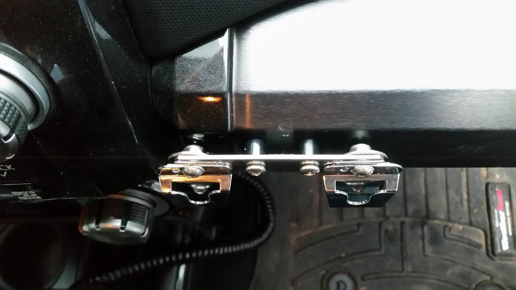

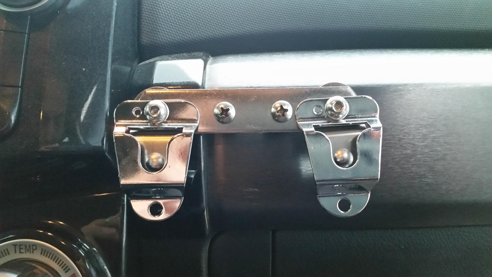

what mic holder is that? how did you mount it, just screw it straight to plastic or did you use a machine screw with nut/washer behind?
do you have both antenna cables running side by side through the firewall?
It is a piece of slotted steel, like what you would find on a u bolt, which has the two Motorola mic Clips bolted to it using machine screws and nuts. The slotted steel has two holes drilled in it with two #10 machine screws passed through the holes into spacers to act as a stand off, and then into the dash material. There are no backing nuts. It's quite sold.
