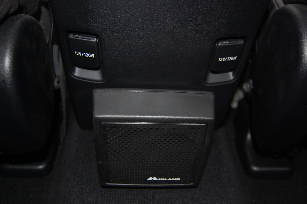

Does anyone use an external speaker for their cb or ham radio? I got a new radio that I am remote mounting and having the unit under my seat makes it very quiet.
I'm trying to find the smallest speaker to use and best spot to put it

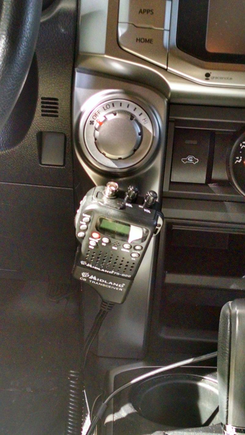

Picked up the tuned Midland 75-822 from the CB shack The belt clip is held on with 2 screws so I think I can remove it and use one of the screw holes to attach a mic clip button and put a mic clip on the dash.
CB shop says they can easily fix me up with a mike knob, to replace the belt clip, and a dash mount mike clip. Will stop by there next time I'm in the area so we can figure out the best dash clip for location as they have various configs and knobs.
For those interested, I finally got around to this.
Since the screws holding the belt clip on the Midland 75-822 are really small, and would be hard to find one with the right thread and length, we removed the belt clip, drilled a hole in it, mounted the mike knob on the belt clip with a small bolt and reinstalled the belt clip.
Put a mic clip on the dash trim, just below the A/C fan control knob using short screws. Since the unit is heavier than just a mic, I will probably later remove the dash trim piece (per other threads that appears rather easy) and put the mic clip on with small bolts. That way there would be no concern for the screws loosening and/or elongating the holes in the trim with continued use putting the unit in/out of the clip.
Now I don't have the unit just sitting in a cup holder or laying on the console. It is also easily accessed being just below the fan knob.
