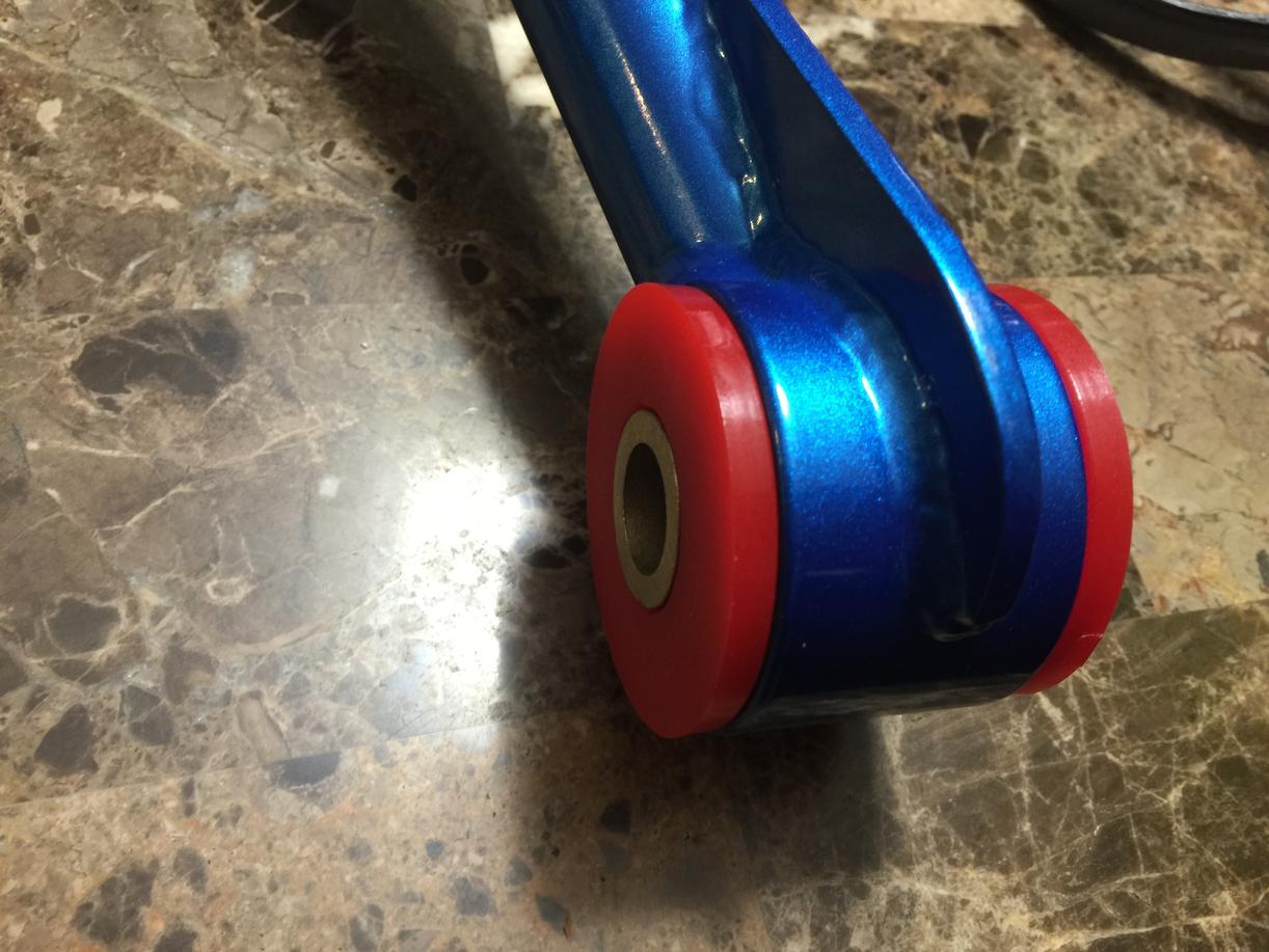

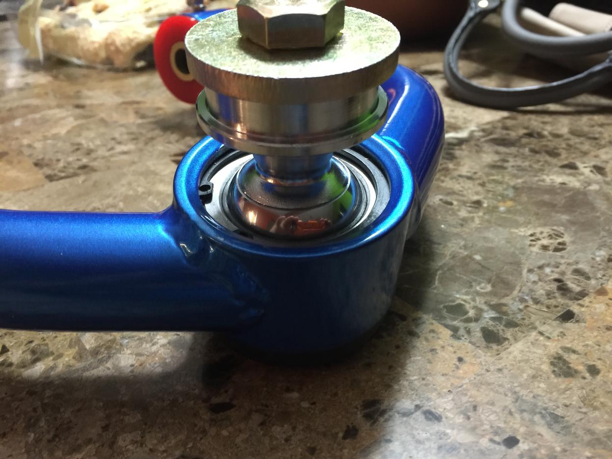

I ordered the blue ones hoping the issues would be fixed. From the looks they addressed the issues metal sleeve is long enough. Grade 12.9 hardware. No slug adapters. And added dust covers. I need to install them to see how many bad words/beers/hammers it takes but im pretty impressed so far

yep, those are the same ones i got too...look good for sure. Waiting on wheels before i do these, 5100's springs and lower ball joints. Hopefully not much longer!
Looking at the uniball. Is there a telfon tape around the uniball? So no dirt gets trapped under the uniball ?
that is a much lower price than others... wonder if they really are made of quality.... I've heared uppers aren't really much weight bearing on our 3rd gen's...
Heavy Duty 4130 Chromoly Tubular
sounds like a decent strength, as long as cold cracking doesn't occur on the welds
