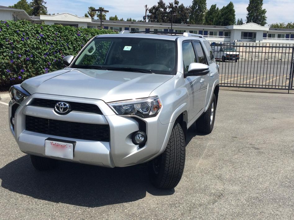

So, without further ado, the before picture:

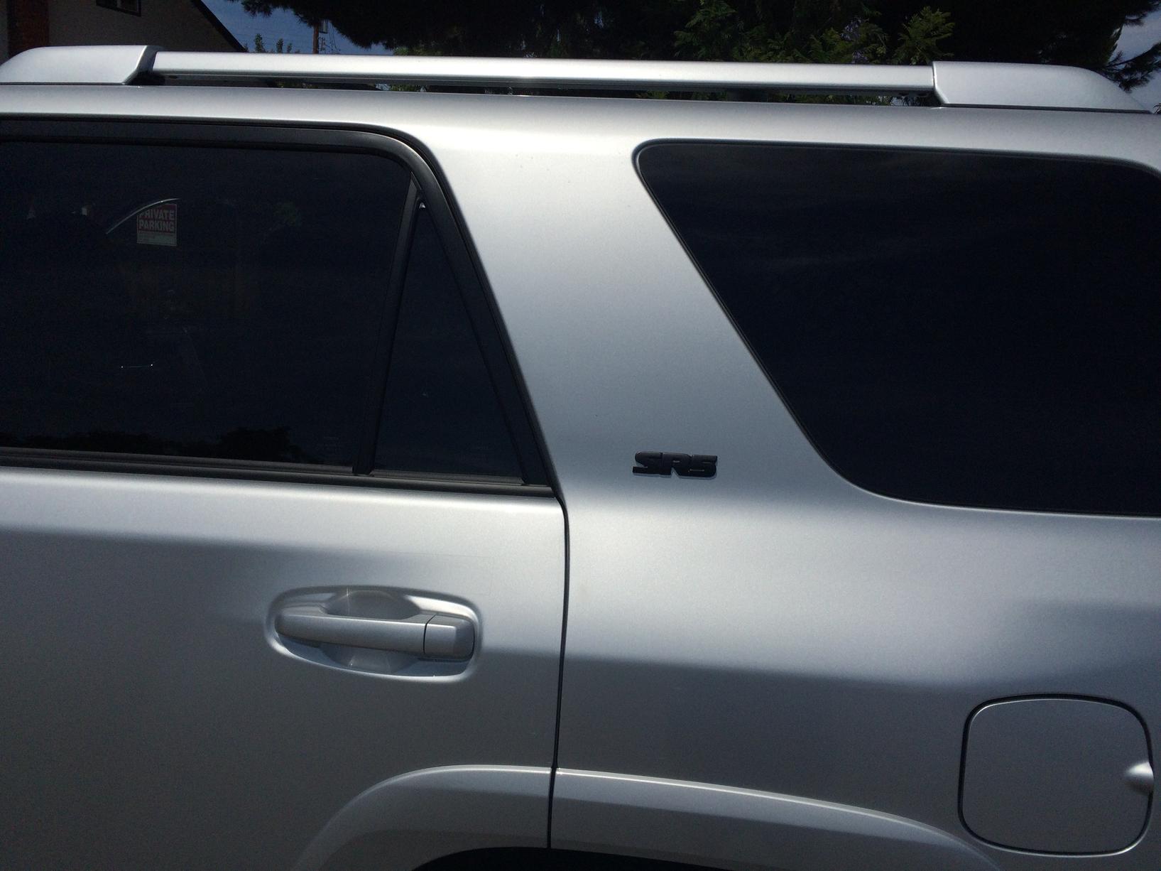

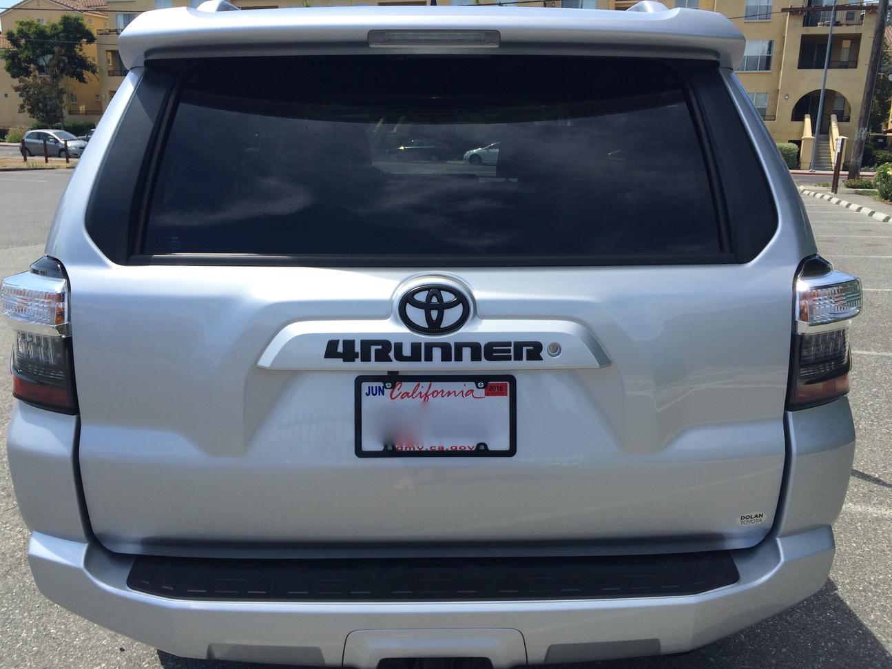

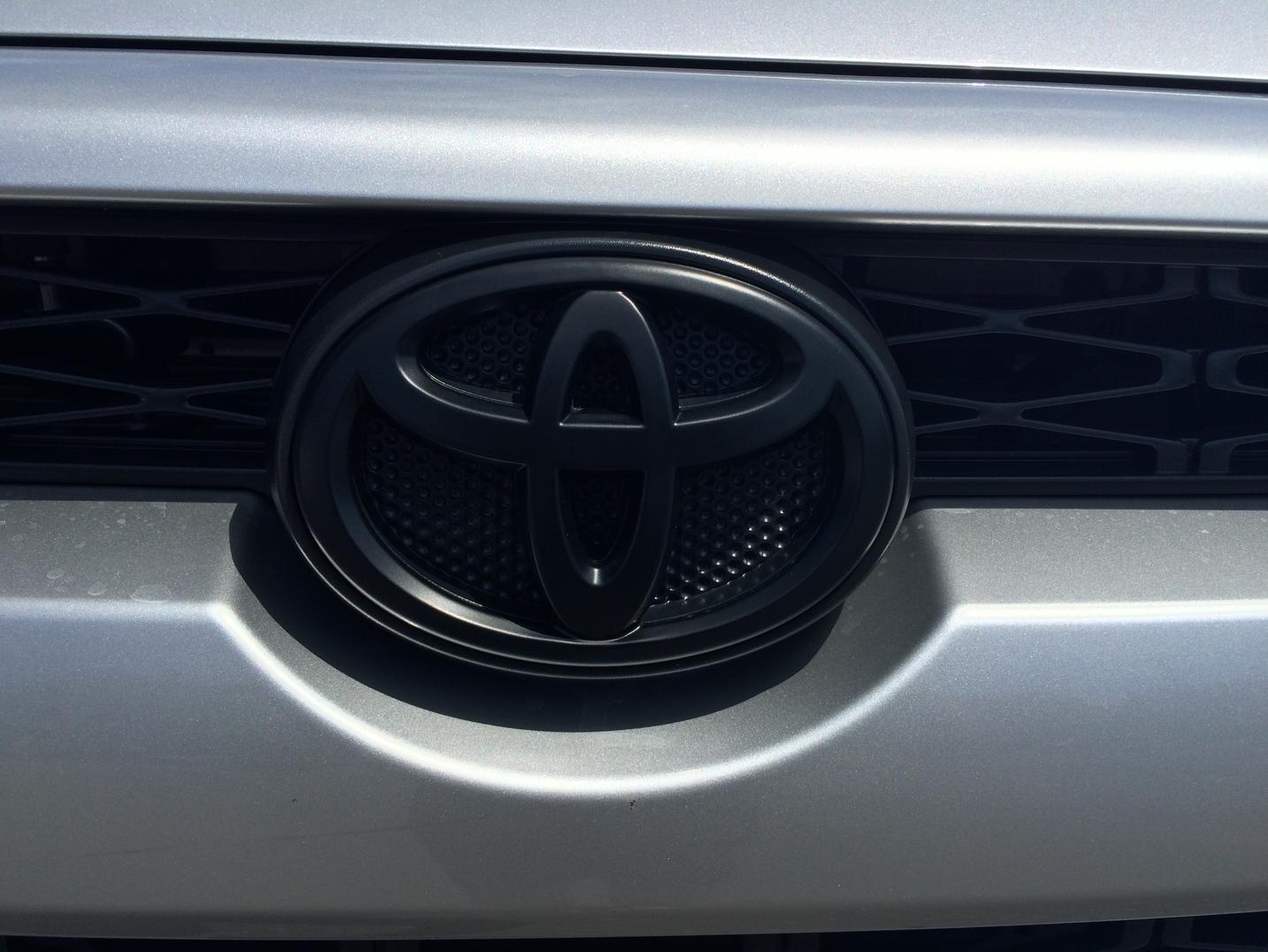

Blacking Out
I kinda hate Chrome on the outside of vehicles. Too much style, not enough substance for me. Further more, it comes across as 'washed out' against the silver paint of my truck. I'm also slightly Plasti-Dip adverse for no reason whatsoever.
I managed to score one of the NoxLuxLED black out kits off of eBay once the prices dropped to manageable levels. Shipping was quick and installation really just peel and stick. I think that it makes the badging way more appropriate to the aggressiveness of this vehicle.

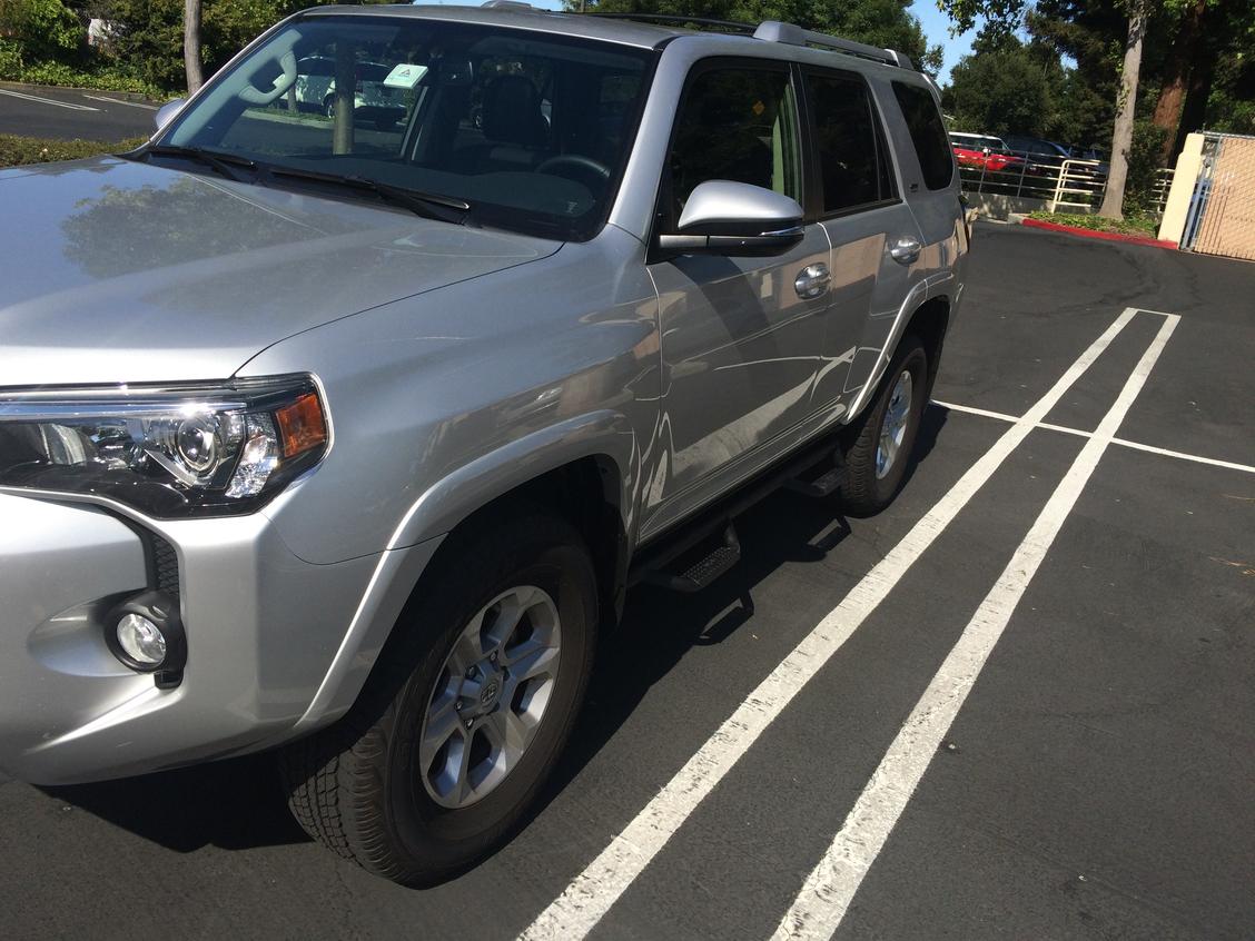

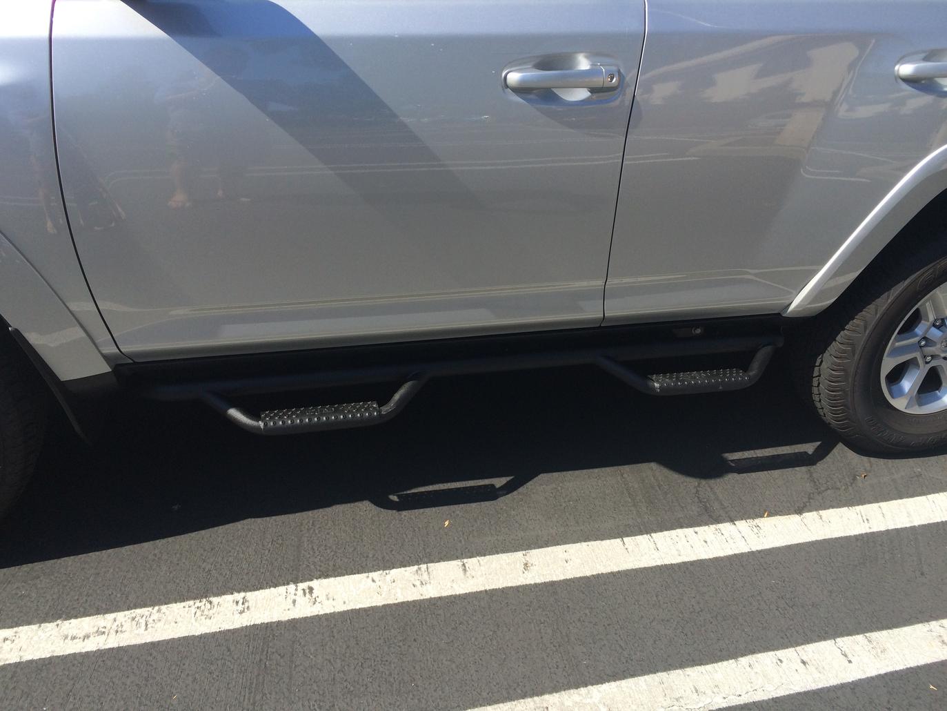

N-Fab Nerf Bars
Next up, step bars. Went with the N-Fab T1464R's as they seemed pretty solid and I liked the look. Price was ~$315 shipped off an Amazon seller.
Installation was pretty simple, even doing it solo it took about 45 minutes. Having 2 people would probably drop that to sub 30. Remove the existing bolts (12mm head, which isn't documented by the way), line up the boards, and install the supplied bolts (13mm head). As noted in other install thread, the directions are backwards; the curved piece of the bar faces forward.
