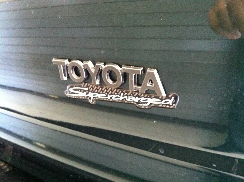

BTW, I forgot to mention where I put the Supercharged Logo.
I went with Alex.Wilson013's suggestion of the rear hatch underneath the Toyota emblem. Looks sharp.

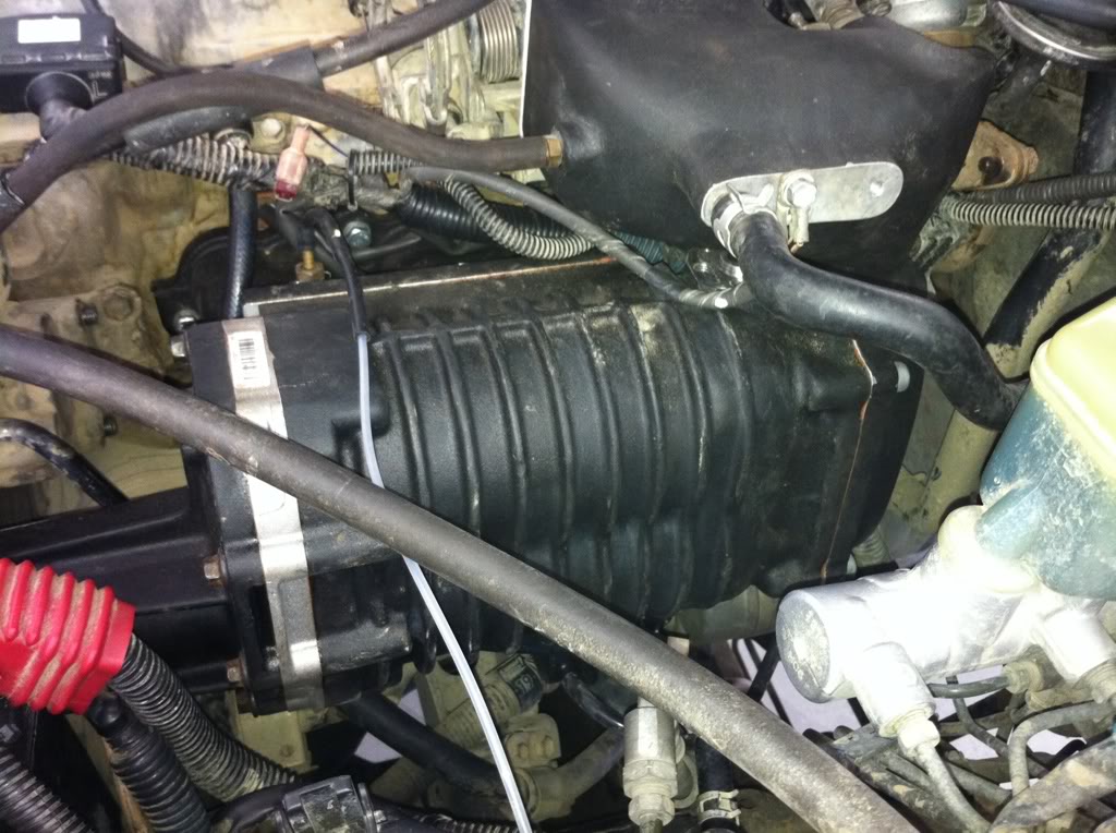

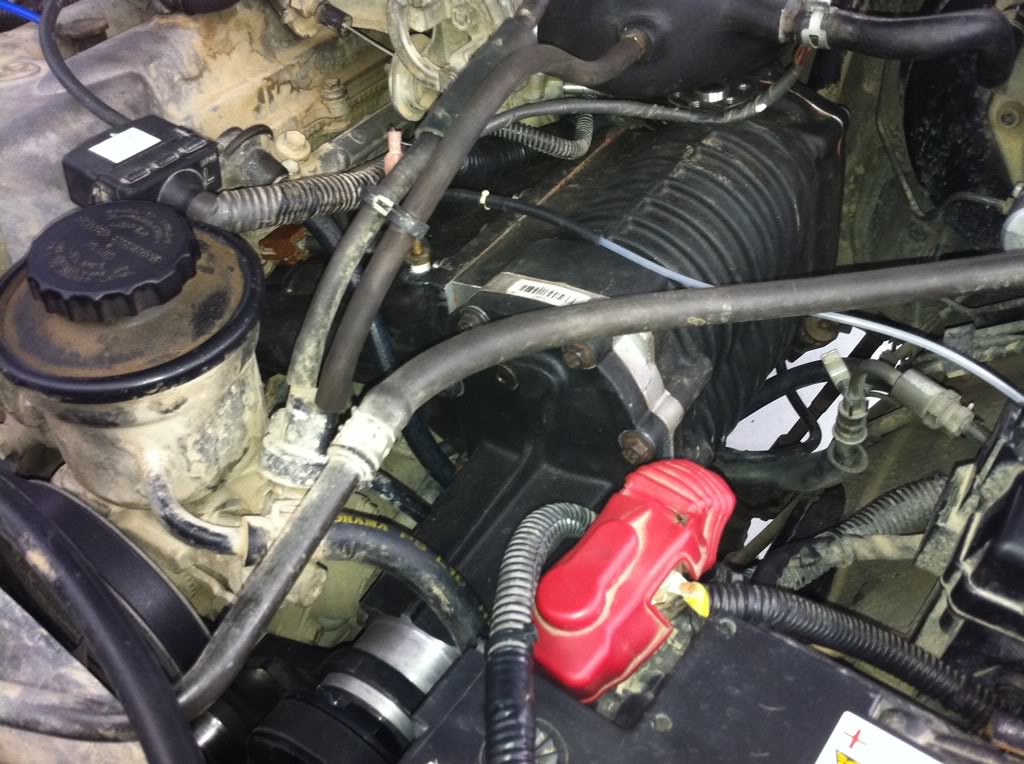

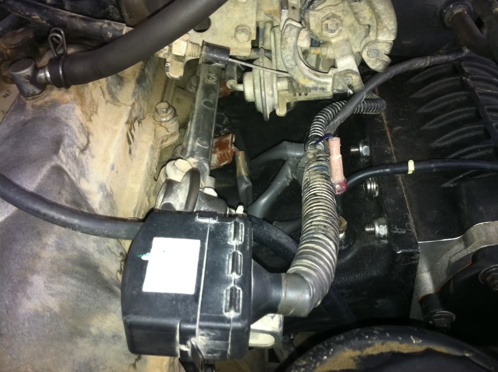

This morning when I went to start the truck, I got a check engine light.
I went to work and removed the intake, throttle body, and cleaned up the wiring by rerouting it to above the intake plenum. I also replaced the 2 lower throttle body bolts for some 5mm longer grade 8 bolts that had better bite with the threads. The old ones were too short with the added teflon gasket.
Double checked all of the vacuum lines, all of the sensor/injector plugs, and mounted the DLC1 OBD connector/EGR Modulator in their Toyota recommended spots.
No problems as of yet, everything's going well.
