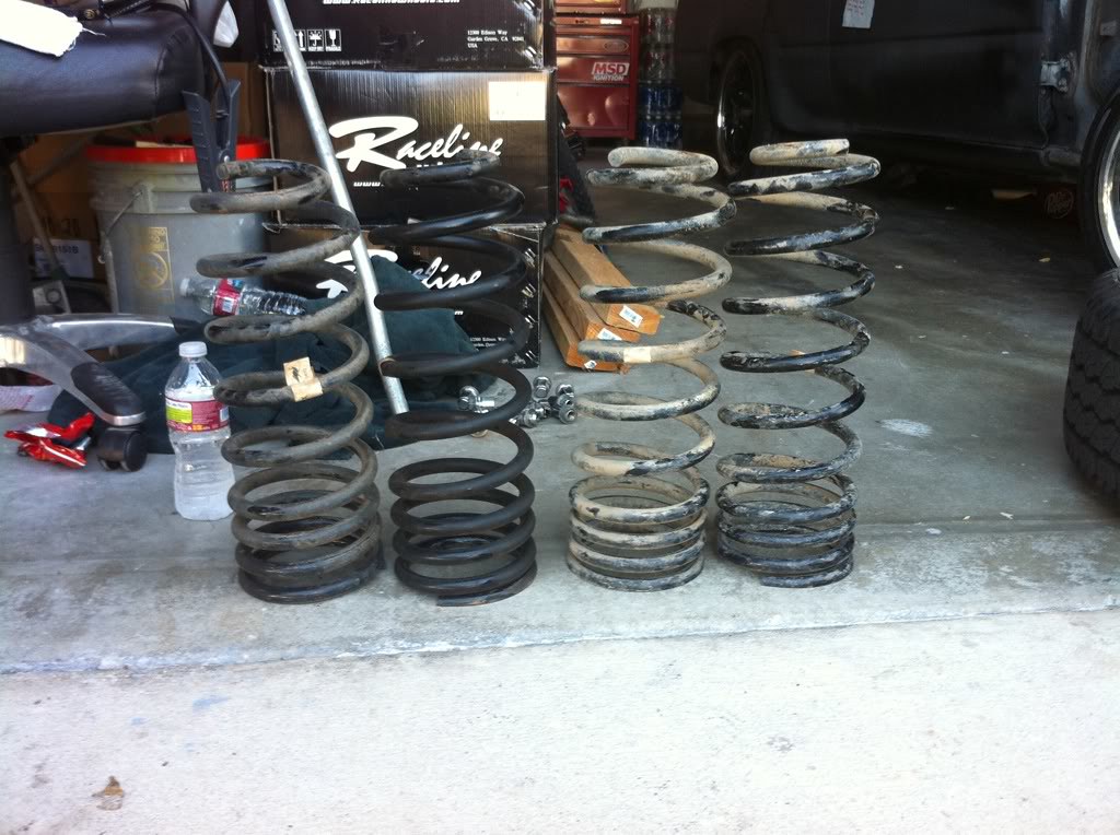

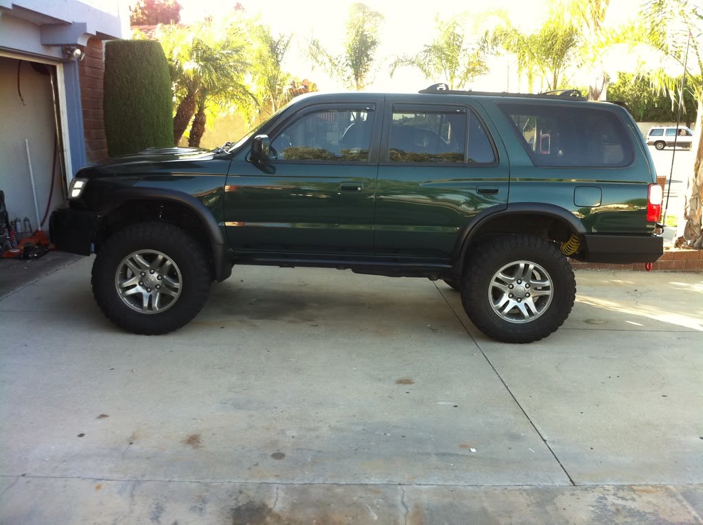

Sorry guys, no actual swap pictures, but I swapped rear coils with pbcolt today. I have 891's now. Good news is that I put both my OME trim packers on the left again and it's nice and level.
Supercharger is going in for rebuilt mid august.
Thanks, hope to get the real updates in by then. Finally starting to pull in some real money.
891's (left) versus 890's (right)
Hard to see, but the 891's are actually a small bit shorter.

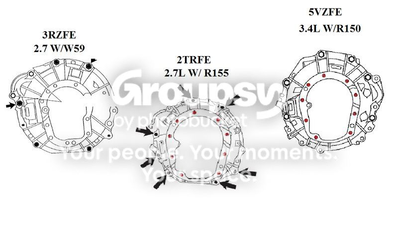

Good to know. I assume you have a V6, because neither of those transmissions bolt up to mine. I do want an R series one day if the auto one breaks again
Hmm. I thought both V6 and I4 used the A340E/F and the only difference were the manuals with the V6 using the R series and I4 using the W series. FWIW I've seen some 2.7 Hilux Surfs use Multimode.
Both the 2.7 and 3.4 have the A340E/F's but the bell housings don't match. They also have different length input shafts and likely a different spline...
The gearing for the 2.7 is slightly different to accommodate for less power, too. I think Marlin makes a bell housing or an adapter, but I am not sure.
Idk how the multimode worked out, must be just a factory option overseas.

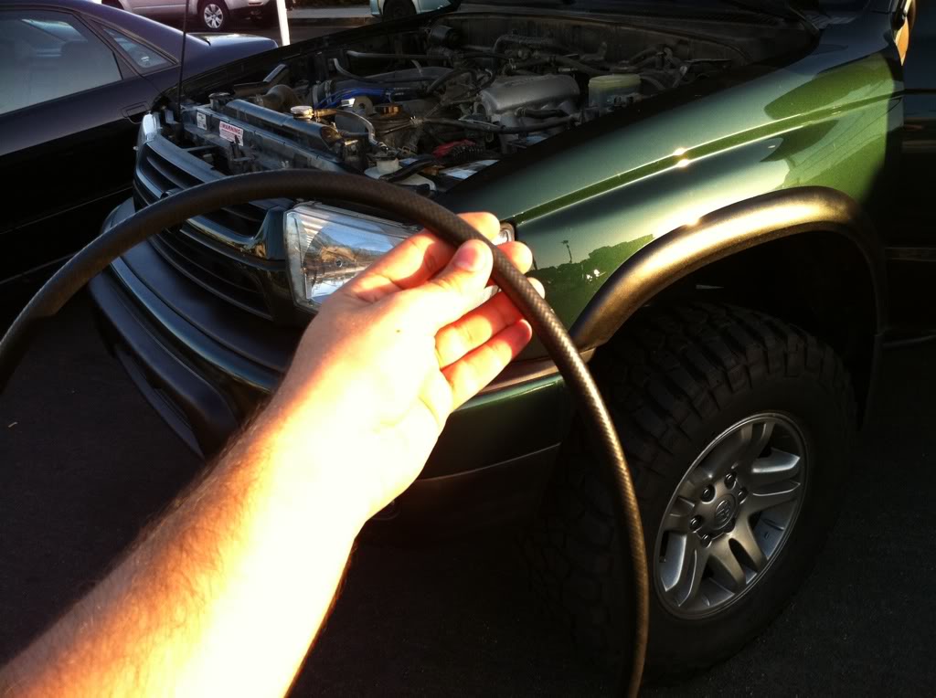

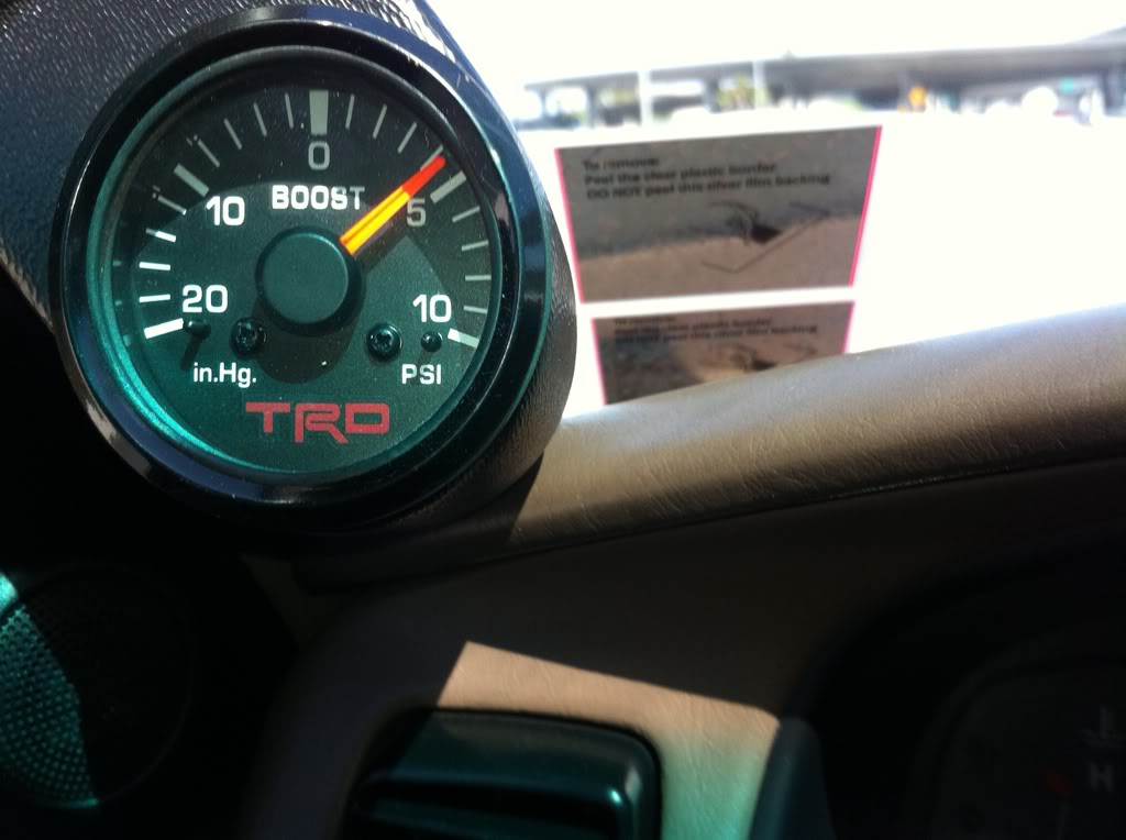

I just saw you were having a problem with a leaking noise on the boost gauge. Perhaps try an inline restrictive fitting? Like $2 at your local auto parts store.

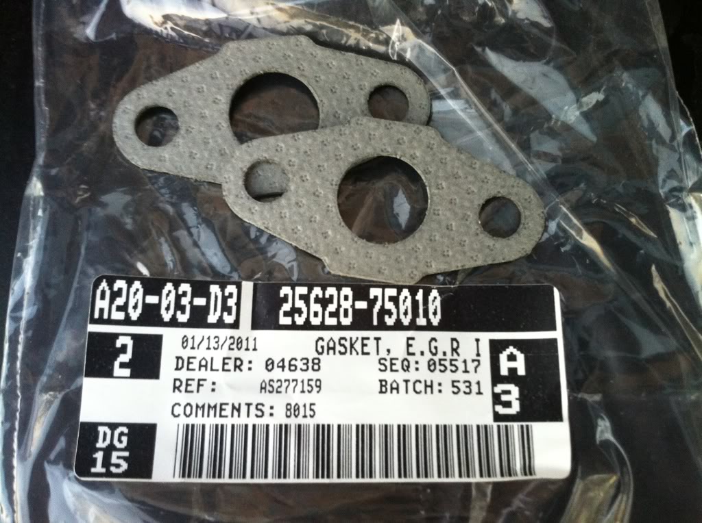

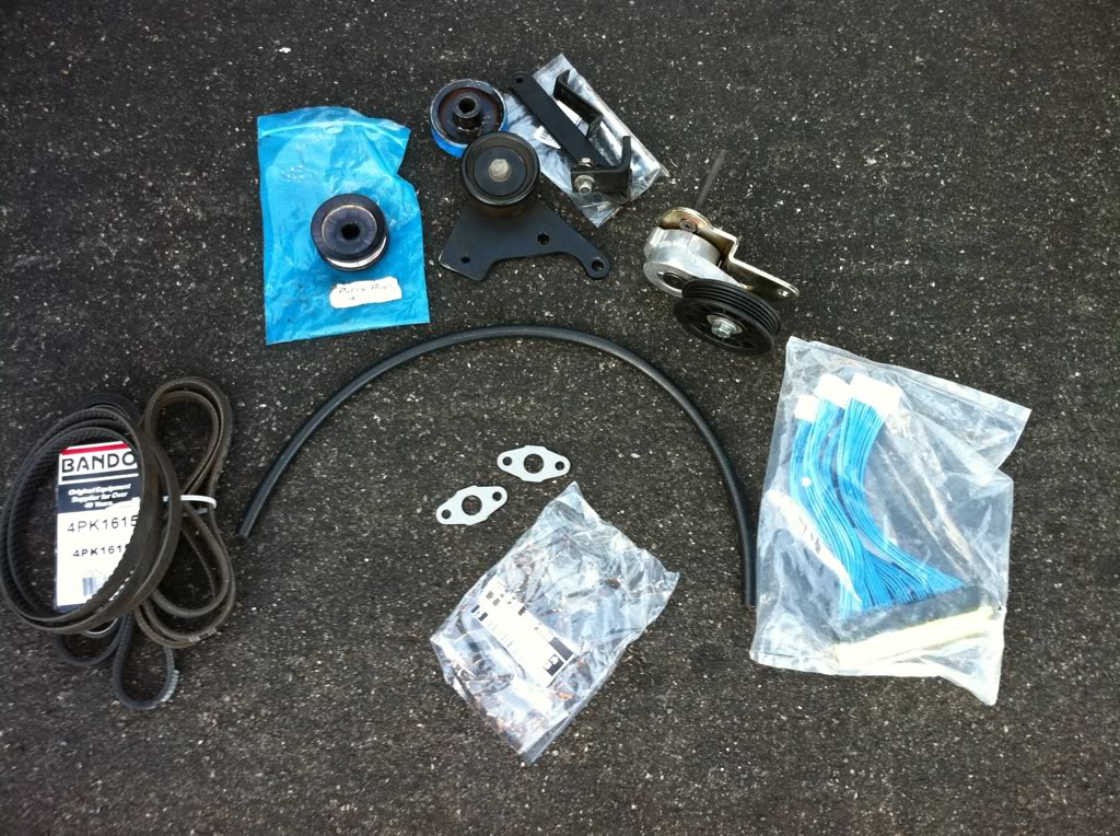

1. New EGR Gaskets from Toyota, $5.
4Runner receipt folder is getting a little big... tore the side already...

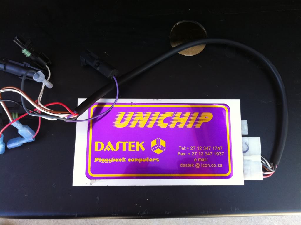

2. Received Unichip in the mail, free. Might use it, might not.

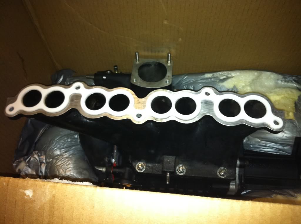

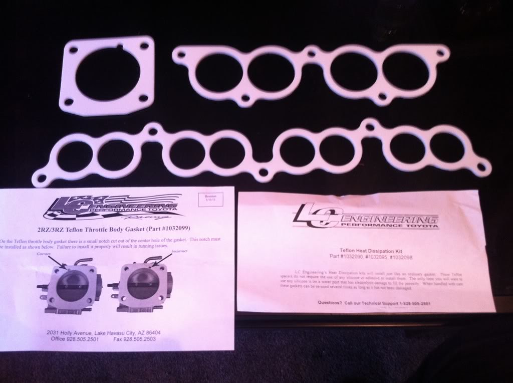

3. Teflon Intake Manifold gaskets arrive

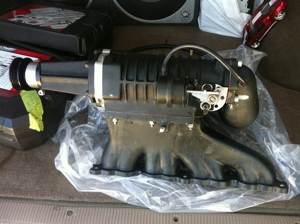

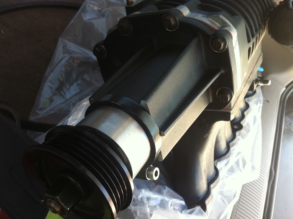

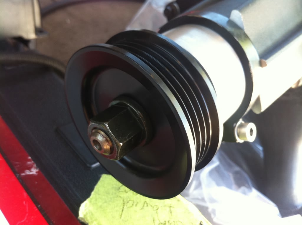

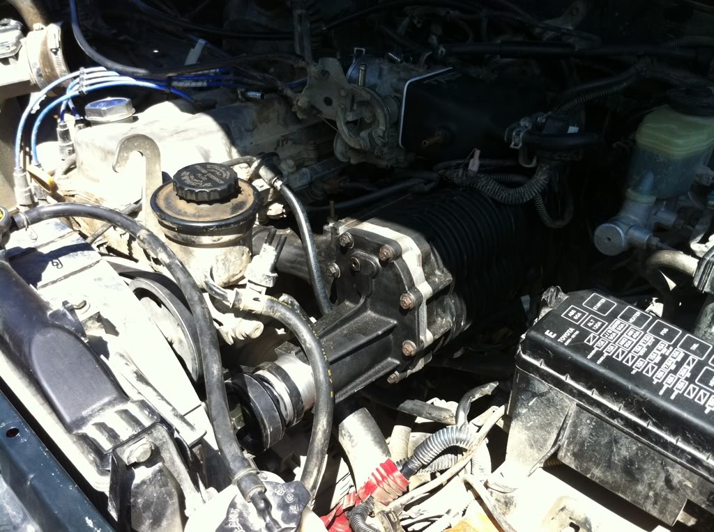

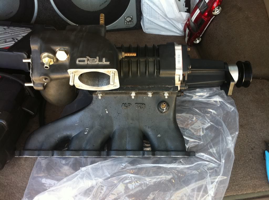

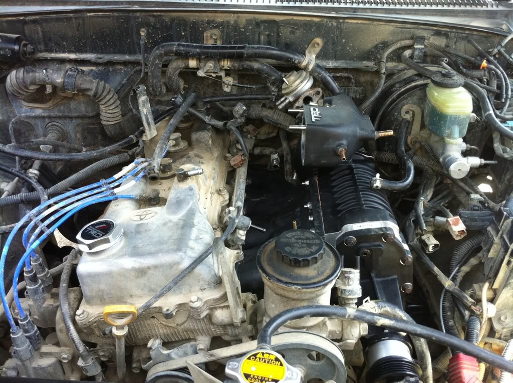

4. Picked up my supercharger, freshly rebuilt. New bearings, bypass valve, seals, rotors, and nosecone.

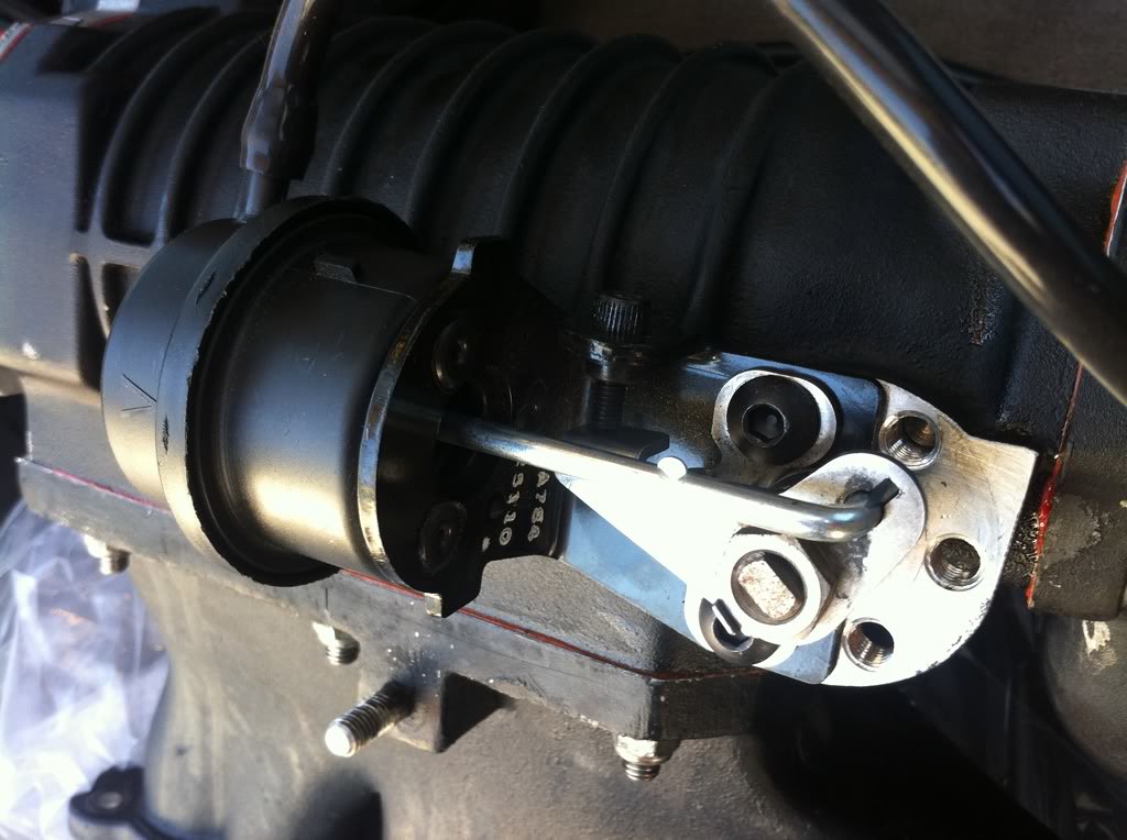

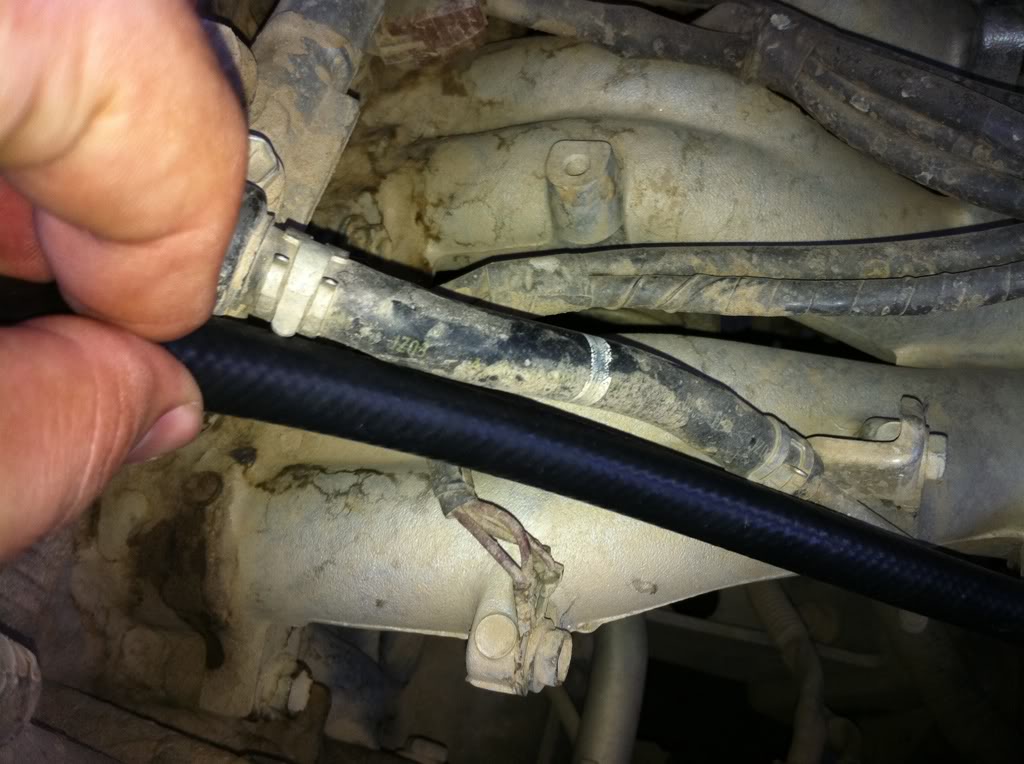

5. Inline restrictive fitting for boost gauge (thanks Alex, it worked flawlessly):

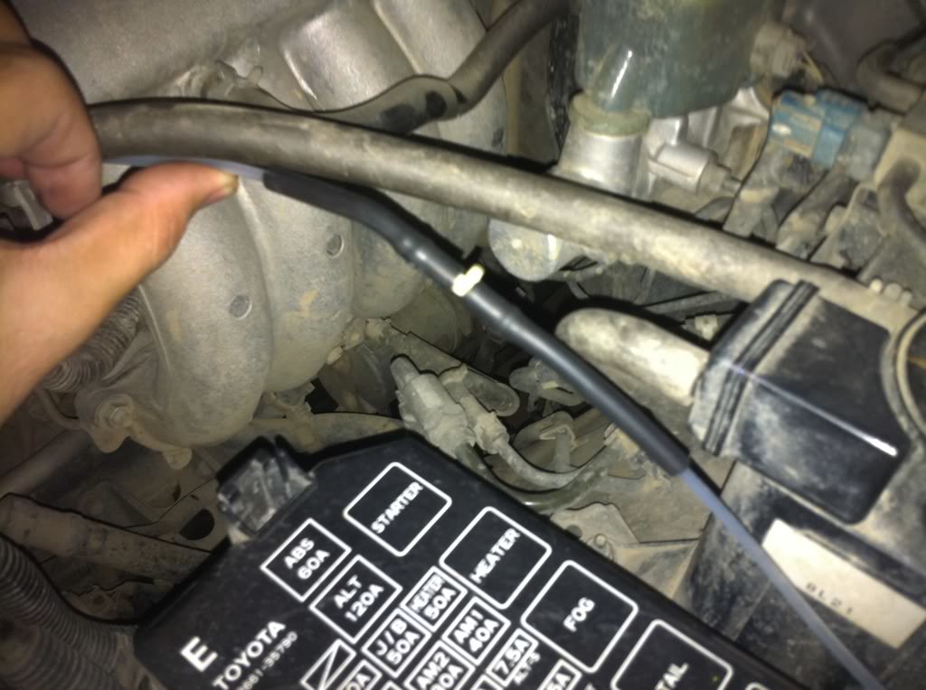

6. New extended fuel line:
7. Let's get this party started.

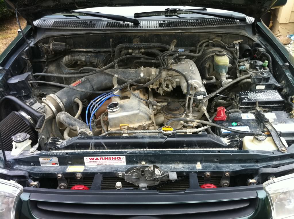

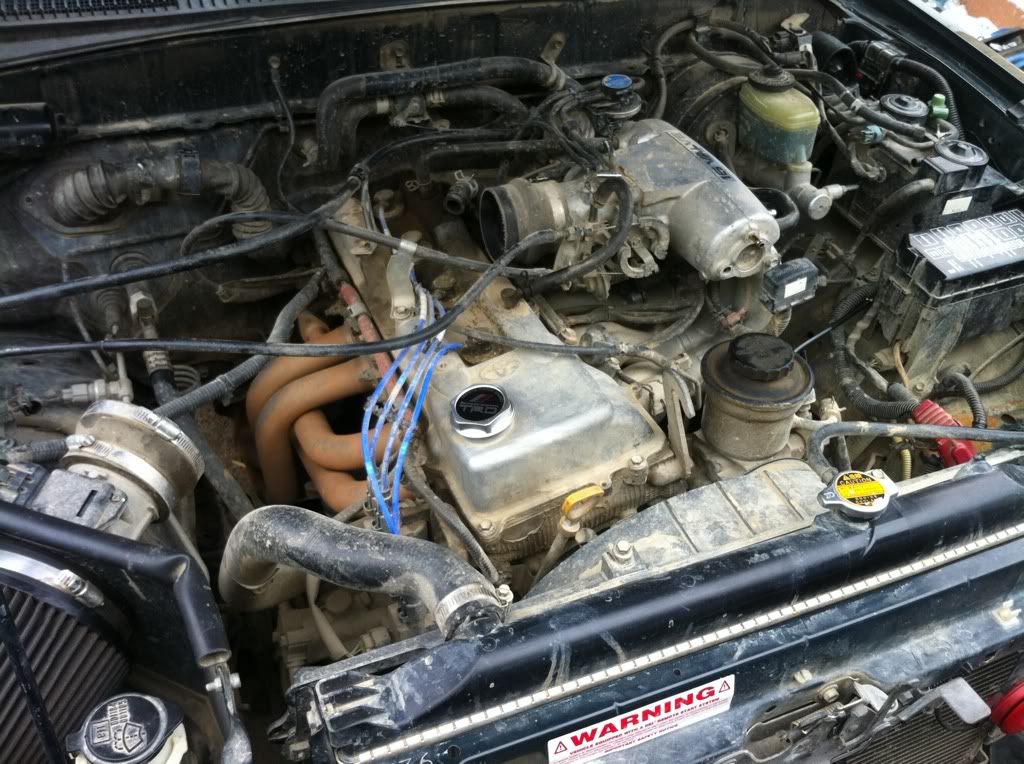

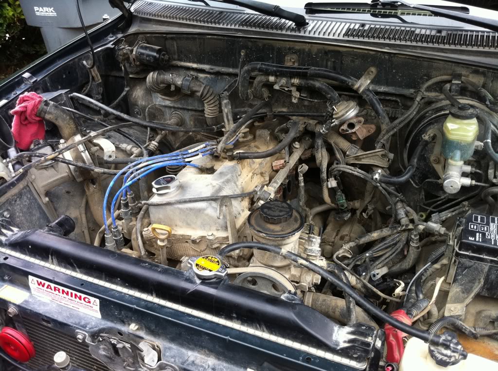

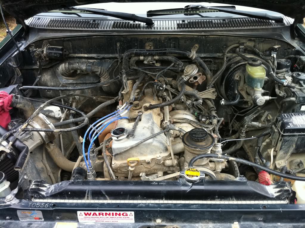

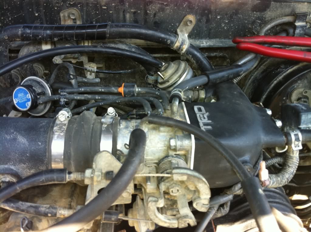

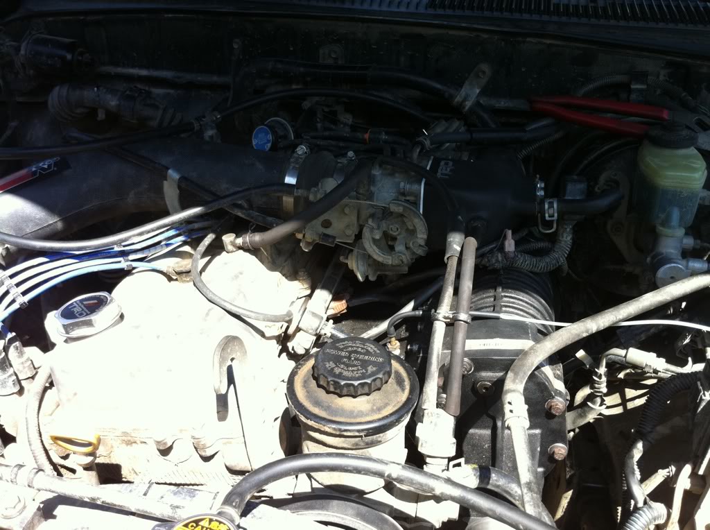

N/A setup:

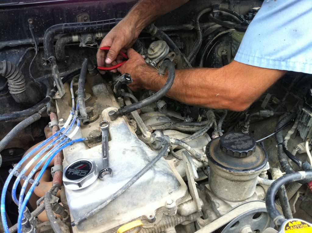

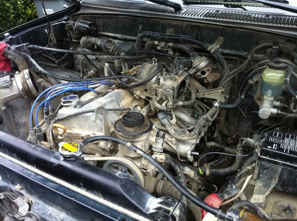

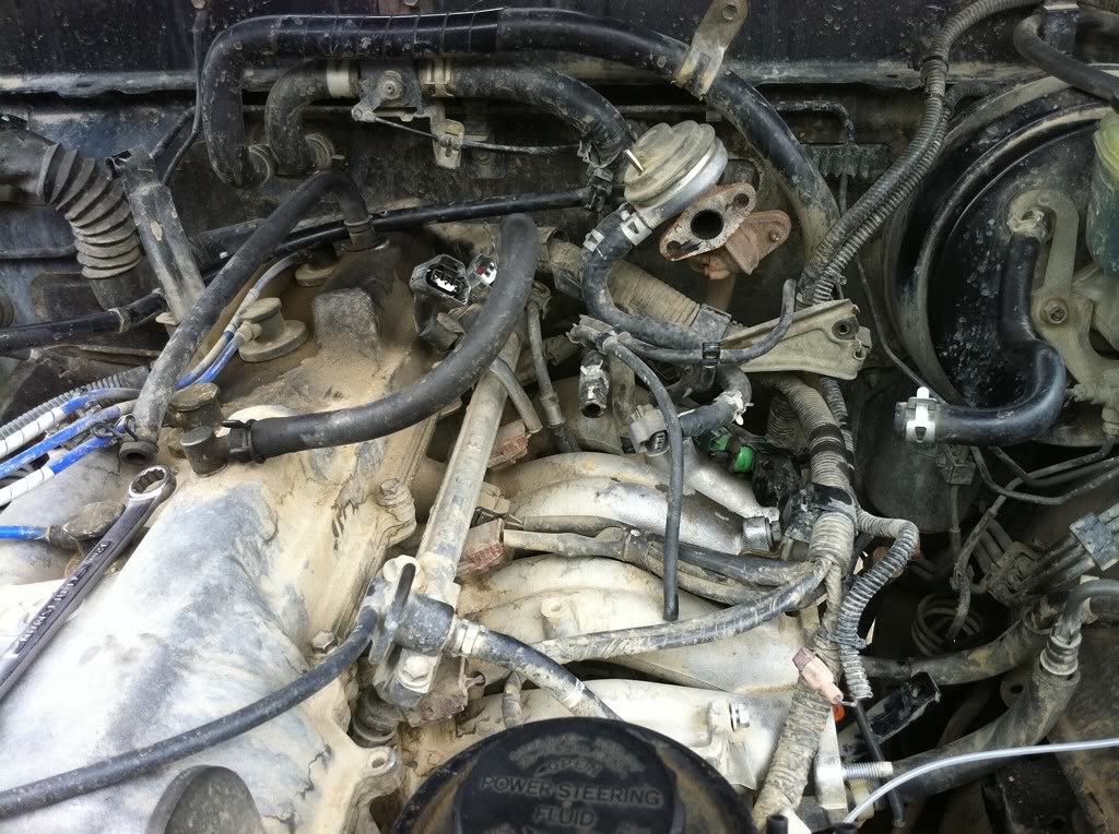

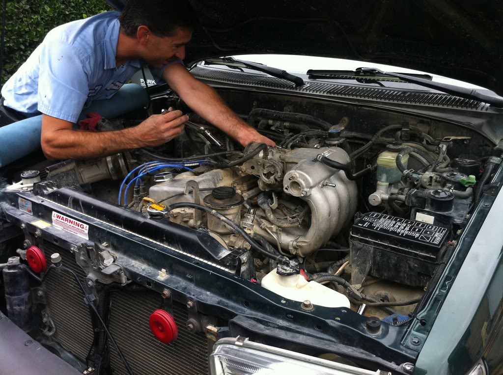

Intake off, driffter unplugging various sensors while I snapped a quick pic

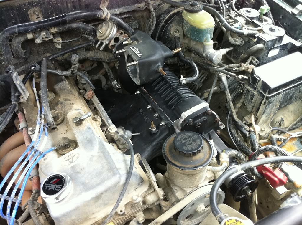

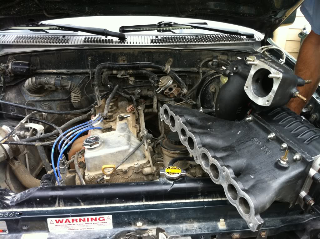

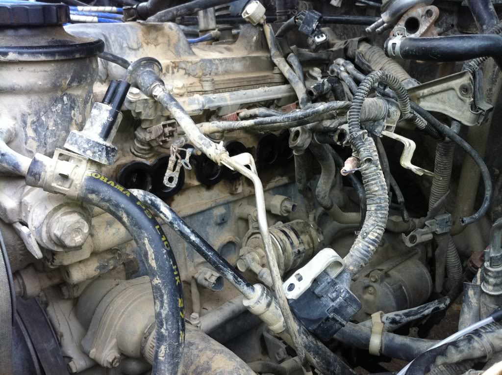

Upper intake manifold and throttle body removed:
While we were there, we bypassed the throttle body coolant line. It no longer flows through the throttle body.

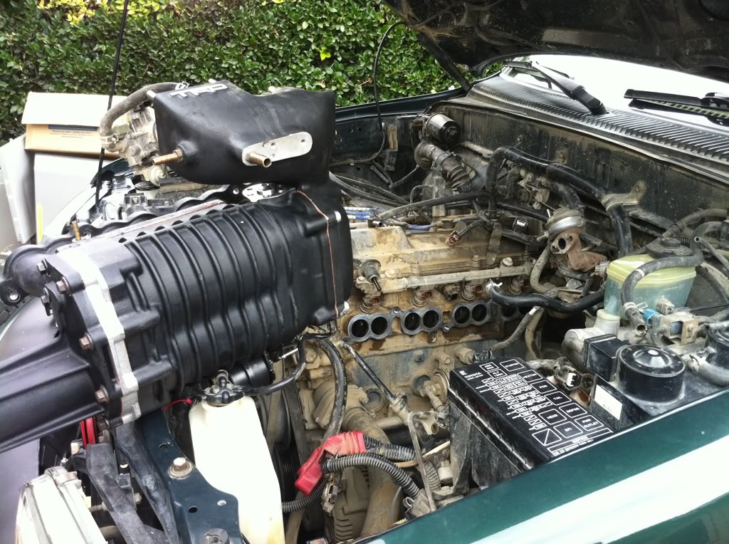

Lower plenum off

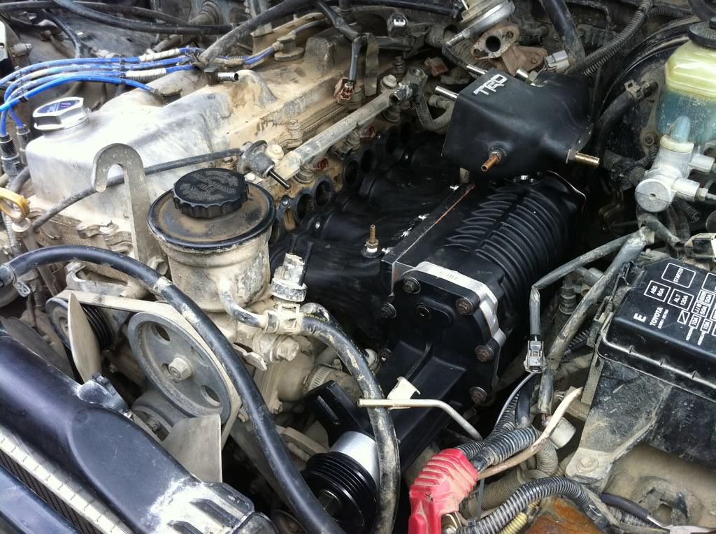

Squeeze this mofo in:

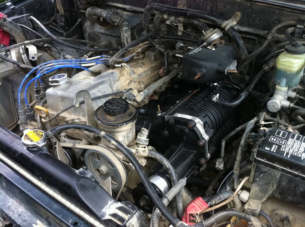

Belt on, throttle body on

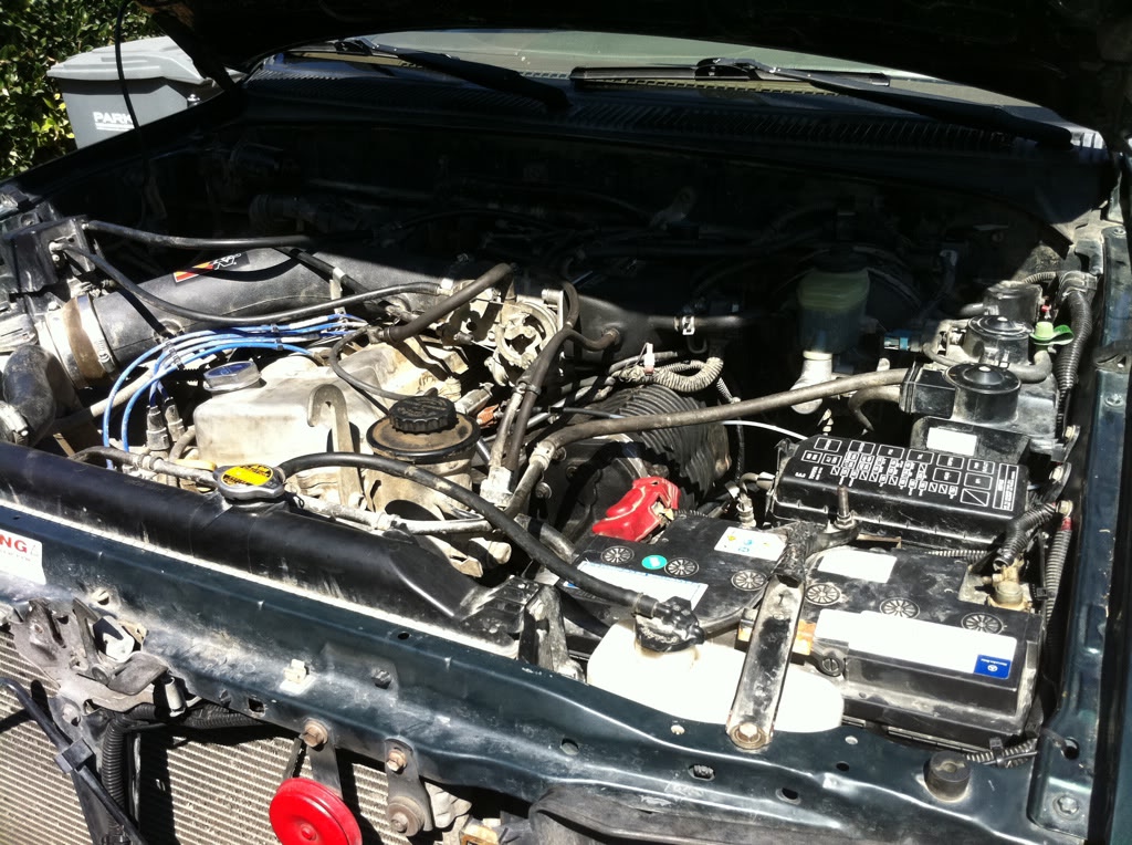

Battery back in, everything hooked back up, test!

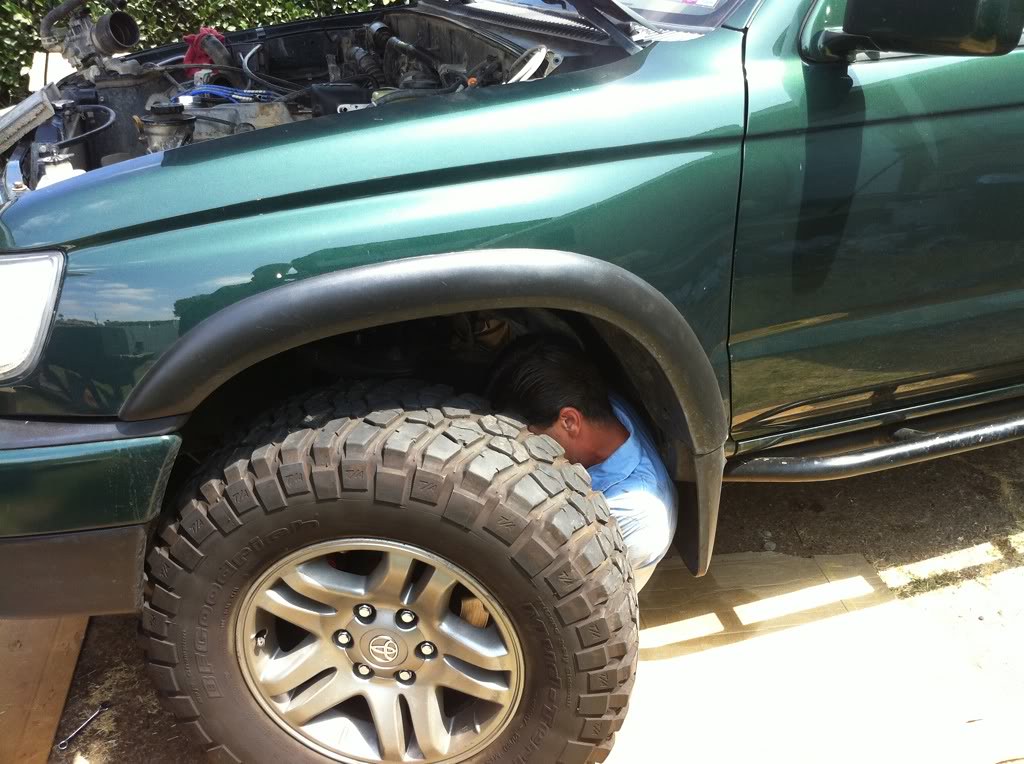

Then, driffter got ran over because he was in the way
or maybe he was just trying to reach underneath the supercharger through the wheelwell...
Wow, that video was making me nervous at first. I am very glad to see you got it all worked out though!
Now on to the tough questions.. Do you always have a little red ford GT in the back of the truck, or was this a good luck charm of some sort? lol
0 to 5psi boost in 7hrs nicly put togeather COB. It is always nice to be a part of a nice build.
MMMMMMMMMMM.... Boost!!! :hungry:
Great work man. As I looked through the pics I was hoping that you guys had swapped the fuel filter while you had easy access to it. Not a big deal, but putting in a new Toyota filter can help out w/fuel flow a little.
