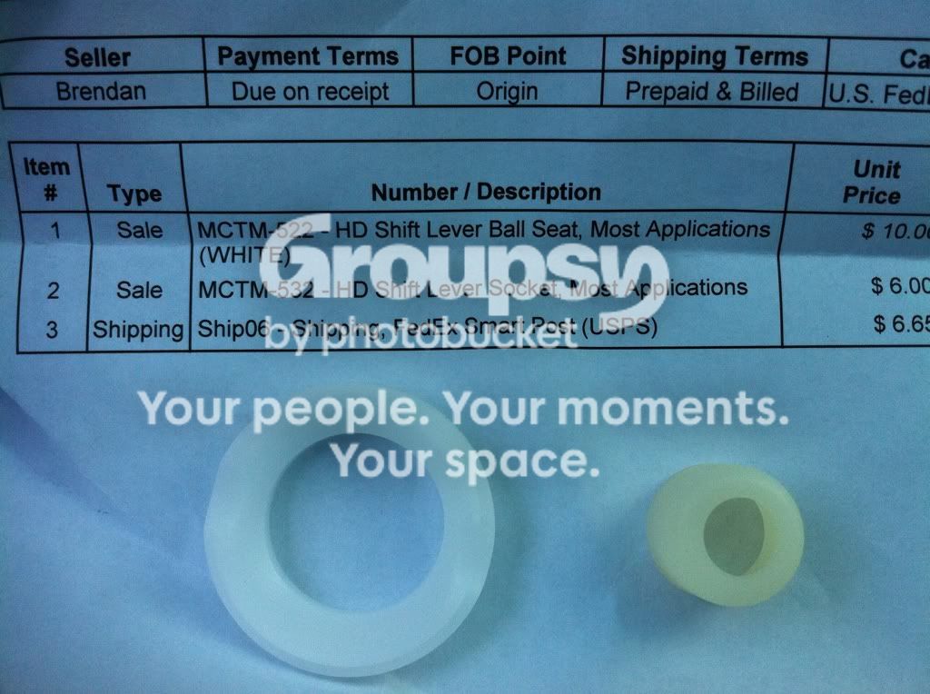

Marlin Crawler Shifter Bushings.
0cea1261.jpg~original

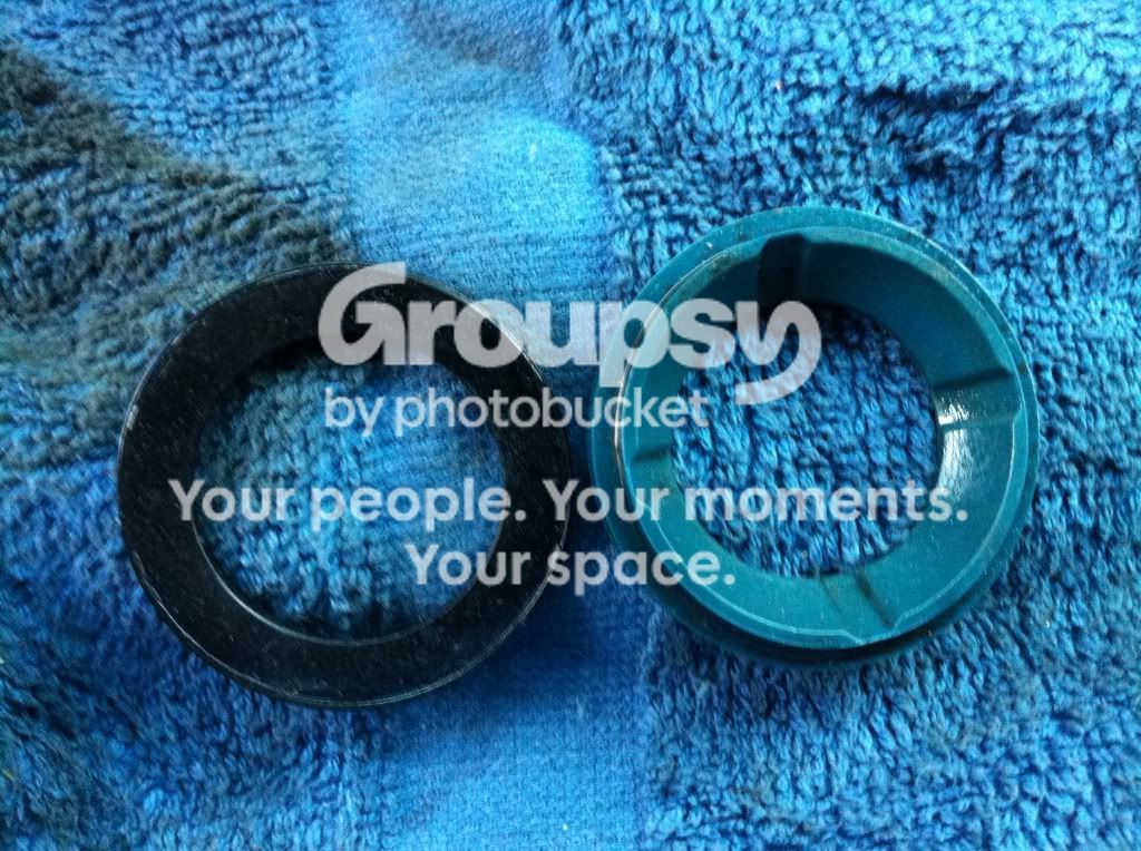

The old shifter seat. It was originally one piece, but came apart.
36a5bf6e.jpg~original

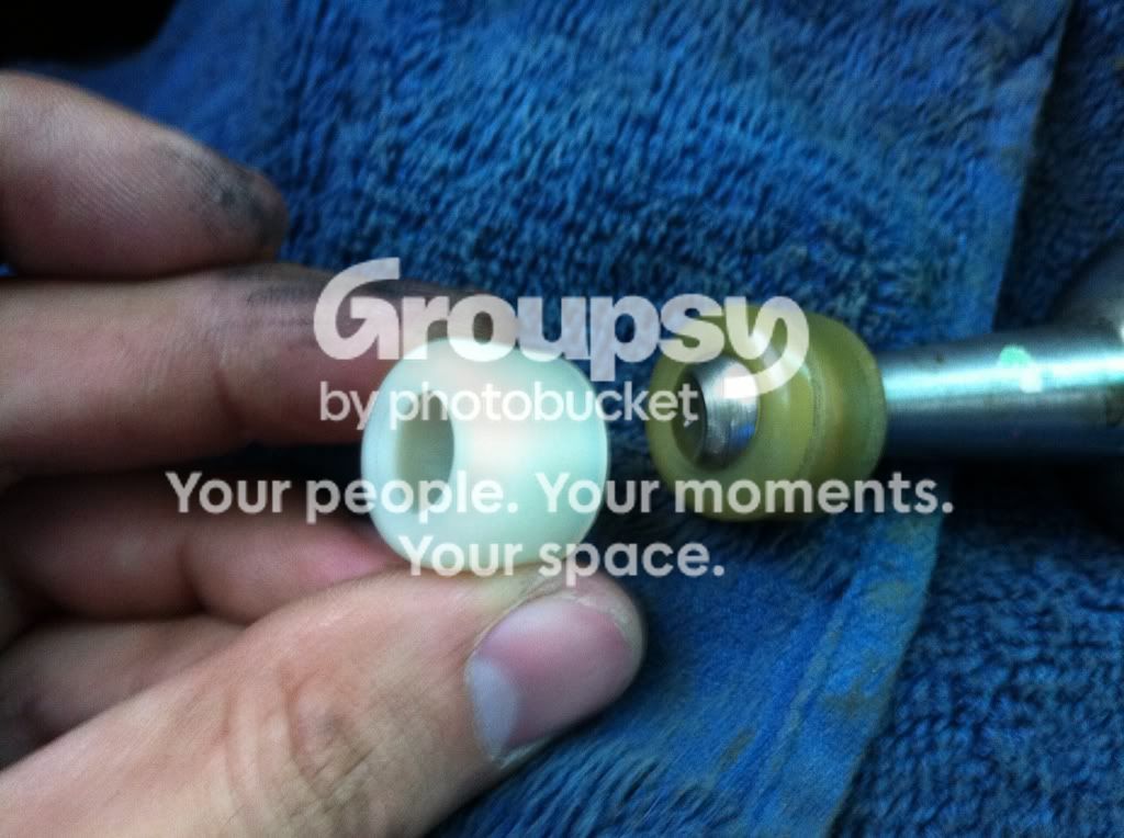

Shifter socket bushing, new and old.
bf9a3ecc.jpg~original

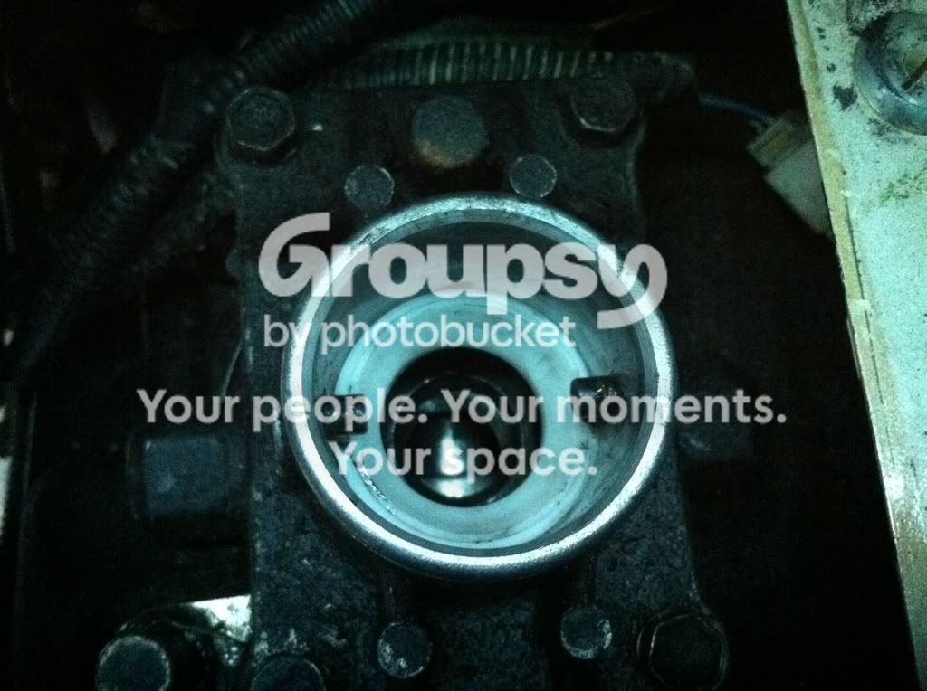

Installation is easy. You lay the seat bushing on the two pins (there are grooves in the seat) and pivot it around the pins until it falls into place.
d92ec8ae.jpg~original
The shifter is very solid and shifts are very smooth. Extremely worth it if you drive a 5-speed, especially since this costs less than $20.
