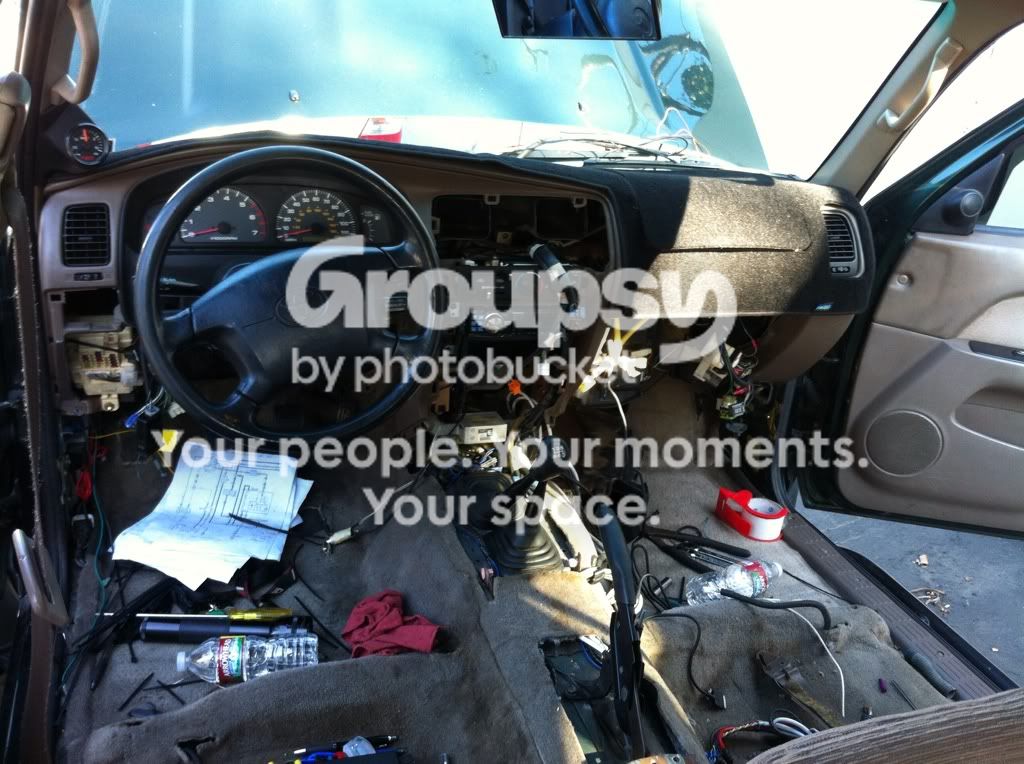

Dash back in. This is about halfway through.
53828ef9.jpg~original
6k white LEDs from V-LEDS.com. Still gotta work out the hotspots.
4145454c.jpg~original
The ADD was hooked up today and some kinks with some misplaced wires were figured out. My truck is now 100% a fully functional 5-speed manual with four wheel drive.

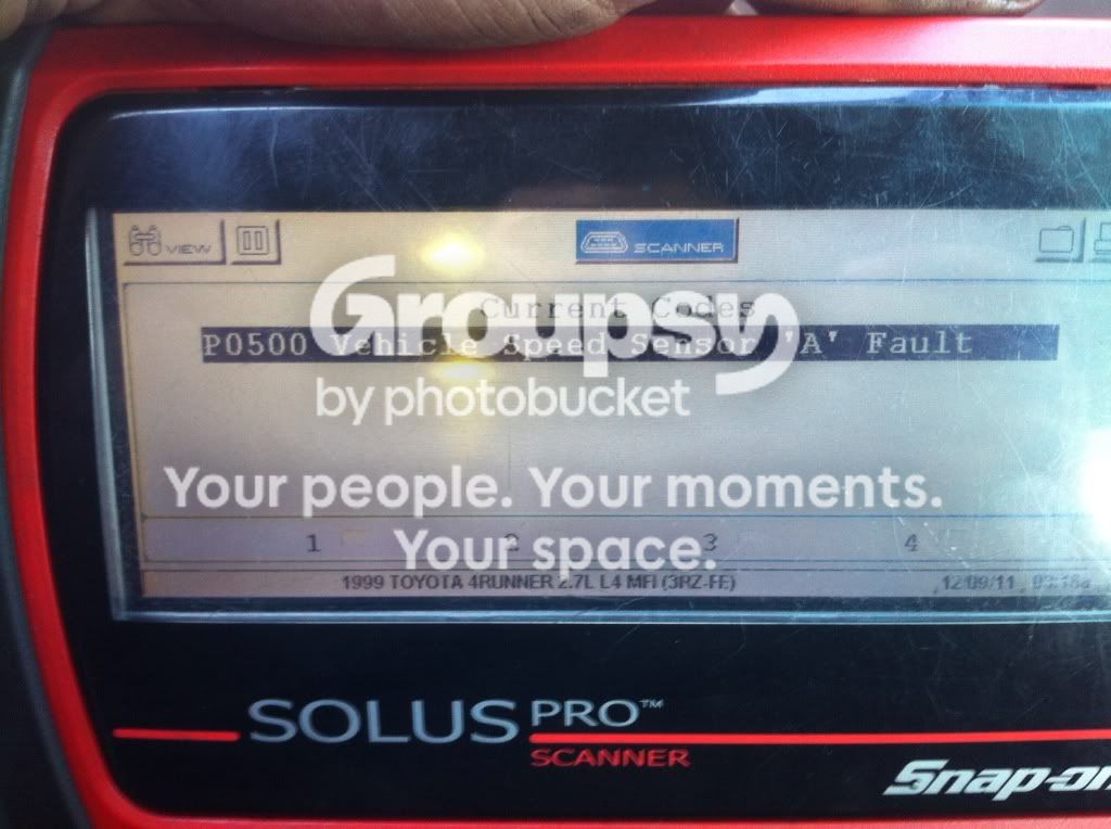

My Check Engine Light came on. I was scared that it was going to be something serious.
c25b01db.jpg~original
Relief! I know already! Freakin' ECU.

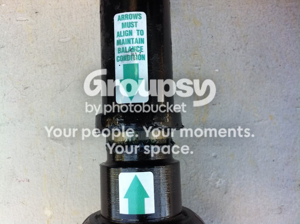

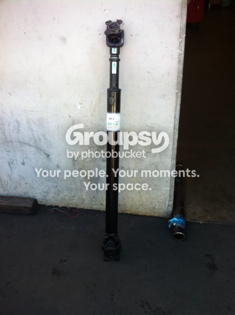

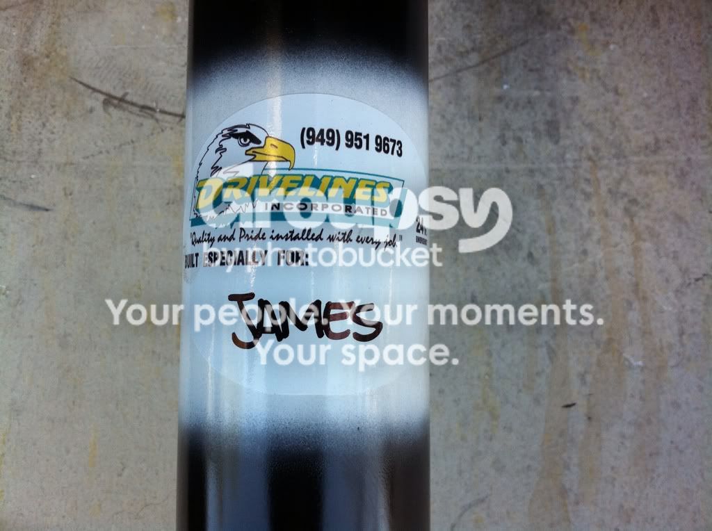

I took my driveshaft over to Drivelines, Inc. over here in Mission Viejo. This shop is well renowned, they've even build driveshafts for Jesse James and delivered them on TV.
This is what $180 will get you:
7d927eef.jpg~original
7fc9cc88.jpg~original
aa713440.jpg~original
I put it in and immediately went to the testing grounds, AKA a 40 foot tall steep dirt hill with shrubbery and crap all over it.
First, I went as far as I could in 2WD. As soon as the rear wheels actually touched the hill, the tires spun and it was going no further.
Then, I tried out 4LO for the first time...
... well, let's just say I realized that I'd proved my point about halfway up. :lmao:
