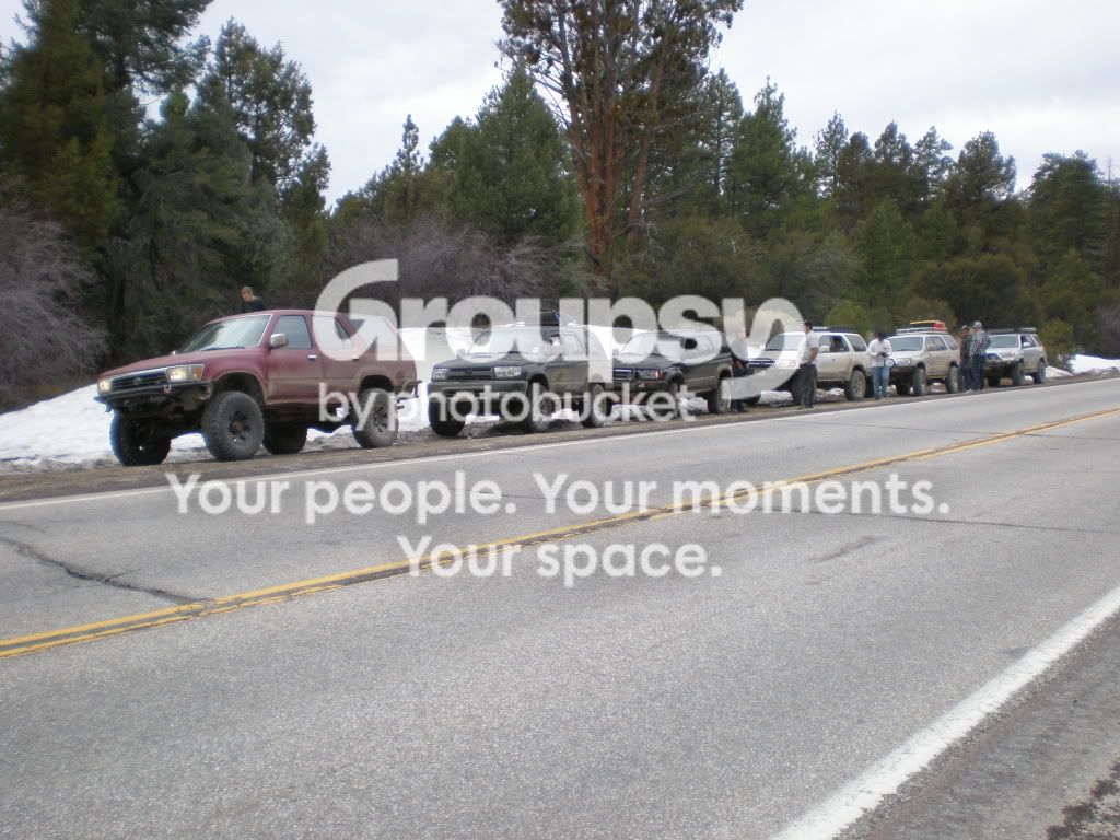

Some pics and vids from Big Bear:
Friday night
The burritos got cold, so...
d67599f2.jpg~original

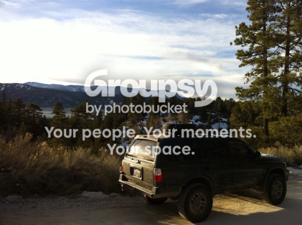

Camped out in a small clearing at about 7600ft.

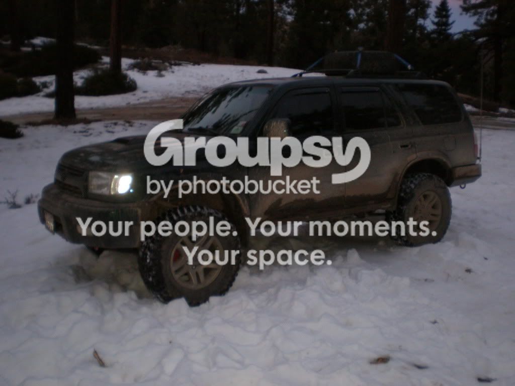

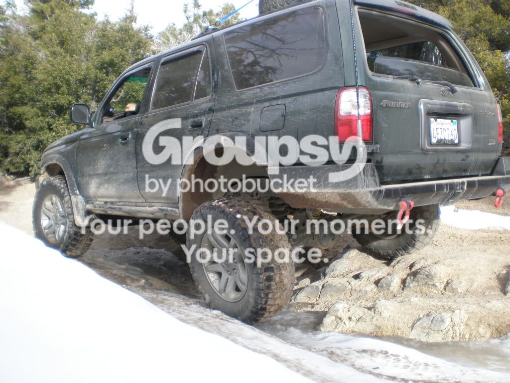

Later in the day:
P1010257.jpg~original
P1010258.jpg~original
P1010275.jpg~original
P1010267.jpg~original
P1010292.jpg~original
P1010313.jpg~original

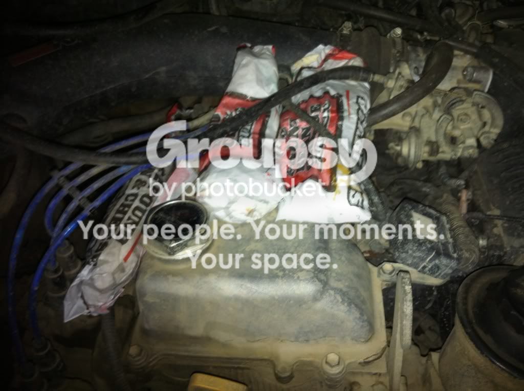

4Runners never came with the best of horns. They also aren't very loud. I replaced mine with some Fiamm/Bosch horns, OEM Mercedes-Benz. Here's a quick 9 second clip. They're easily twice as loud, perfect. The hole on the bracket to mount to the core support was too small, so Mr. Makita paid a visit. Also rewired the PA speaker.
<object height="315" width="560">
<embed src="http://www.youtube.com/v/2X1DAn1AhlU?version=3&hl=en_US" type="application/x-shockwave-flash" allowscriptaccess="always" allowfullscreen="true" height="315" width="560"></object>

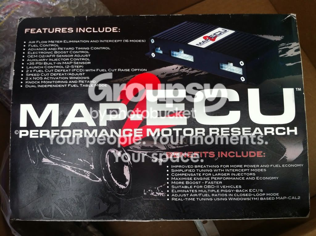

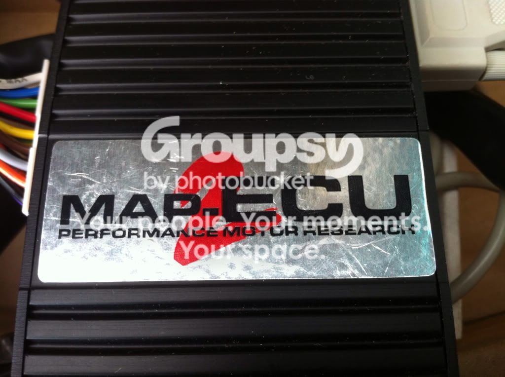

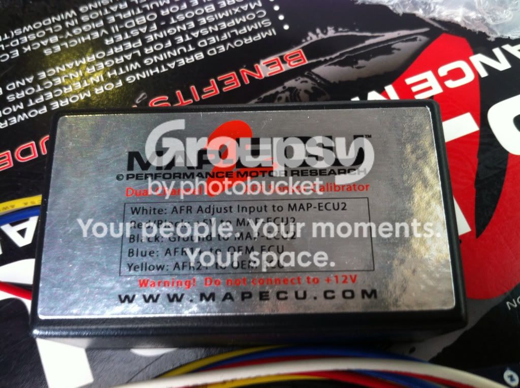

Last, but not least, I received my MAPECU2, AFR Calibration box, and 4 refurbished brown top 330cc (tested at 333cc) 1JZ-GTE Supra injectors. I've got an 8 PSI pulley already, just need to buy a Walbro 190 fuel pump and its boost time! I bought them from mosk, the same person who sold me the supercharger. Works out great when you can trust who you're buying from! Will post pics when I take them.
The MAPECU2 (Manifold Absolute Pressure Electronic Control Unit) is a major functional upgrade over the MAP-ECU, now offering a suite of features:
* Fuel control and Air Flow Meter replacement
* Timing control with +/-30 degrees adjustment. Full timing advance and re**** control of up to eight (8) channels for Distributor, Group Fire or Coil On Plug configurations using a 20 x 19 (380 zone) table.
* Two (2) complete sets of Fuel, Timing, Auxiliary Injector, O2 Adjust and EBC tables selectable using a dashboard mounted switch.
* OEM O2 Sensor Adjust 26 x 19 (494 zone) table allowing control over Air/Fuel ratios, even in Closed-loop mode.
* Auxiliary Injector control using a 20 x 19 (380 zone) table.
* Electronic Boost Control with ten (10) zones every 1000 RPM
* 0-10,000 RPM. 200 rpm increments 0-2000, 500 rpm increments 2000-10,000 for Fuel and O2 Adjust tables. 500 rpm increments 0-10,000 for Timing and Auxiliary Injector tables.
* Built-in MAP sensor, +35 PSI. Pressure scale is user configurable using a MAP-CAL.
* Frequency based Speed Cut Defender (SCD).
* Frequency based Speed Adjust
* Voltage based Fuel Cut Defender (FCD)
* Launch Control - Target RPM and Clutch Switch input.
* Two Complete (2) maps (Primary/Secondary) for Fuel, Timing, Auxiliary Injector, O2 Adjust & EBC - selectable using one of the configurable inputs.
* Support for optional external MAP sensor input.
* User selectable pressure scale configurations
* Plug compatible with current MAP-ECU harness.
* Three (3) multi-function high current switched outputs configurable as follows:
• NOS solenoid drive
• RPM>0
• Pressure Switch
• RPM Switch
• EBC
• Auxiliary Injector
* Upgradeable software stored in Flash memory that can be downloaded using MAP-CAL. Does not require removal of MAP-ECU2 from vehicle.
* More horsepower and torque by removal of the restrictive factory air meter and control over timing.
* The ability to use the stock ECM to control larger fuel injectors and/or performance upgrades.
* Alter OEM Air/Fuel ratios, even in Closed-Loop mode, for improved gas mileage or power.
* Retains the daily driveability of the stock ECM which is usually sacrificed with a full aftermarket engine management upgrade.
* Real-time tuning using Window™ based MAP-CAL2 software supplied with the unit.
* High-resolution 494 point Fuel table (0-10,000 RPM and -10 to +35 PSI) allows fine tuning for performance and driveability.
* Ability to run different fuels or performance levels using two (2) completely independent Fuel, Timing, O2 Adjust, Auxiliary Injector and Boost Control tables switchable on-the-fly.
* Built-in display and logging of key engine parameters such as RPM, Throttle Position, Boost Pressure, Airflow, Timing Adjust, Auxiliary Injector Duty, Boost Control Duty.
* On-board support for display and logging of popular aftermarket wideband Lambda sensors/controllers.
* On-board programmable NOS window activation switch can also be used to turn on other accessories at set RPM/PSI points.
* Faster and stronger boost with the on-board programmable Electronic Boost Control (EBC) using solenoid control of the wastegate.
* Fast and repeatable launches using the on-board programmable Launch Control.
* Removal of factory Fuel and Speed Cuts using the on-board programmable Fuel Cut Defender and Speed Cut Defender.
* Compensate for wheel size or gearing changes with the on-board programmable Speed Adjust.
* Drive a Shift Light or alter VTEC™ point with the on-board programmable RPM Switch.
* Single unit can be used for Naturally Aspirated or forced induction applications with user selectable pressure scale configuration.
* Simple upgrade from MAP-ECU using the same 16-Way harness and ability to import and convert V2.1 and V2.2 Fuel tables.
* Simple piggy-back installation only requires 7 wires to operate with no major re-wiring of OEM components.
The MAP-ECU2 kit includes: MAP-ECU2, Main 16-Way harness, 18-Way Timing Harness, PC CDROM software, 2 metre serial cable, Inlet Air Temp (IAT) sensor and manual in PDF format.

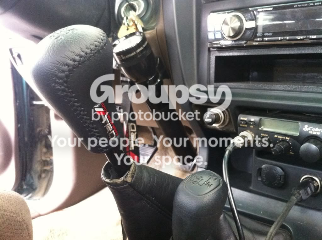

Items on order: TRD Shift Knob, leather. Walbro 190 fuel pump. SWR Meter (mine broke). Aftermarket vinyl shifter boot.

I ordered this over a month ago. Stupid USPS lost the first one, which sucks, because these are discontinued and very rare. Thanks to jdmpit on eBay, who sent me a free replacement. Feels and looks great. Still waiting on the new vinyl shift boot to replace the crappy worn/fading one.
f9a6fb0d.jpg~original
ab92bace.jpg~original
c0849d4d.jpg~original

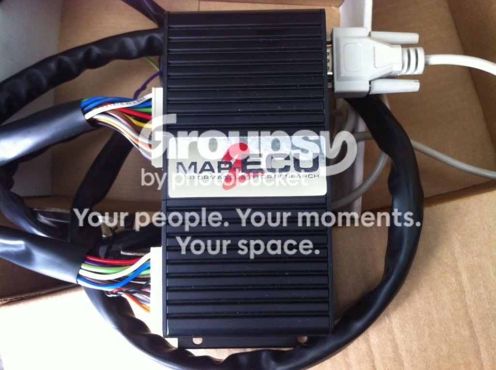

Here is the MAP ECU 2.
c86b5e68.jpg~original
dc4289fa.jpg~original
7cabcb91.jpg~original
Dual Channel AFR Calibration unit:

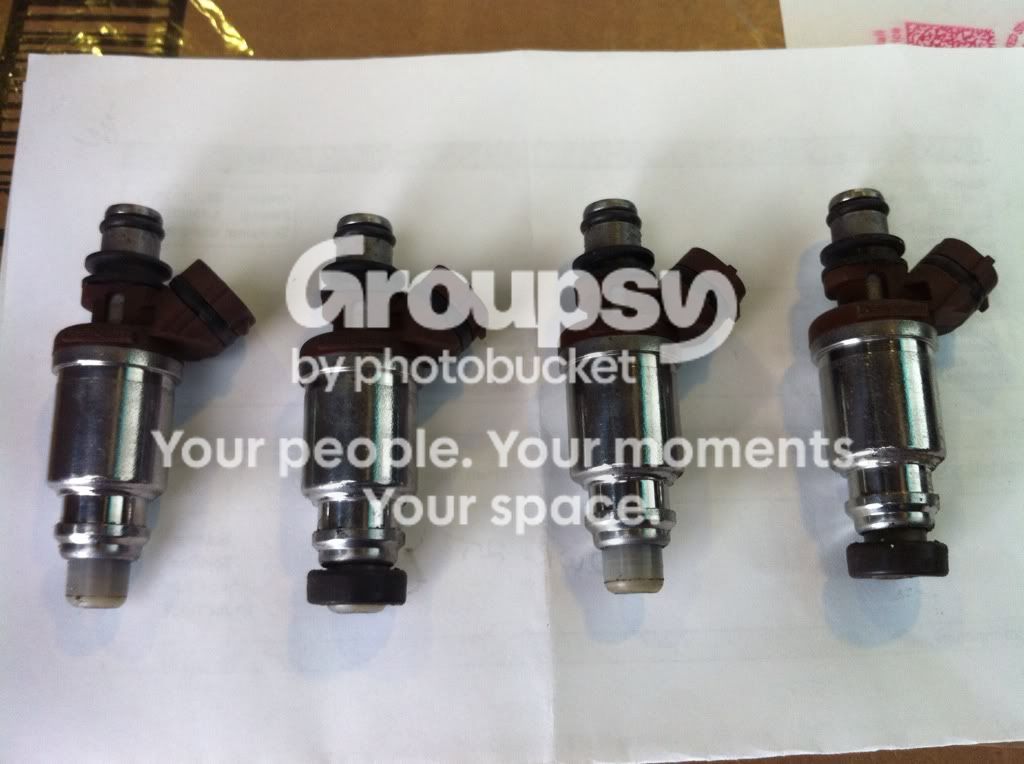

Brown top 330cc 1JZ-GTE Injectors (Toyota Part # 23250-46030)
126a66c5.jpg~original
Also, my workman SWR-2T SWR meter arrived. This is the same model SWR that I used before. Unfortunately, it was nonfunctional. I contacted the eBay seller to hopefully get a replacement. Bummer...
More goodies James!!!! Sweet additions man! Mines not a manual....but I added a shift nob for my 4WD shifter....spruces up the interior!
Out of curiosity, what's the purpose of the MAP-ECU? I mean, I can see what it does; are you buying it to work in conjunction with your S/C'd engine, or can one run one of these (and is there any benefit to running one) on an N/A engine?
Nice pictures and videos! I'm not sure if you are set on the BFG's, but here are some nice tires for sale. 4 kelly/goodyear all terrains and 1 bfg mud 285 70 17 - Tacoma World Forums
Thanks buddy. I'm very picky with my tires... I'll buy KM2s, Duratracs, BFG A/T... anything else I'd have to look into.
Thanks bud. I'll go look at the T-case knob now, I am thinking about getting one, too.
I'm still pretty new to this, myself. It's a piggyback computer. It pretty much tweaks the information sent to the stock ECU based on your tuning specifications. If you have any real engine modifications, this allows you to tune the computer to the best specifications for your current set up. They can be used on both naturally aspirated and forced induction engines.
A quick example for an N/A set up for you... LC Engineering makes performance camshafts that require an external computer to control. The stock ECU would not be able to compensate for the difference in timing. You can tune the MAPECU using a table to get your engine running correctly with the newly added part to optimize the performance output.
It can also be used to eliminate the MAF and use a different kind of sensor, add auxiliary fuel injectors (if you've heard of 5th and 7th injector kits, etc). A lot of racing applications use many aux. injectors, and this computer can control them. The list of features is as listed in the above post you saw.
My specific purpose for purchasing this computer is to run larger injectors. My stock fuel injectors don't have high enough flow to achieve 8 PSI of boost with the supercharger. I've bought 4 Supra injectors, shown above, that have the same plugs as the 3RZ injectors. Their added flow of about 20cc will render them useless with the stock ECU. The MAPECU gives you the ability to switch to larger injectors while controlling your air fuel ratio (as with the stock ECU, the air fuel ratio will be rich, too much fuel).
Yes, you can improve your stock N/A engine if you were to run MAF elimination. The installation, tuning, dyno tests, and cost of the unit would be too much to consider for the minimal gains with a stock motor. This unit is great for modified motors, with or without forced induction.

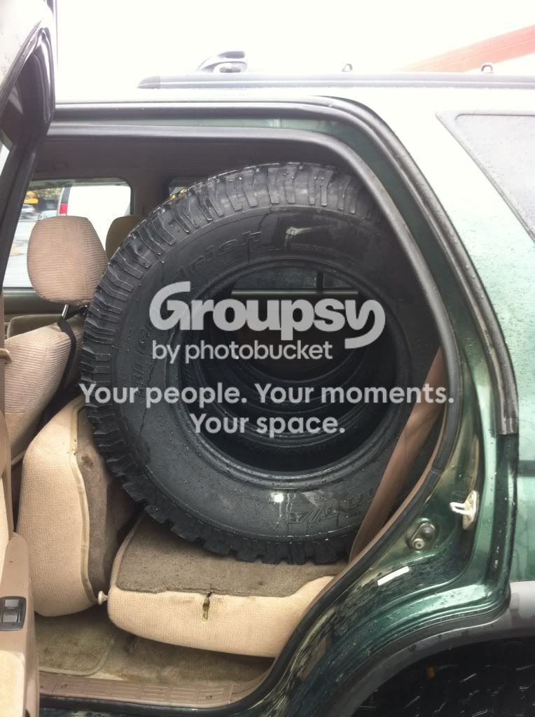

Oh yeah, new tires. 285/70/17 Load D.
a2b6f8c3.jpg~original

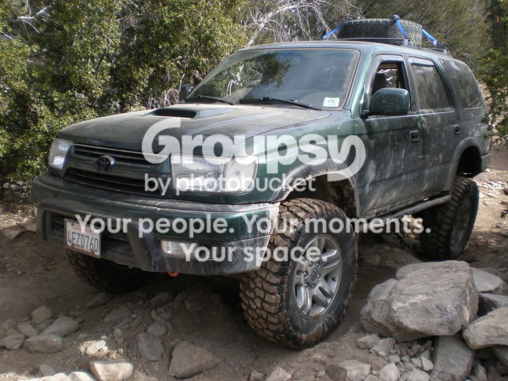

Went with the All-Terrain again. The KM2's were getting low since I bought them used.
I'm looking forward to better mileage and longer tread life. They perform great, like my old set did.

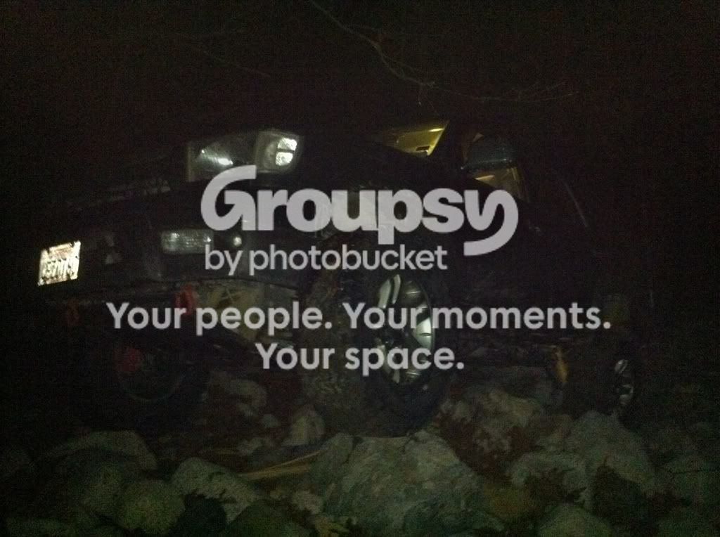

I drove up a rocky stream with them and no issues. No good pics, it was dark.
55739dbb.jpg~original

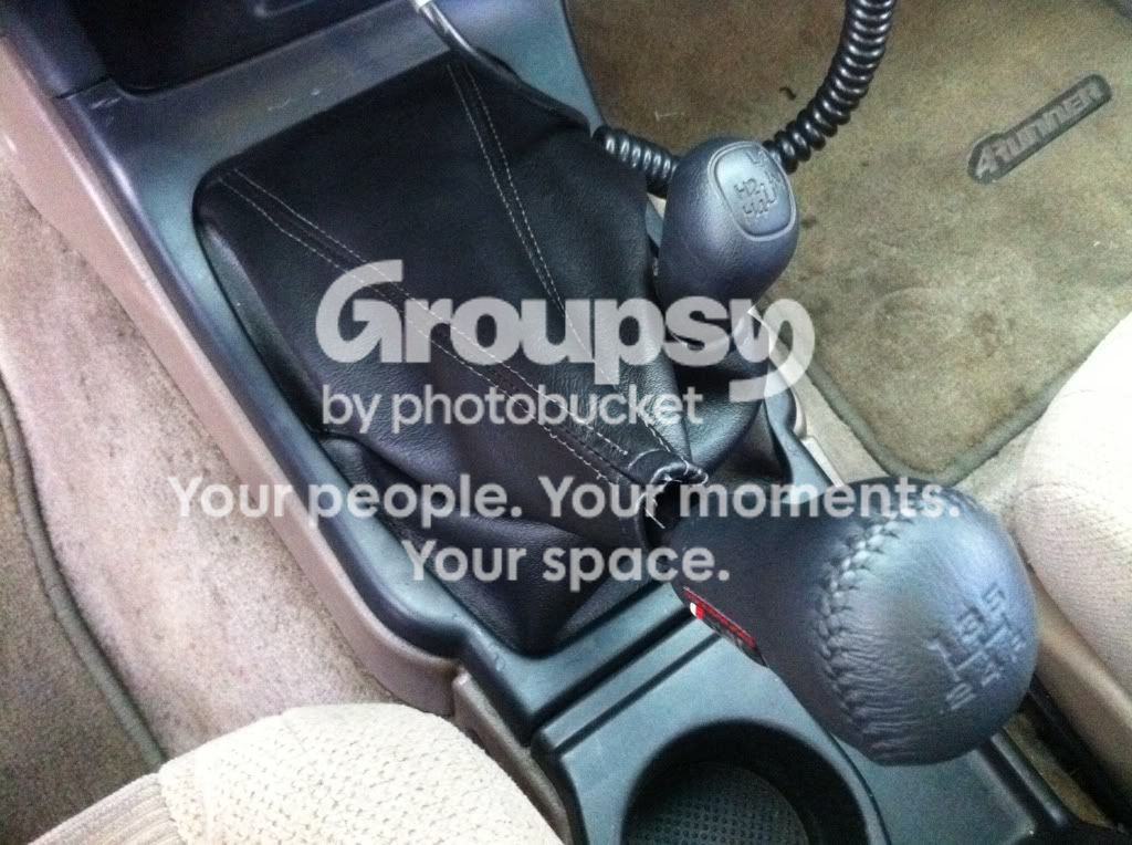

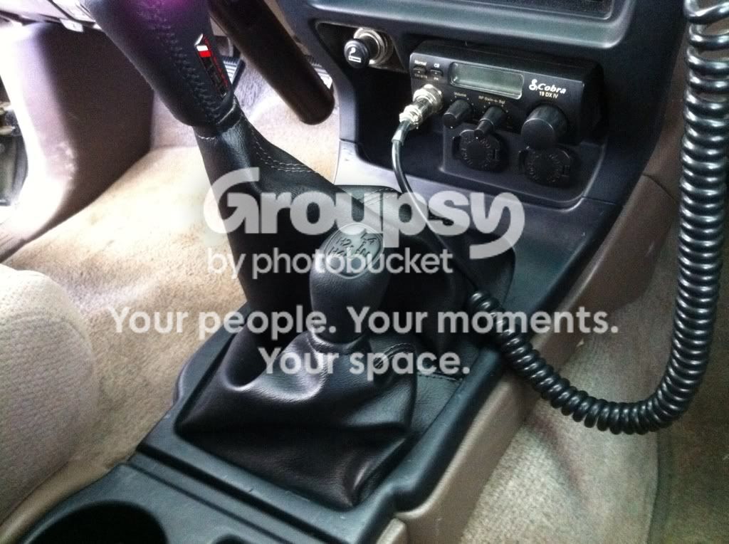

eBay shifter boot... not bad.
479e79a3.jpg~original
f48332f3.jpg~original
0670fd75.jpg~original

Tuned my CB antenna, SWR of 1.1 so far (tuned on Ch13, all of my friends have CB's and this is the channel we use locally)
