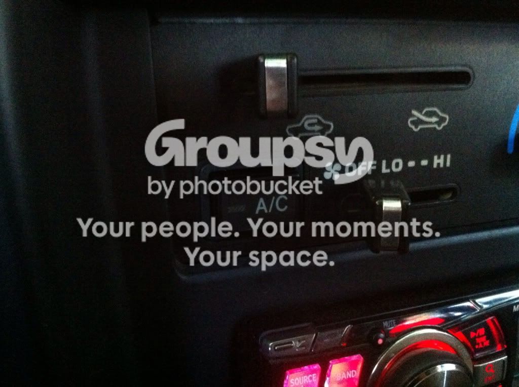

Was out wheeling 2 nights ago, when the strangest thing broke... my A/C button. The front part just sorta fell out. Anyway, dipped the broken end in epoxy and stuck it back in, works as good as new. Glad I didn't have to go searching for another one, the donor's was busted.
1af3cd04.jpg~original

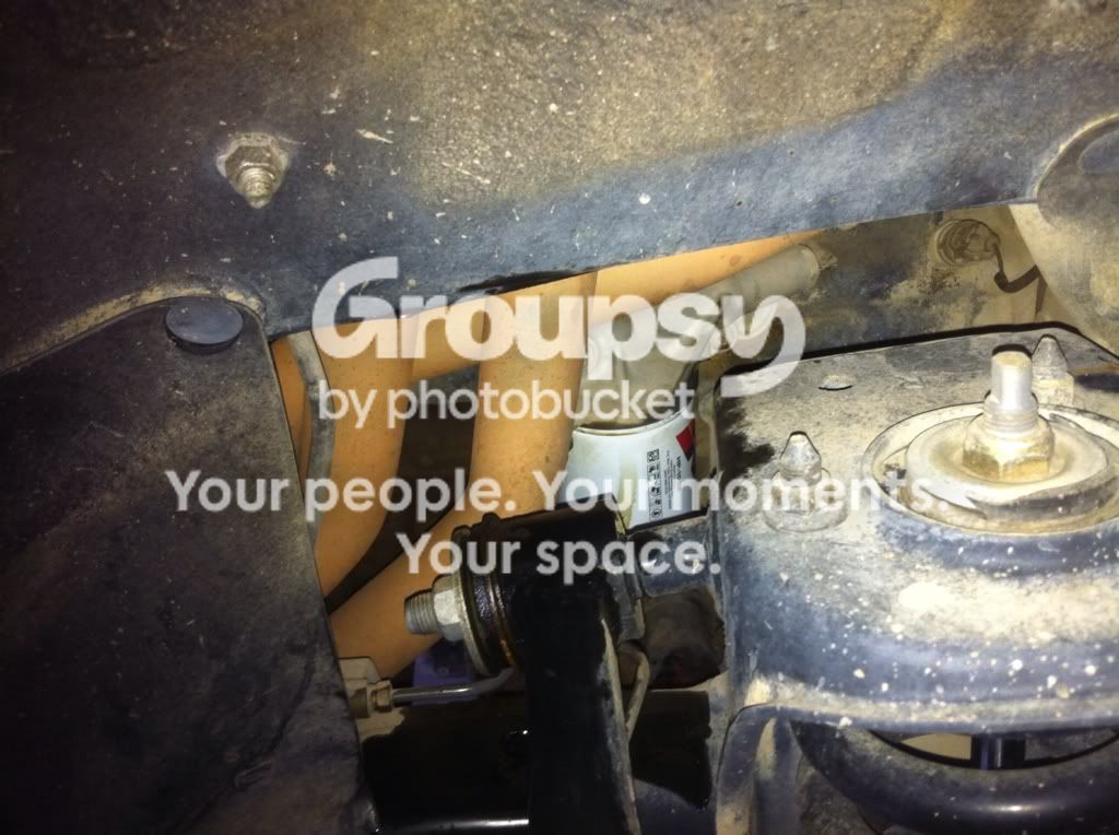

Also did an oil change. Back with 2WD, getting the oil filter was a breeze up through the lower control arm. It's a lot harder with CV's in the way. Finally found a suitable way through the wheel well, exactly like the V6's but on the passenger's side. Exhaust has to be cold though, very close proximity to the header. You know you own a 4Runner when you're cleaning the skid plates every oil change.

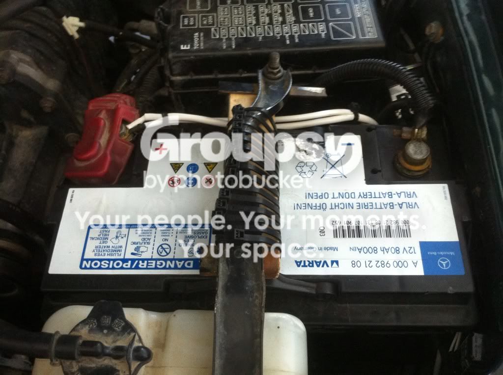

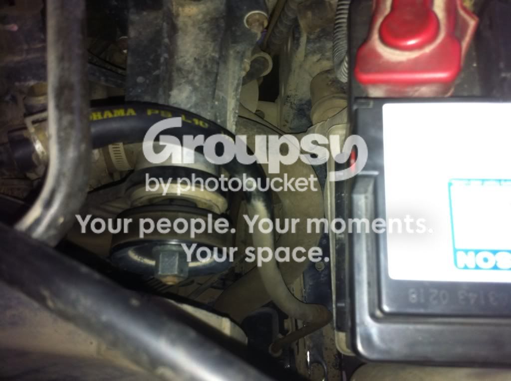

Been having battery mount problems. I changed batteries from the huge 850A Mercedes battery to a smaller one with 800A. The battery kept sliding, which would pinch power steering return line against the supercharger nose cone. I ziptied a piece of wood to the mount as a spacer, the battery mount is tight and hopefully it shouldn't move anymore.
d5cf2b6d.jpg~original
1ed070c8.jpg~original

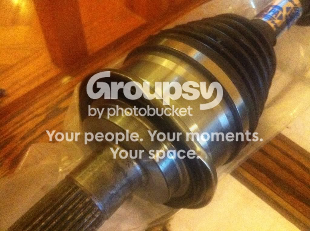

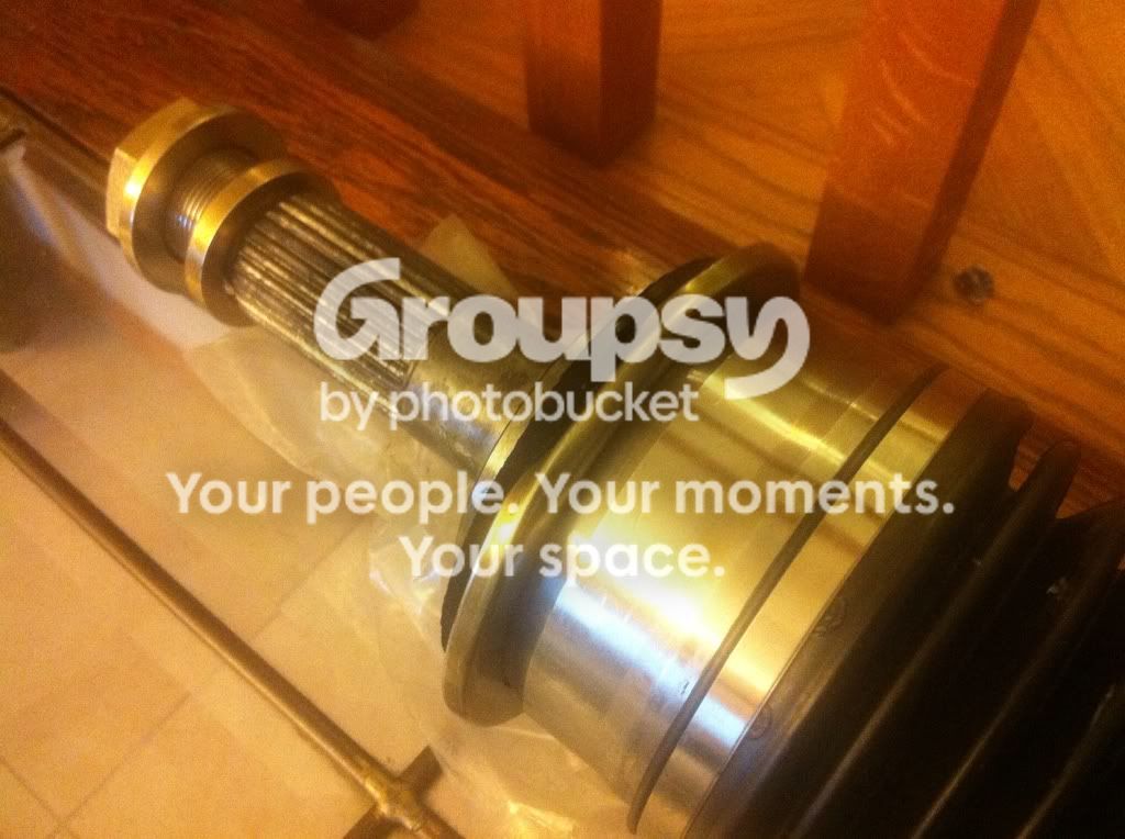

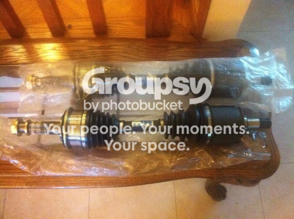

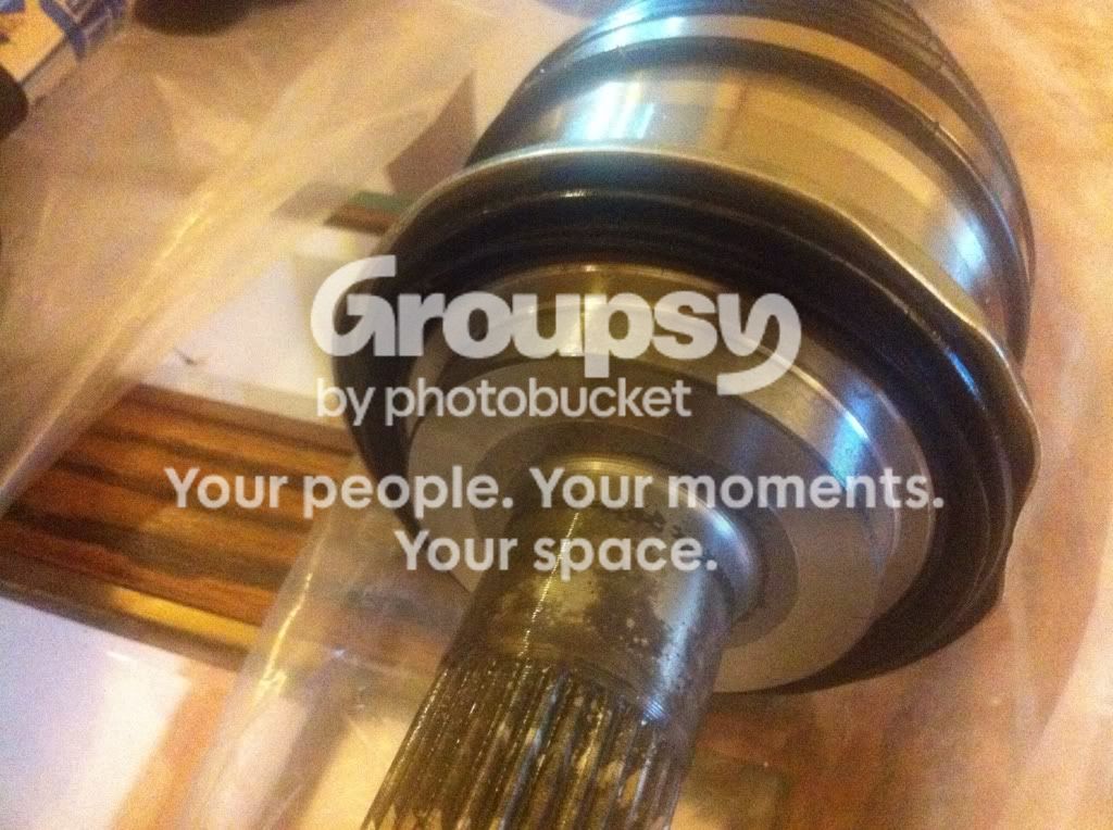

Found the NAPA CV axles at my door today. I chose NAPA axles because so many have expressed satisfaction with their good quality.
I paid $220 + $30 shipping. They shipped them in original boxes without any additional protection or packing material whatsoever. Literally smacked a sticker on them and sent them out. Both hub seals were bent in multiple spots. They appear repairable, though I don't wish to purchase brand new items only to have to repair them on arrival. Regardless, they are not in brand new condition.

I am pretty freaking pissed, sent this email to NAPA:
Hello,
I recently ordered 2 CV axles for my 1999 Toyota 4Runner. I received them today, Wednesday 8/1.
Unfortunately, both arrived in very damaged condition. Both axles were shipped in their original boxes without any additional packaging whatsoever. Both the axles and the boxes arrived in extremely poor condition. The hub seals of both axles are severely bent.
I was recommended to NAPA from a good friend for the good quality CV axles with neoprene boots. My 4Runner has been disassembled waiting for these to arrive. Now it must sit longer, waiting.
This sort of incident is ridiculous and I would expect much better performance from a company the size of NAPA. The level of dissatisfaction I've been left with is immense and I would like a very fast resolution. A good company would have gotten this simple order correct the first time and I would not have to deal with waiting longer to fix my vehicle.
I got reman cv's from NAPA about a month ago, and one of them was bent in the same spot. I just bent it back myself. But ya, I was thinking why on earth is this thing bent?? Let us know what they say
Easy, the middle man doesn't give a crap and tosses them around. Of course, that seal is the weakest link on there so it's the first to show any effects. I went to exchange one of my busted up advanced auto cv's and the one they had was the exact same way. Hell, the package was all busted up also. They had to order a new one and I got it the next day. Recommendation, every time you change out a cv axle, keep those seals. They come off easily with a hammer.

Interesting to know that you had similar experiences. Yeah, we shouldn't have to bend them back. I wonder if the new pair will be bent.
I hope they don't want these back, get me some spares.
Good to know. I'll be sure to keep the ones on my old axles.
Silly that companies don't seem to take any precaution when originally packaging these kinds of items.
I always get my parts at delivered to the parts store. Sure it takes a little more effort to go into the parts store, but I get to inspect my parts before I get them home and waste my time driving. O'Reilly's has a lot of parts available next day for these vehicles in Moog brand. I think they are quality parts and will run them on the front sway bar links soon. First I am going to take off the old one and have it in my hand when I pick up the part.
