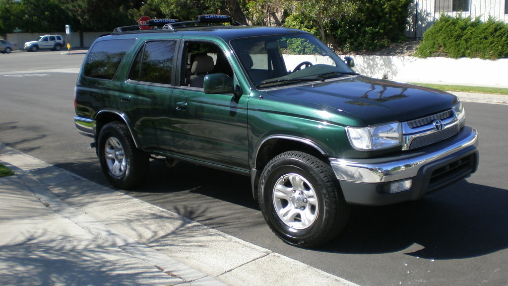

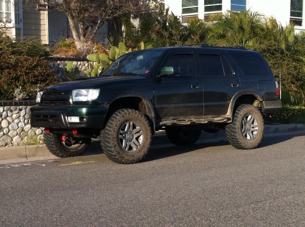

1999 Toyota 4Runner Base Model
2.7L 3RZ-FE 4 Cylinder
A340E 2WD Automatic Transmission
3.91 Final Drive Gears
Current:

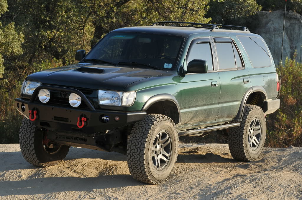

1999 Toyota 4Runner 4WD, SR5 Highlander lookalike
2.7L 3RZ-FE 4 Cylinder, TRD Supercharged @ 8 PSI
R150F 4WD Manual Transmission with J-Shifter transfer case
4.56 Final Drive Gears with Factory Electronic Differential Lock

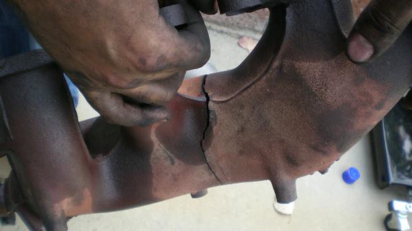

The very first thing that needed to be addressed was the exhaust manifold. At the age of 17, I saved for the first 5 months of 4Runner ownership to buy an LC Engineering 3RZ Street Header.

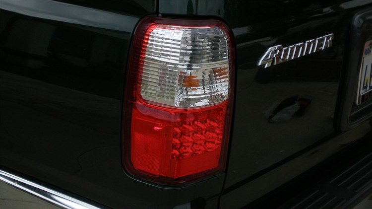

The SR5 look started coming together. This was about the time that the LED tail lights came out for 3rd gen 4Runners, so a set of OEM 2002 style replaced the ugly cloudy 1999 tail lights. I made a quick video of the tail light install with the same digital camera I always used. Also bought an SR5 emblem from eBay, though I installed it in the incorrect spot.
My LED Tails + How To Video

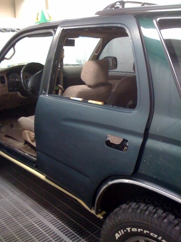

I bought my truck with a misaligned drivers door. The low corner outside tip of the door was bent also. The door and fender had definitely been in a fight or two.
The new 32" BFGs are much too big for the stock 2WD suspension... I took off the front wheels and hammered away at the pinch welds. One hit grazed the driver fender where the mudflap mounts, disrupting the delicate panel gap balance. Wheels back on, opening the drivers door immediately caved in the fender.

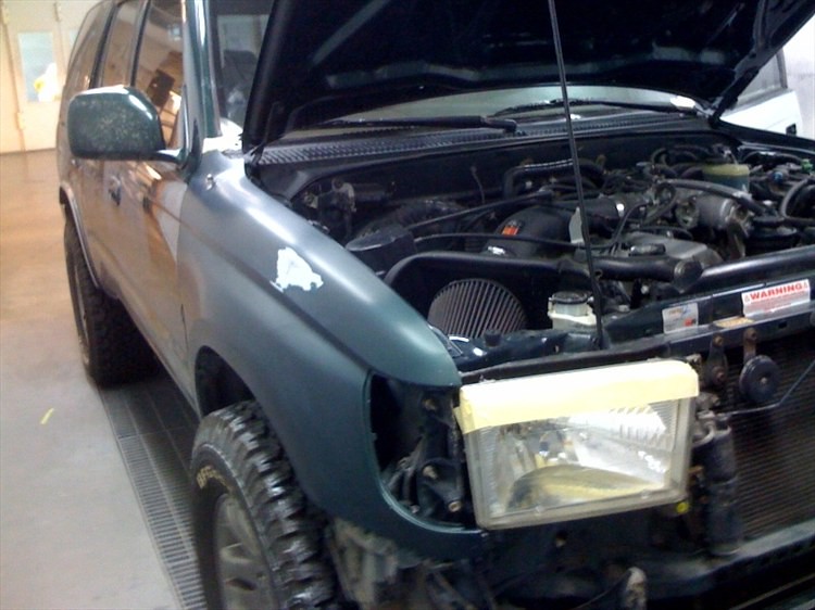

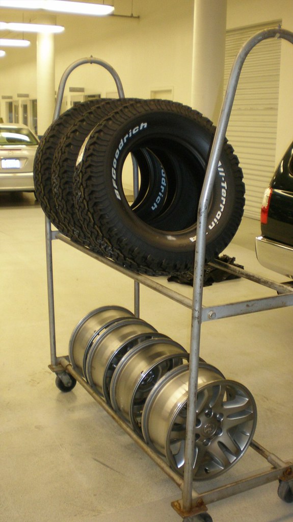

I work at a dealership, a few friends of mine were able to help me get some work done for a great price.

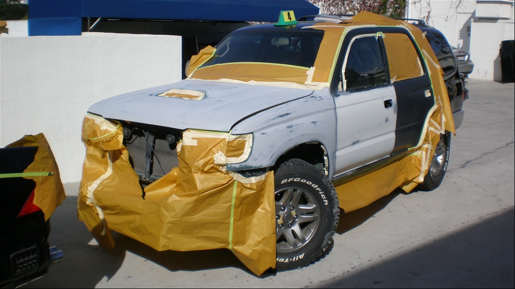

Since the fender has to be replaced, the paint will have to be blended into the adjacent panels, such as the hood and rear left door.

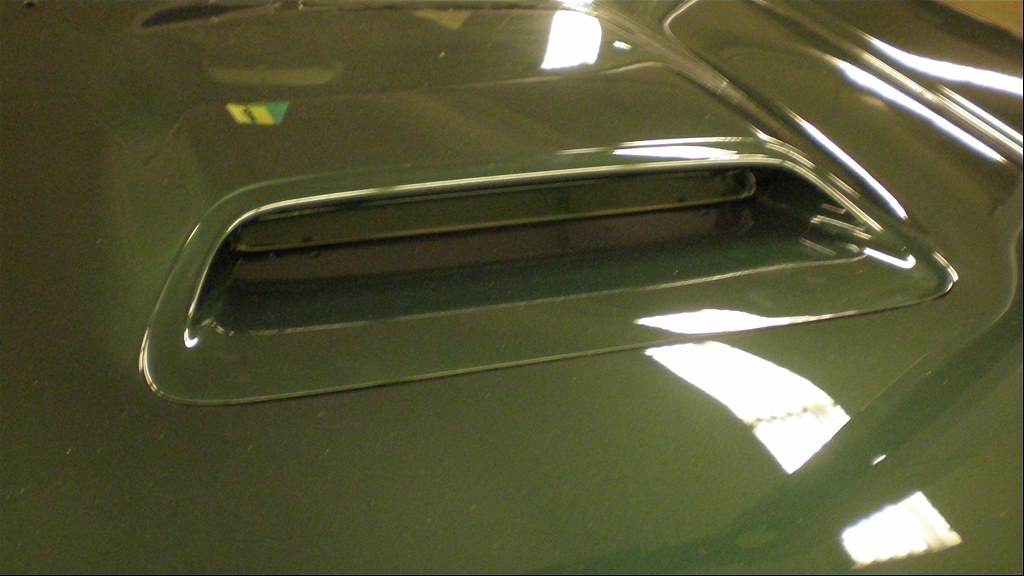

Certifit sells a sport hood without the scoop guts for $56! The scoop guts from Toyota were $175. Now that the hood needs to be fully painted, the passenger fender needs to be blended.

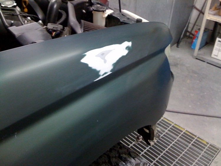

Basically, the blending process means sanding down to the base coat of the adjacent panels, lightly respraying over onto the edges of existing paint. The whole thing is all clear coated for an expected even blend, if you have a good match.
The passenger fender has some scratches that will disappear thanks to that, also getting the headlight filler panels repainted too.

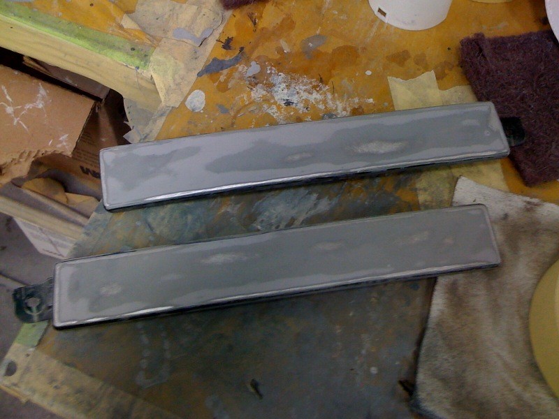

Filled in rock chips:
Sanded scratches:
Sanded Headlight filler plates:
Wetsanded:

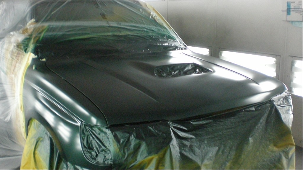

In the paint booth:
Base coat completed:
Baking at 113F
Clearcoat:

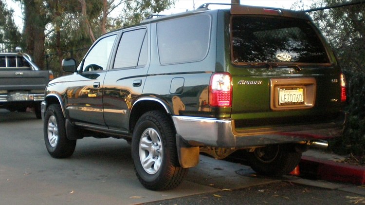

I slipped it past the tire guy after paint. He flipped the tires to black wall.
Going back together.
All done.

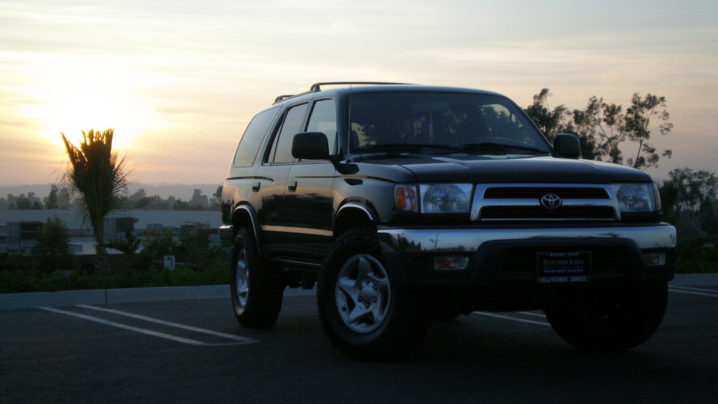

Aliso Beach:
Capo Beach:
Thank you, come again :D
