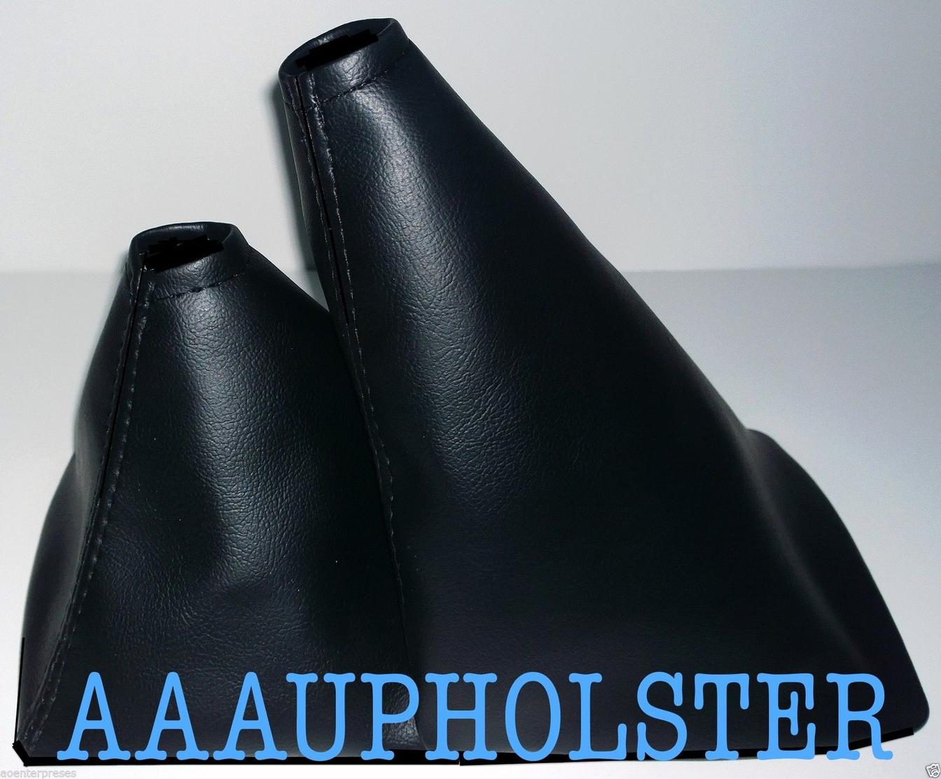

I've got a new leather shift boot on order, waiting to get it in. I'll get the shift surround and new console painted, then remove the rear heat blower motor to fit it all in. Still debating what I want for a shift knob.
