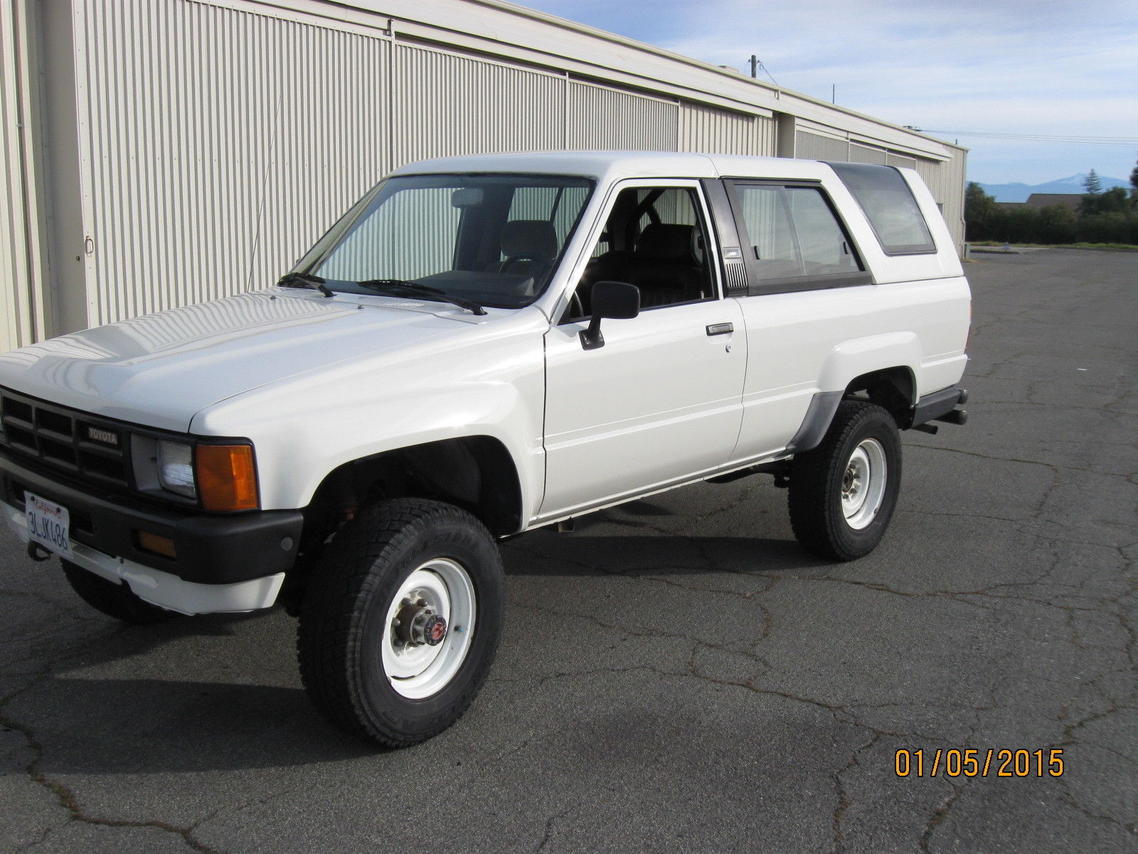

I've been obsessed with these trucks for a long time, and while endlessly searching first gen 4runners on google images I found this thread. I've read it TWICE (obsessed, like I said). I found an unmolested 85 4runner from Redding, CA a few weeks ago, and finally pulled the trigger. Can't wait to get it.
I have a few quick questions regarding the SEM Color Coat Landau Black that you used to paint the trim pieces. Did you also use their SEM plastic prep, or just clean each piece, and spray? Also, the two rear pieces over the rear wheel wells, do they just pop off, or did you paint them in place, just masking off the paint? Again, sick truck, and thanks for the inspiration.
