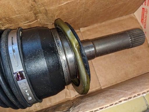

[MENTION=120071]mtbtim[/MENTION] what's the best way you've found to install the outer CV dust shield 90080-30028 on the CV axle?
Just gradually tap it in place with a brass drift or punch. It doesn't require much force to seat it onto the axle.
Today I learned that this is a replaceable part, which means I can salvage the CV I've been saving as a core rather than messing with a torn boot on another one.
Saved me a hundred bucks, thanks for that.
